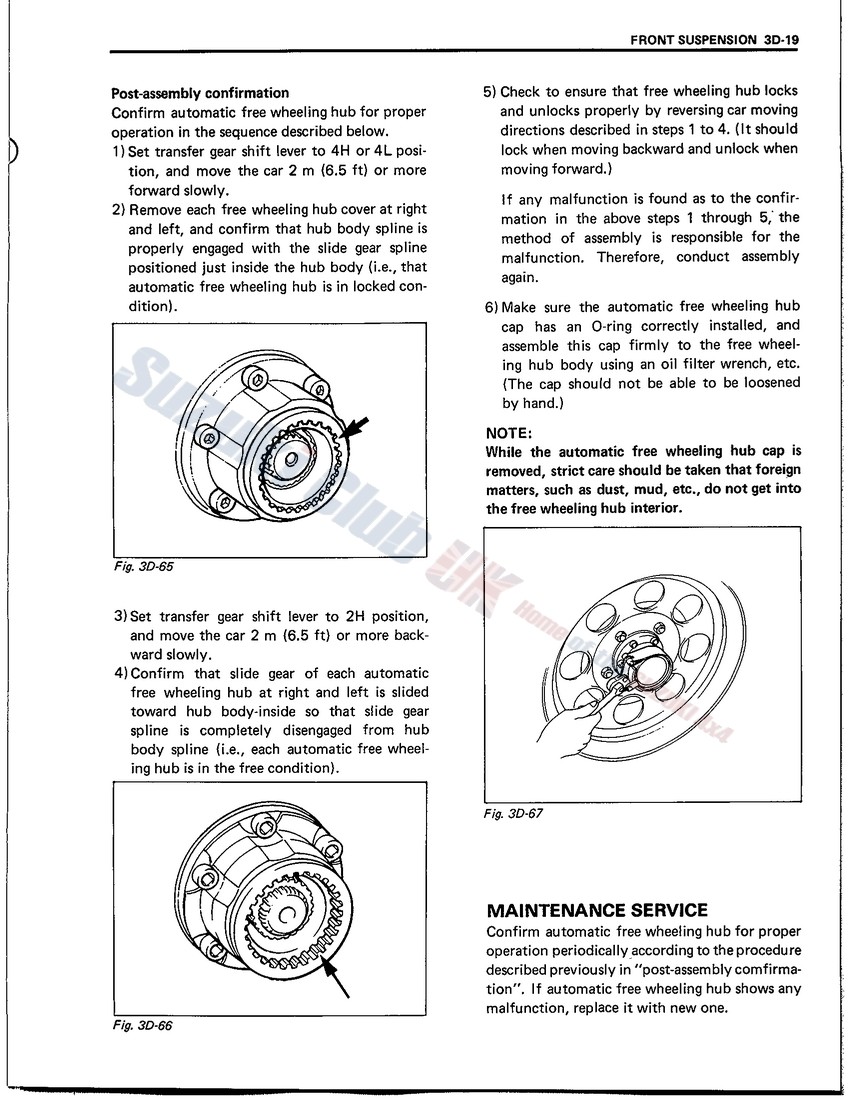

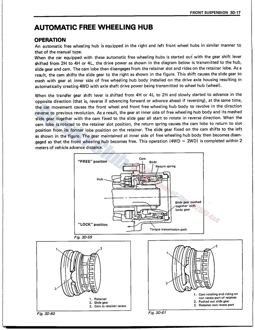

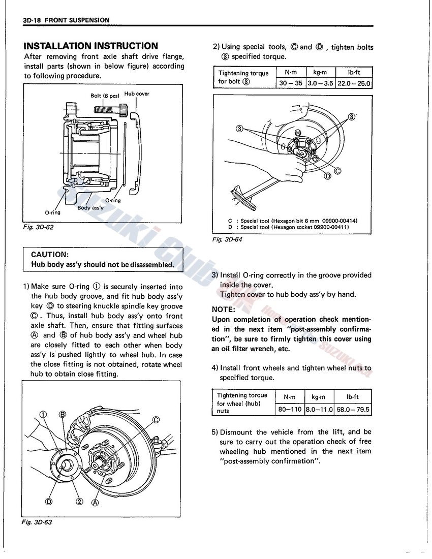

Re: auto free wheeling hubs ???????????????????
You've been fighting with those for months
Found a workshop manual since I last posted up some info on "Difflock".
Robbed the auto hub section
- Auto hub 3.jpg (248.67 KiB) Viewed 6551 times
- Auto hub 2.jpg (219.3 KiB) Viewed 6551 times
- Auto hub 1.jpg (249.49 KiB) Viewed 6551 times
