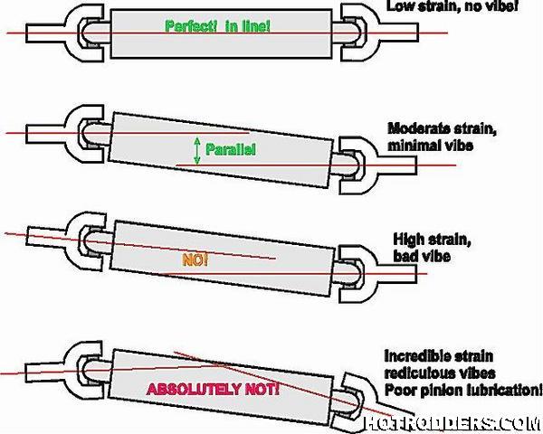

When welding the spring perches on did you make sure that you set the pinion flange angle correctly? It needs to be parallel with the Tbox output within 1-2degrees. Tilting it down 1-2degrees down can also help reduce vibes as there will be a tiny amount of axle wrap when under load I.e. driving and this will mean the flanges end up parallel while driving along. If the angles are out then the UJs will not be working together (in phase) and it will give you bad vibes and cause premature failure of the UJs.

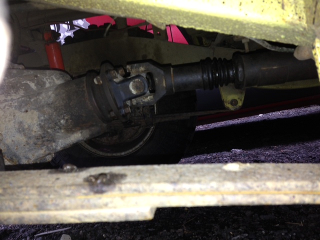

I have got the sammy props but the holes on the sammy ones are different to the centres of the flange on the transfer box so I used sammy back half that bolted to flange on sammy diff and 410 front that bolted to transfer box. As for prop angle ill take a pic and post it up. I would have thought its ok.

Looking at some of the angles ive seen people run probs i wouldn't of thought this is the problem????
Re: Prop question
Post by Edweird » Sun Jan 13, 2013 2:38 pm
There's so many things wrong in that picture!
The springs are knackered, that prop angle looks really bad. The axle looks like it's rotated and the T-box is too low.

Post by felstmiester » Sun Jan 13, 2013 2:52 pm
Edweird wrote:There's so many things wrong in that picture!
The springs are fine. I can kinda see where your coming from cos in the pic they do look quite flat but there not. they're actually rascal rears.
The transfer box is just in the standard possision not tha you can see that in the pic so not sure how you came to that conclusion.
The prop angle is the reason i posted up the pic but i have driven sj's and sammy's with spoa that are running ridiculous prop angles and they didn't do what mine is doing. The torque of the engine prob aint doing it no favours.

Post by Darrell » Sun Jan 13, 2013 3:51 pm
I'm afraid it looks like the last one :S
Pinion angle.jpg (44.78 KiB) Viewed 7377 times
Did you weld the new perches parallel with the original ones ???

Post by felstmiester » Sun Jan 13, 2013 3:57 pm
Ill take a pic the transfer box end as well yeah I make ya right it does look like the last one but only at one end. The transfer box end looks strait lol.
