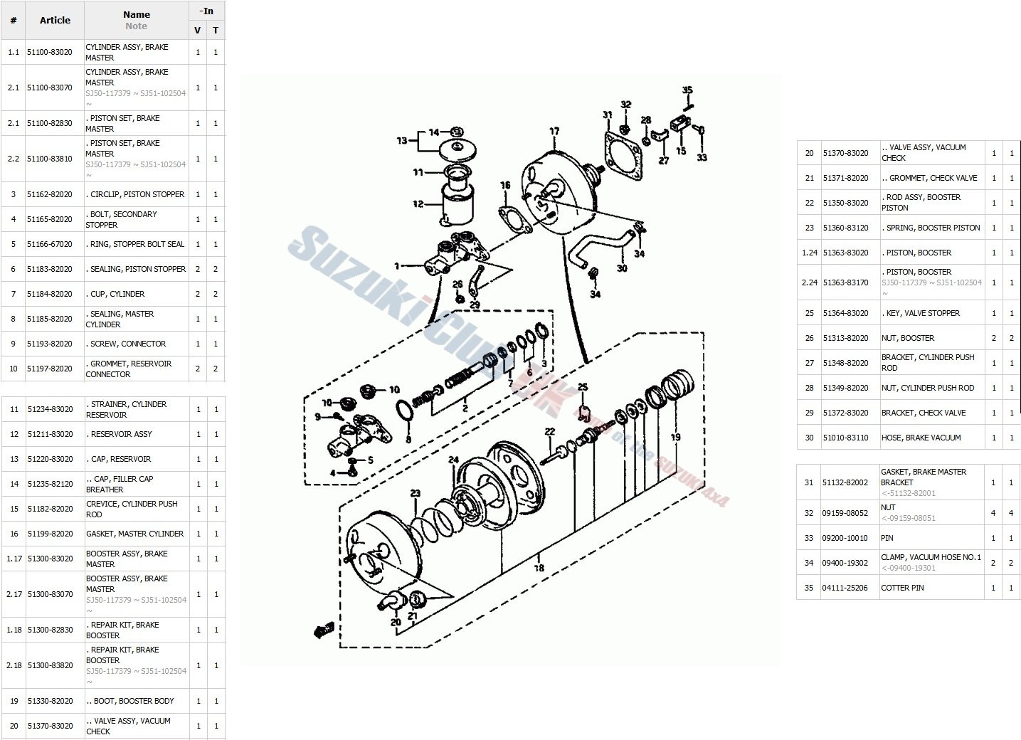

The repair kits I've found cost more than a complete unit from brakesint. I have read that they often leak from the reservoir grommets. I see you have the earlier type and here are the part numbers. I have no idea if suzuki still keep any parts for them.

Easiest option first as said in my build thread.
With in 5 minutes Stonacre had the exploded diagram on his computer. Two rubber grommets on the way.

The pic made it so easy to explain to my dealer which parts i wanted. Most parts are still available apparently. Some are individual others are kits.
