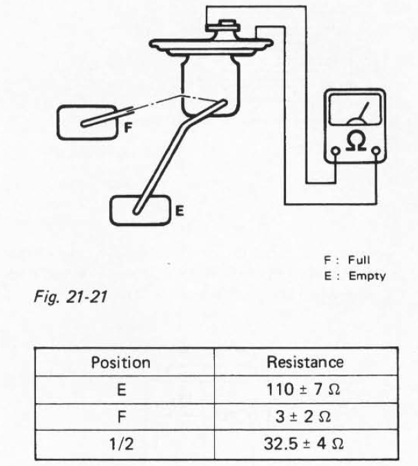

I can remember reading somewhere the values that the fuel sender should read at different levels. I took my fuel tank off, and was just checking the sender. these were my readings:
full: 6.5 ohms
half: 35 ohms
empty: 178 ohms
Is this alright? I was just wondering if any one has the right values, as I can't seem to find them :roll:

Both my 410 and 413 manual states these figures..........
sender resistances.jpg (71.18 KiB) Viewed 3091 times
You could just plug the sender back on the loom and see if it and the gauge match :thumbup:
Don't forget to earth the sender..unless you have a 3 wire type as one is earth.
I would think looking at your figures that it would be accurate enough :thumbup:
