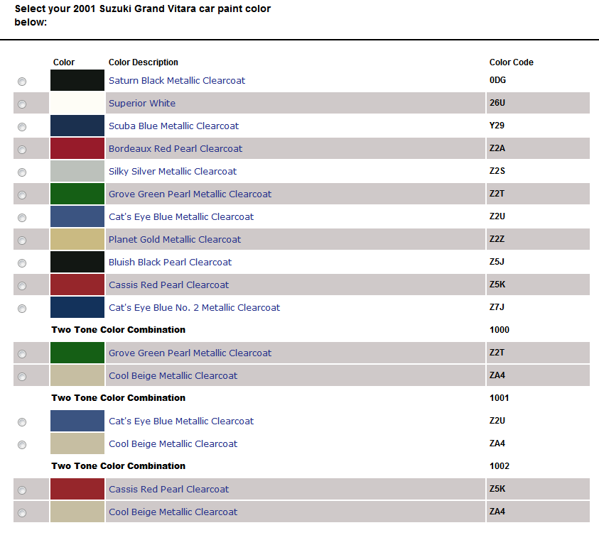

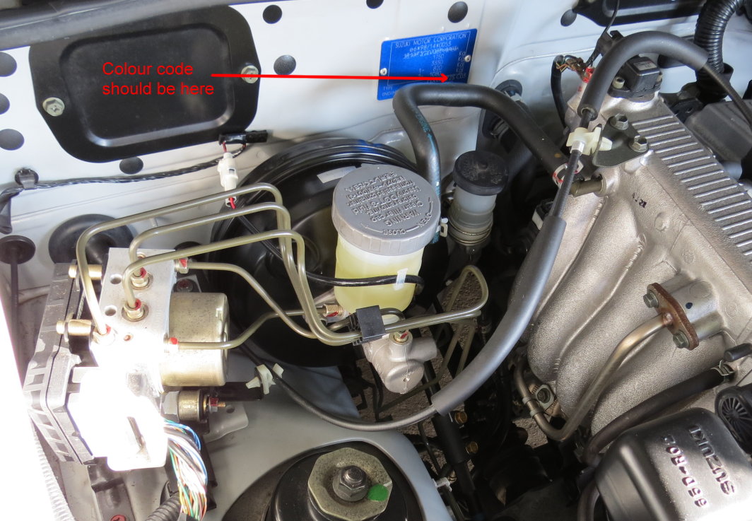

Hi All, i'm a newbie and hope you don't mind me signing up to asked a long winded question. I bought a 2001 Grand Vitara from a dealer. I paid probably over the odds at £2325 with 92000 on the clock but it was nice condition compared to others I looked at and had the 3 month dealers warranty. The gears are very notchy and the wife can't get them in at all so it's going back for checking out on Friday. Now my question, the car is black the dealer said it has bluey/black on the logbook but I have not received the new one yet to clarify. We did a check on the vehicle and it has not been resprayed, no crashes but it is blue on the check details. When looking under the bonnet everything is like a army greyish green colour. Is this usual with the Vitara to be a different colour to the main body?

Post by Darrell » Tue Sep 03, 2013 9:44 pm
Well I guess you have a Z5J one :thumbup:

Post by Darrell » Wed Sep 04, 2013 12:21 am
Code position

yar1950
Posts: 4
Joined: Tue Sep 03, 2013 7:27 pm
Re: body coulour?
Post by yar1950 » Wed Sep 04, 2013 9:15 am
Thanks for your help chaps, Derrell that looks like the color I have, I will check the code on the car later and let you know.
