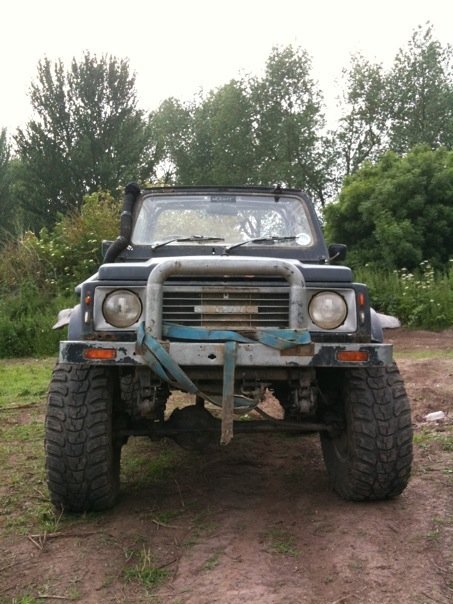

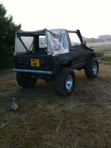

hey there people, i just this weekend bought a h reg sj413 im not sure of what work was done but its not standard i can see its spring over axle, and got chunky ass tyres on but apart from that im lost its my first 4x4! i bought it off a friend so i knew it was good fun off road as we used to go out in it but he wants a discovery to use for work and play instead of runnin two insurance policies!?

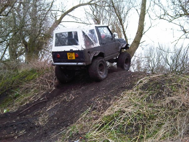

- sj beast!!.jpg (67.97 KiB) Viewed 9694 times
- this is me on my pride and joy!
- me on sj.jpg (65.6 KiB) Viewed 9693 times

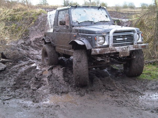

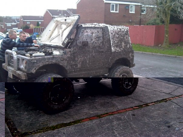

- sj n a mans best friend...... scrumpy!.jpg (50.79 KiB) Viewed 9680 times

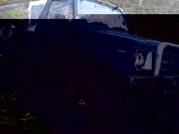

- muddy sj.jpg (66.34 KiB) Viewed 9682 times
- muddy sj1.jpg (86.06 KiB) Viewed 9683 times

Thats a big set of KL7s
I know the guy who used to have it, Mini big foot was its nick name (MBF) I will dig some details out about it.

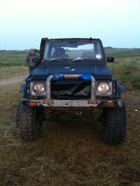

- what hill.jpg (112.35 KiB) Viewed 9673 times
- first mod!! the life saving spade!! haha
- sj with spade.jpg (50.96 KiB) Viewed 9672 times
- the engines here somewere.jpg (66.5 KiB) Viewed 9672 times
