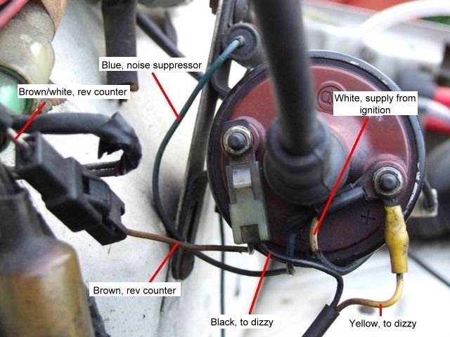

Post by Darrell » Thu Dec 08, 2011 8:19 pm
This is where the rev counter gauge gets it's info.........You can check this connection first and that black connection block....
To be honest though if it's stuck at 2000 it sound more like the gauge has had it :cry:
