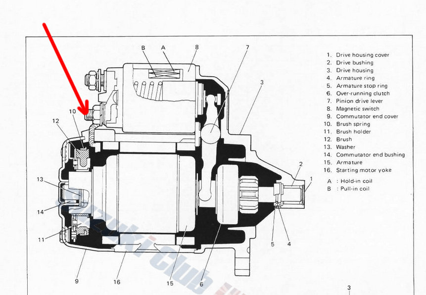

Just picked up my 1.6 engine and he gave me a skinny starter as he said it didn't work, done a bench test and the cog fly's out but doesn't spin round, is this a fixable issue?
Re: starter motor issues
If you put 12v positive on this terminal does the motor spin.
If not then the brushes are worn out or the windings damaged.
If it does then the solenoid is knacked, not the windings as it throws out the gear but the switch built into the rear of the solenoid.
You can get solenoids for some starters as I've just fitted a new one to mine. (fat type- 413)
If it needs a new solenoid post up some pics and any info plates and we can see if we can find one.
These skinny starters are hard to come by nowadays , so we really should try and fix them rather than find another

Just worked, tried it again and it worked fine, got me dad down to check and it didn't work, he went away and it worked again, think its just a bit intermittent !!

It's probably just dirty contacts in the solenoid, the high current ones. You can usually get them apart, but if can be a faf with un-soldering bits,but it's possible. Get it apart, clean up the bit lumps of copper and put it back together again. Sorted!timwilks13 wrote:Just worked, tried it again and it worked fine, got me dad down to check and it didn't work, he went away and it worked again, think its just a bit intermittent !!
