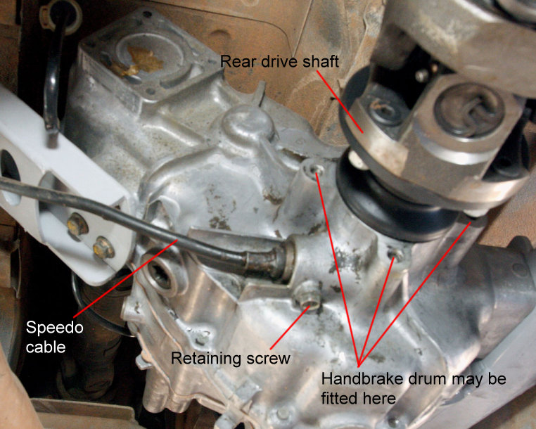

okay thanks sorted the wipers out now! just the speedo can someone help my locate where the speedo cable goes on the transfer box? iv seen by the transfer box lever there are to little connectors which go in to the tbox? or is the speedo a push fitted one i cant seem to find it becuase when i took the transfer box out i only had to unclip the to electrical connetors? really stuck
Re: Speedo and wiper motor
Post by Darrell » Mon Mar 10, 2014 11:56 pm
Speedo cable is held in by one bolt/screw.
Some have a brake drum fitted onto the output shaft, but I assume yours doesn't as you didn't have to disconnect the cable when you removed the box.
I guess your speedo cable is not connected/missing.
Transferbox case.jpg (135.29 KiB) Viewed 7316 times
On the diagram I put handbrake drum, but it should be handbrake backplate.
It's midnight and I can't be arsed to change it ;)
Post by Tramp » Tue Mar 11, 2014 12:07 am
That's a clean looking transfer box, and the whole underside is looking pretty good, I don't think mine has ever looked like that!
