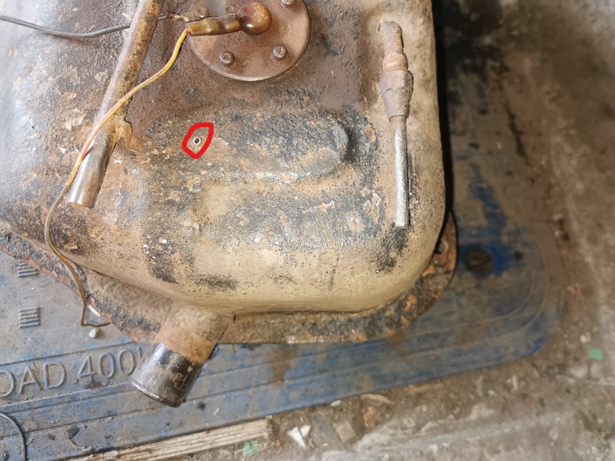

Got a used Fuel Tank, wired it up on the ground and sender works, so pleased about that,
BUT, there is a pipe snapped off on top circled in pic think its the return pipe, it is part of the tank, but is there a way I can attach another pipe or hose to connect to fuel line as on other tank??

I would of Mate but its different for some reason, the other one is like Defender they dont have screws it twists / locks in to place same as this one in pic,

One is a spanish tank.
The one in the photo with the snapped return is a japanese tank.

If the pipe stub is secure enough could you use a thread Tap to cut a thread inside the pipe stub and screw a pipe adaptor into it ?

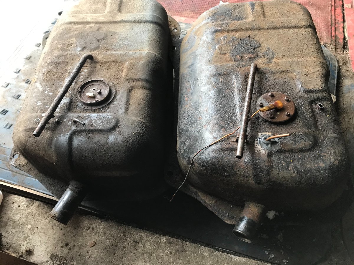

Just found that out Mate, Senders are different, someone has fitted a spanish tank at some point.
Found a Jap tank local, picking it up tomorrow , so will fit that assuming the sender is good , if not I know I have one good one to swap in.

Fitted another tank today and all good. Gauge working and no leaks.
Jordi is right My original was Spanish, my truck is Jap so someone must have fitted this tank at some point,
Tanks are the exact same shape but the Spanish has the feed pipe coming from Sender, the jap has it coming out from top of tank. so different senders.
Im glad I didnt order new one before I had seen it. Anyway for future reference.
In pic Left is Spanish, Right is Jap
