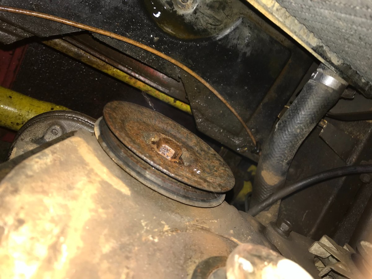

Cant find any info on how to loosen this bolt on bottom pully, it just keeps turning, Anyone know how to crack it loose ?
Re: SJ410 Pully
Post by Jordi » Fri Feb 19, 2021 6:48 pm
Stick it in gear. Get someone to put their foot on the brake and crack the nut.
border
Posts: 184
Re: SJ410 Pully
Post by border » Fri Feb 19, 2021 9:00 pm
Nice one Mate, wouldnt have thought of that, shows how thick I am :D but still gonna have a go tomorrow, better then paying £140 at garage.

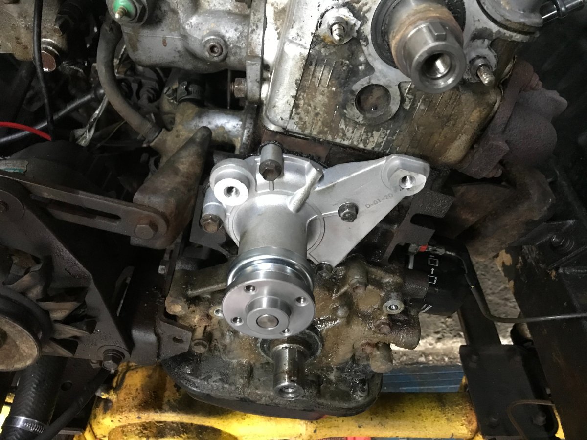

Post by border » Sat Feb 20, 2021 10:35 pm
Well I can now see why garage were going to charge 140 quid.
A lot longer and harder then I thought.
Got it done in a fashion anyway.
Didn't realise that I had to take both top and bottom cogs off to get to the water pump, thought I was going to get it without touching belt.
anyway got it done, only thing the new timing belt was wrong size, so refitted old one back on.
Filed back up with colent and Started up and ran great after warming up, thought it actually went a bit faster then usual.
Thanks for help Everyone.
Dont know why that pic is upside down, :er:
