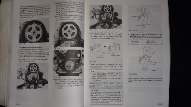

I am in process of changing water pump on sj410 1000 cc engine. as you know cam belt needs to be removed to get to water pump.
All went well coming apart.
How do i get correct tension on cam belt without correct tools. Do i just set it tight by feel and mid way between crank and cam pulley with a few mm of movement when pushed by hand ?
Also a follow up question. The tension seems fixed once bolted up tight, does this mean every year or 2 the tension needs re setting ?

I can only offer what the workshop manual says.....
http://www.mediafire.com/convkey/1d32/n ... x2tkzg.jpg

Thanks for the info.
I guess I could buy a cheap spring fish weighing scale thing and pull 3kg force and measure, or just guess by hand.
i live in italy, went to nearest suzuki dealer to ask about various seals and they said all behind cam belt back cover are no longer available. Shame as they all need changing really.
Will update with a pic when i decide how to do this tension thing. Any other opinions ?
Any thoughts on wether or not needs re tensioning every now and again ?

I went on not too loose and not too tight, just enough to give it some movement, but not masses, i think i've got around 5mm play
