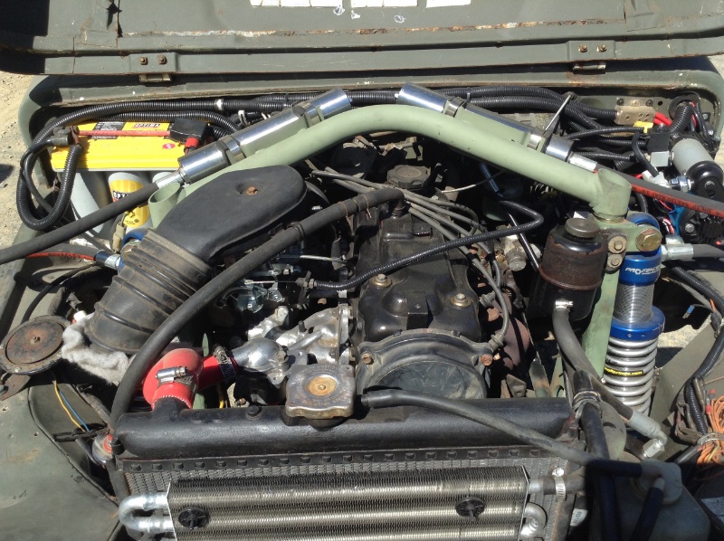

Oil Cooler ?
My LHD LJ160 spent 15 years in the South of Portugal as a farm work truck in blistering summer temperatures pulling tillers and carting 100s of kilos of fruit in the summer heat which is picking time.
It still has its 1300 rad from 20 years ago when it was built by Leigh, the same guy who built yours.
End of April it spent a long weekend rock crawling at Zuwharrie in North Carolina. 85-95F (hi 20s - low 30s C) I remember summers in the UK when your shoes would stick to the pavement but this heat when you combine it with the humidity is unbearable and just gets worse the further South you go. Why & how people live there is beyond me. With a 4.1:1 tcase & 5.1:1 diffs on 33 speed isn't it's forte so the air hardly rushes through the cooler & rad. Despite that the Temp gauge stayed in the middle all weekend long.
Complete oil cooler kit from Demon Tweeks.
Smaller oil filter to fit the sandwich plate & clear the chassis is from a Renault. Can't remember which. I spent ages at the motor factors opening boxes to see what would fit. I must change it as don't know how long it's been on the car. Same goes for the oil.

You said your engine was overheating, which I also experienced in my RHD UK LJ over 18 years ago, when Vitara parts were expensive. My "solution" in 1998 was to fit a later bigger core 1300 rad as I had no dosh then for a Vitara rad and it was a straight swap.
I didn't take any chances in 2001 when I bought my LHD LJ for the South of Portugal so I fitted the bolt on oil cooler as soon as I got the car. I thought: Cooler oil = cooler engine.
This being the "no dosh" build, my oil cooler "solution" was, at the time cheaper. It may be out of date now, compared to Vitara rad prices but I think it's still "cool". It certainly still keeps mine ... cool ? (Said in an Austin Powers/Dr. Evil way)
You say I "offered no solution" ? I think I offered 3 in 1. Both an easier bolt on & cheaper not to mention alternative solution to cutting up your car, seeing as the 1,300 rads work in Samurais with the 1,600 and even 2,000 & 2,300 engine conversions. The radiator does seem to be up to the job, if you get the right one with the larger cores. It's worked on all the other LJ160s Leigh's built.
I went as far as to point you and others reading this, in the direction for the hard to find substitute stubby Renault oil filter required to clear the chassis once the oil cooler's sandwich plate is fitted. Another "solution" for a "solution". I've lost count of so many solutions.
I even backed it up with my personal experience explaining how my engine has stayed and hopefully continues to stays cool in much hotter climates under heavy load and has remained reliable so hopefully you could see my "solution" should be more than capable in the UK which is actually cooler than the other 2 climates mine has experienced. I just stated my factual experiences.
