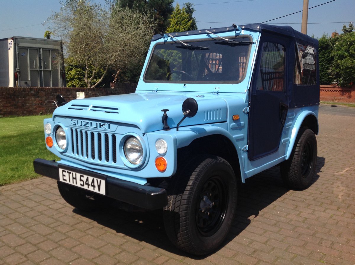

Re: Help !!!
Nope, it is not the olive green one, that is mine and may well handle really badly because it does have all the original steering etc. but until the motor is in and running I will not know.
I think the 'help' is needed for this one: which if it is, you can understand why you are being asked for help.
- ROBBIE
- Posts: 4552
- Location: Dorset or stuck
Re: Help !!!
That’s very nice and looking at the front hubs it totally standard. I’ve been told that they suffer really badly from bump steer, all to do with the steering arm setup. I’ve done a disc conversation on the front, using 410 parts, although it’s not finished There is a link to it somewhere, will have a look and post it up
