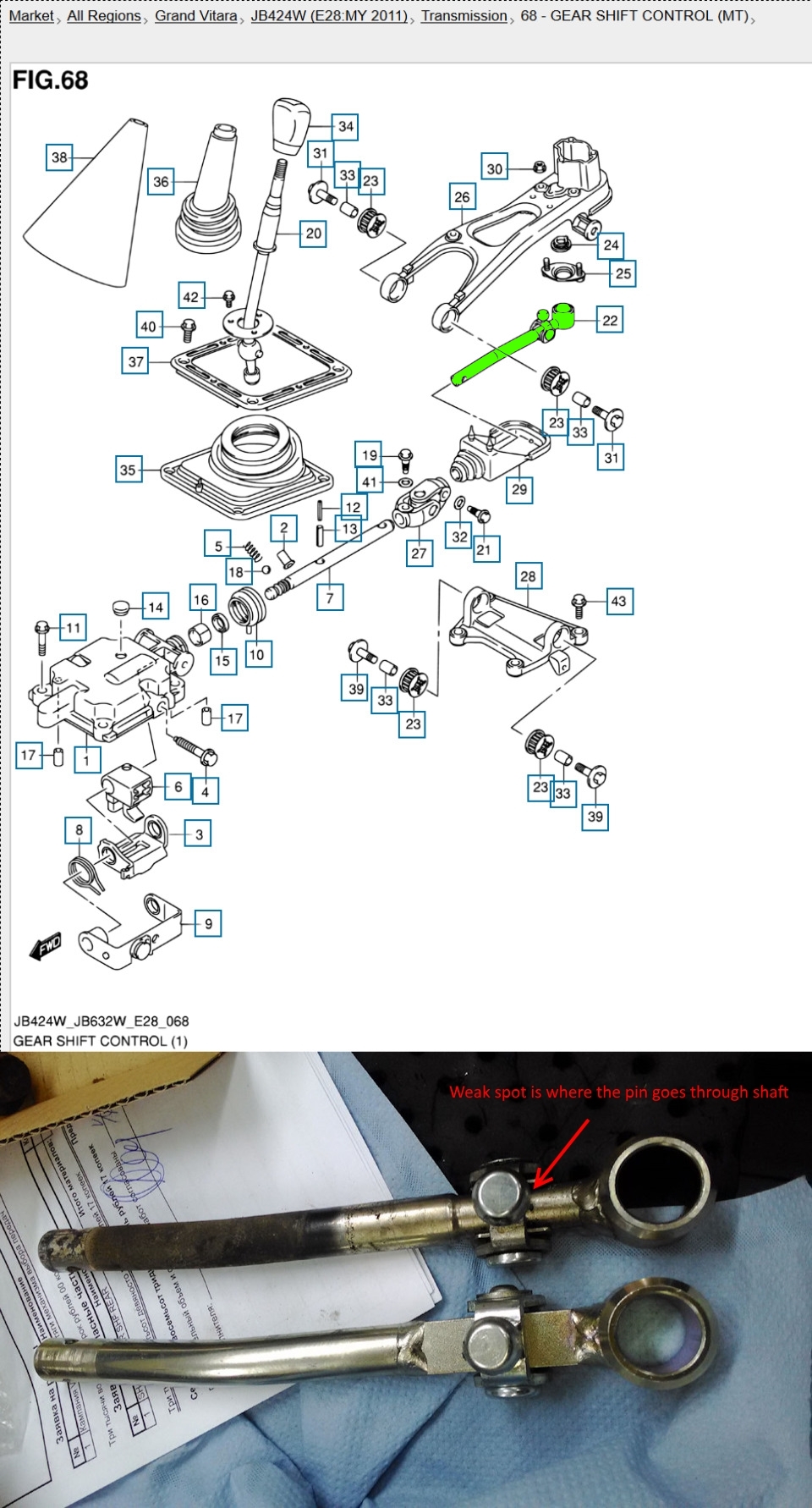

Had a letter in post about a recall on the Grand Vitara. Seems they want to change a link on the manual gearbox as a few have failed. Mine is a 2.4 Petrol - manual. Will be done at their cost. You never know the selector might end up being less of stirring a pudding to find a gear and more positive. Hey can't be any worse. ;)

The pic is what I've put together with my bit of research.
I believe wear on the plastic bush (24) is responsible for the sloppy gearstick.
Make sure the buggers put a new one in on reassembly :thumbup:

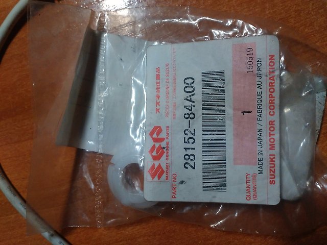

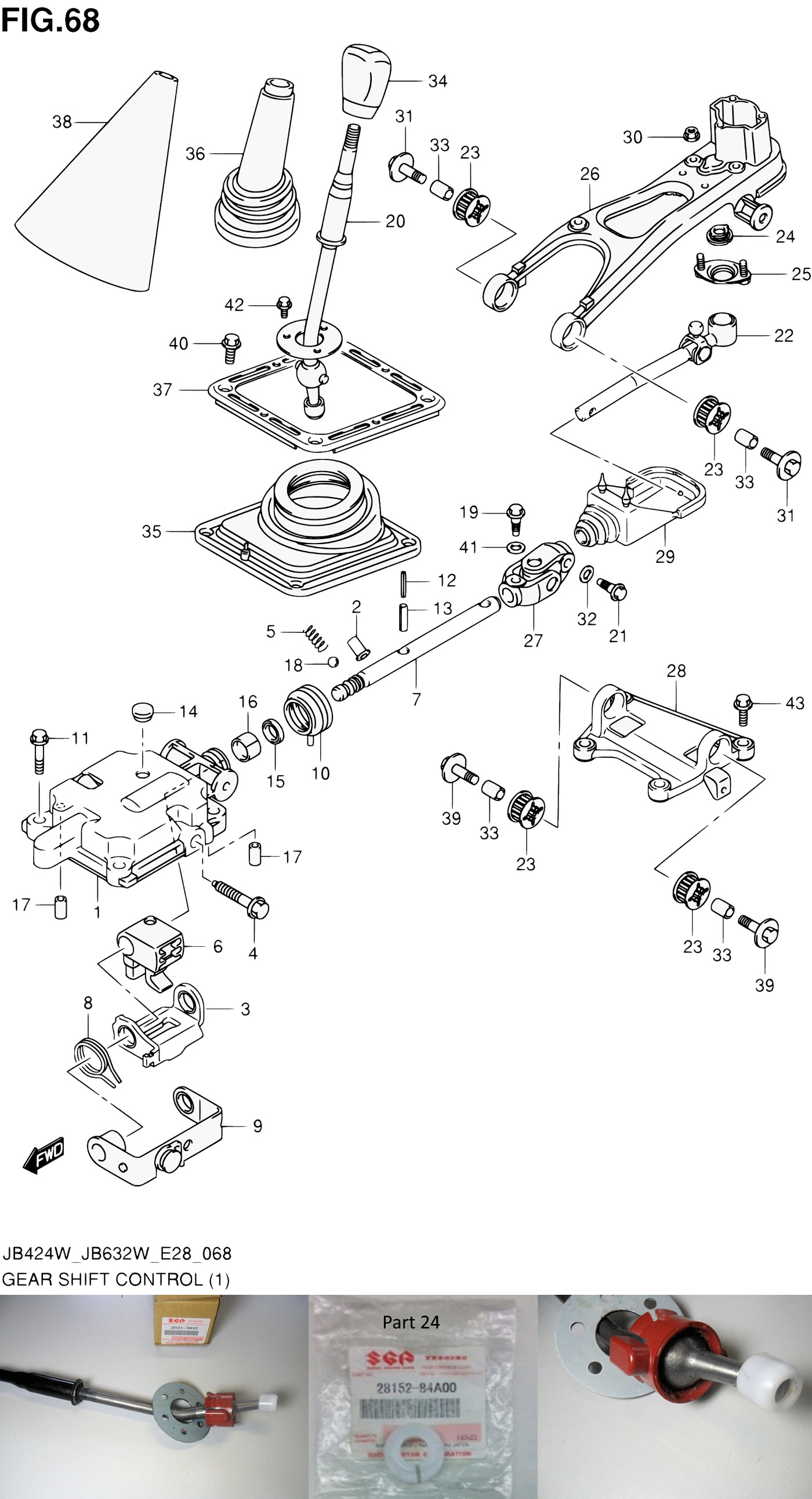

If your gear stick is really sloppy it could be either of the plastic bushes on the gear lever. Unfortunately these only come as a gear lever complete :S . Just a heads up in case they ring you saying you need this or that.

@Darrell. Thanks for all your info posted here. The redesigned link has now been fitted by the main dealer. The bush no 24 was not part of the recall but needed to be removed to fit the new link - had the bush replaced - cost £3.75 for the bush. Result is a less sloppy gear leaver.
