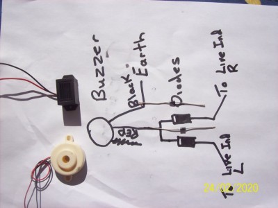

Hope that is enough info diodes have to go in the correct way silver/white stripe towards buzzer make sure buzzer makes a noise when connected to 12V. Think I have put a photo up but if it is not there will try again.

Many thanks WB,MOT next month so I will leave it until april and then have a look at the flasher relay.
