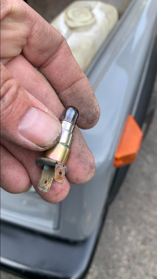

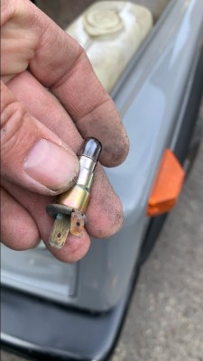

While I’m here, I’ve been going over the electrics of the SJ410 to make sure everything’s present, correct and working. I’ve found I’ve got an intermittent side light (the one in the headlamp) on the near side. It seems the bulb holder is just too old so the connection is intermittent. Does anyone know where I can buy these parts? There’s no part no on it- presumable an original Suzuki part from the 80’s

Think I’ve sourced the side light fittings for the headlamps. Found these on eBay after quite some searching - they look right so will see when they arrive if they fit.
BA9s Type Bulb Holder Dual Spade Terminals
Complete with Lucas Bulb OEM Reference LU 54573590, 554710, 170136

Post by ScottieJ » Sun Jun 07, 2020 6:29 pm
Those look correct.
Not a stock SJ part though, normally the side lights are down in the bumper and there's no sidelights in the headlight bowls. It's had aftermarket headlight bowls fitted.

Post by J9V6 » Sun Jun 07, 2020 11:12 pm
That makes sense - after market headlamps (maybe from a mini at a guess) - I’ve got side lights in the bumpers too. Always thought it was a bit weird having two sets. The headlamps are the ones it came with so must’ve been changed some way along the line. Anyway, that’s another mystery solved!
