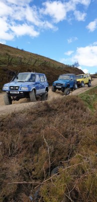

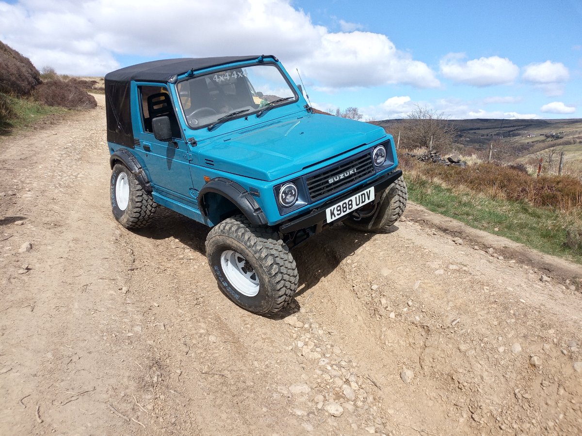

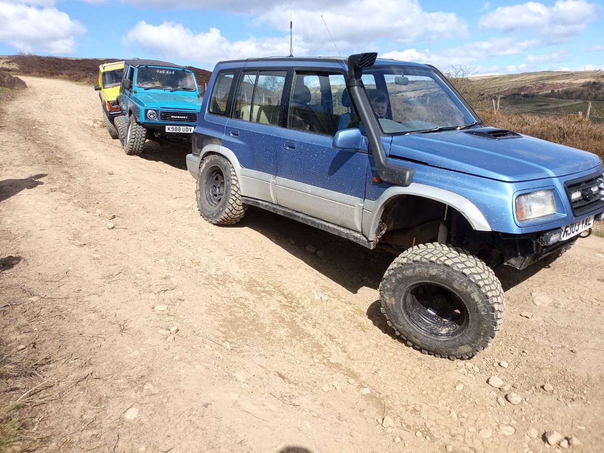

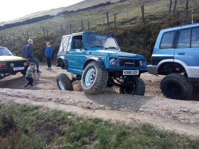

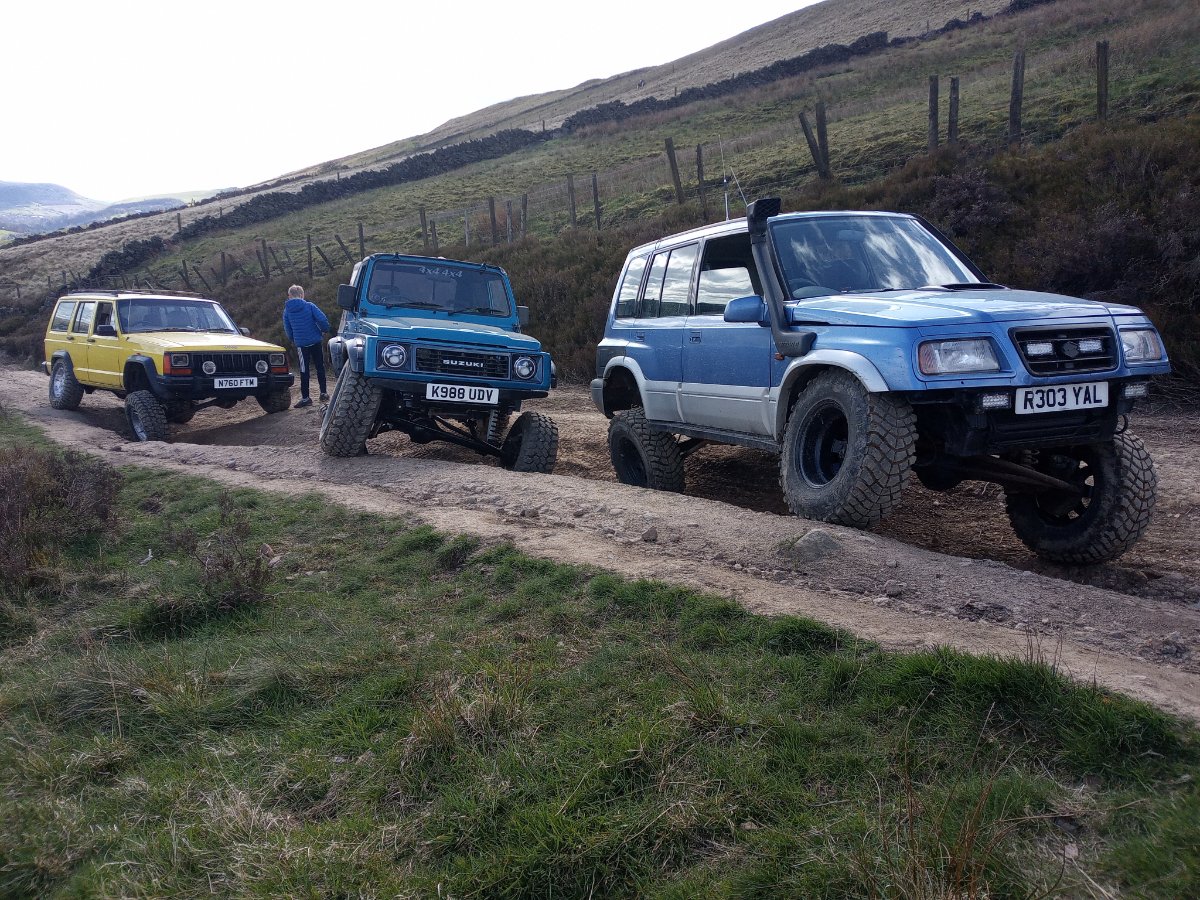

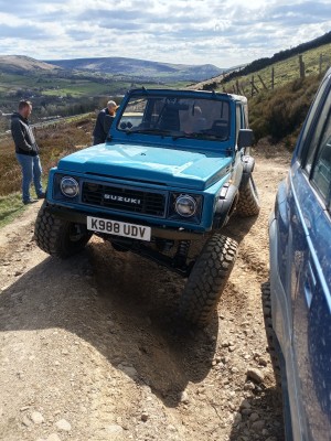

Today was the first offroad outing and excell it did. Its completely different to how a leaf sprung handles the offroad. I was a little concerned that on full flex it wouldnt have enough pressure on the ground to grip but i have a video showing otherwise! Couple of pics

Jordi - :hahaha: it used to be mine for a brief period last year. We had just taken the anti roll bar off to see if it could actually get anywhere, compared to my white sj its pityful, let alone the turqoise one!
