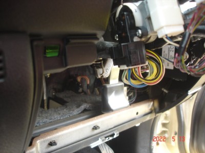

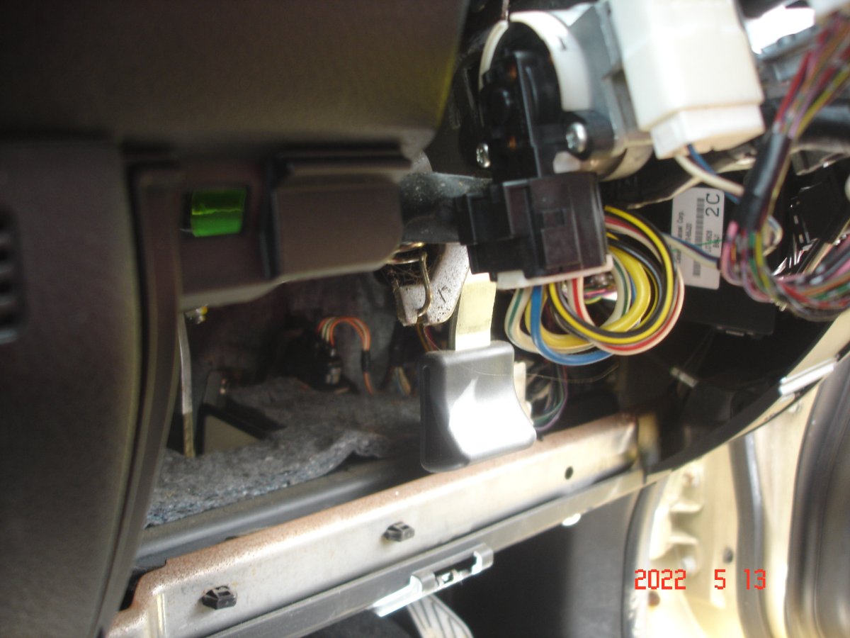

Post by suzukitomcat » Fri May 13, 2022 1:49 pm
Picture of Ignition Switch connection in & out.
