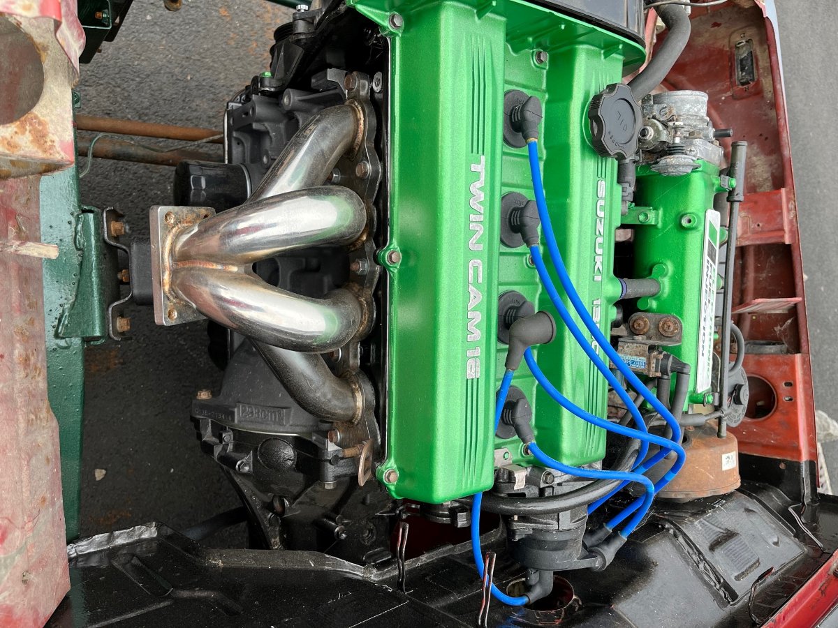

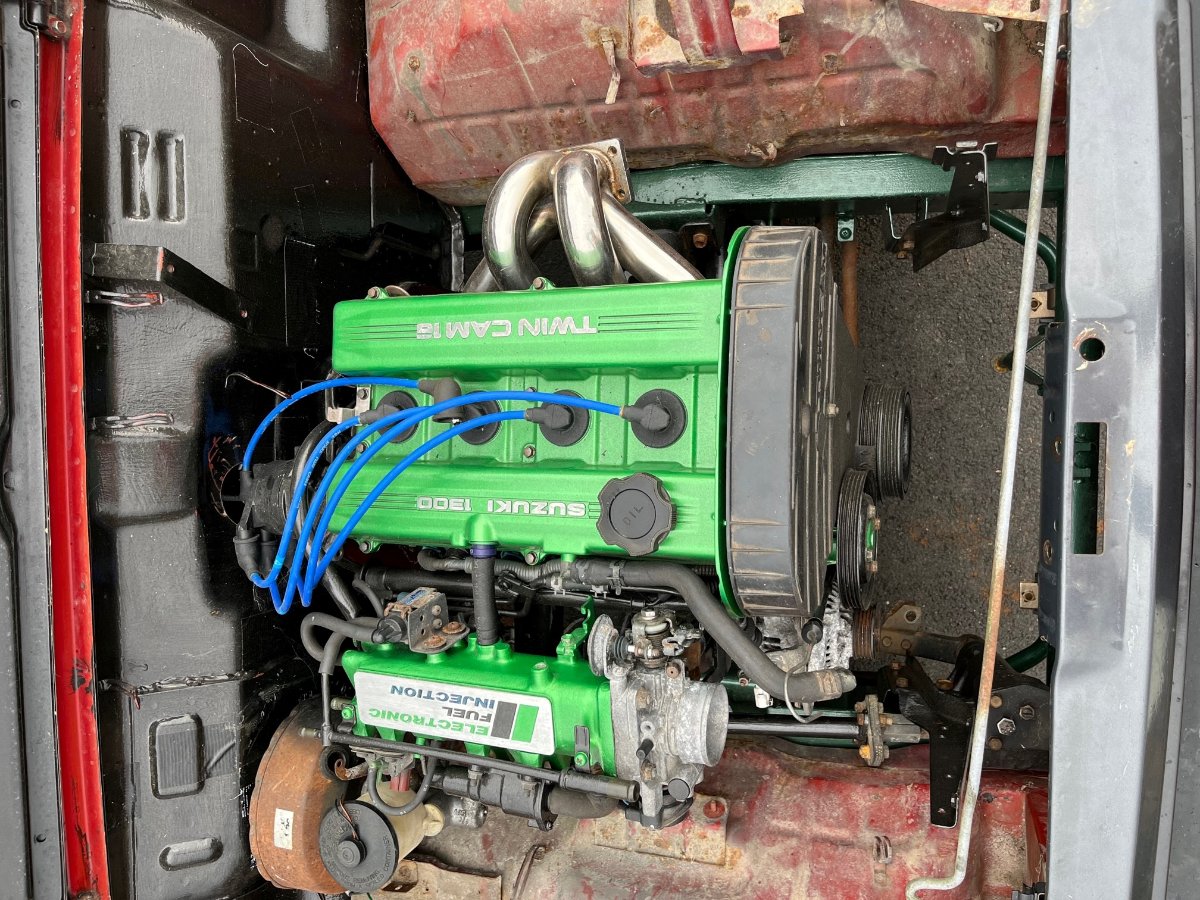

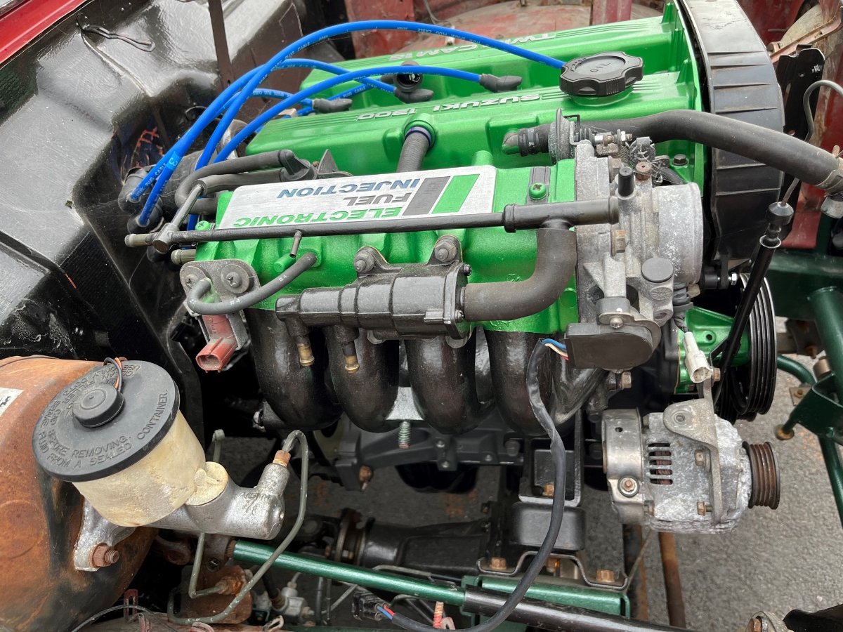

Just bought a part finished project SJ 413, which is halfway through the engine conversion. The Donor engine is a from a 1991 Suzuki Swift Mk 2, 1.3 DOHC Fuel Injected GTI Phase 1. Before I spiral into error after error and waste money is there anyone out there that can give me some advice. The pictures show the stage that it is at now, however, this will be a 50/50% road/X Country vehicle so needs an MOT.
Does anyone know anything about connecting the ECU and adapting the engine to run (pass emissions test) and give me:
the basic feedback through the Samurai dash (water temp, oil pressure,)?
does it need a Swift exhaust (I suspect it does) adapted or can the samurai fit and run?
Any advice on the above or anything I have missed would be gratefully received.

If you’ve got the loom and ECU for the engine then it shouldn’t be hard to get running.
Emissions shouldn’t really be an issue as it only needs to meet the original emissions, if the sj was originally carbed then an injection engine will easily pass those limits.
Water temp and oil pressure warning lights are simple to wire up. You could just use the wires from the original SJ body harness for those.
Yellow/black is oil pressure
Yellow / white is coolant temp but you need to make sure you have a sender that matches the sj clocks so one from the original engine (note Jap and Spanish wiring looms use different resistance senders so you need to make sure you get the one that matches the original vehicle)
You should easily be able to make an adapter to mate the swift manifold to a stock sj exhaust however it looks like your engine has a turbo exhaust manifold on so you would need to make a custom section to mate the two together.

So the only sensor in the exhaust will be a single lambda in a phase 1 gti loom I think. You can get weld in bungs for those so it’s pretty easy to add one.
You can get an injection sj tank with built in fuel pump on eBay for around £250 I think, or you can just run the stock tank with an inline high pressure fuel pump. You will need to upgrade the feed pipe to 8mm id and return to 6mm return (can just turn the original feed into a return)
The dash oil pressure, coolant temp and alt warning lights are not linked to the ecu loom at all on these engines.
You will need an original coolant temp sender to match the clocks in your car. So one from the original sj engine (not the swift engine)
I’ll ask a few mates that are into their swift gtis if anyone has a phase 1 loom lying around as that would save you a bit of work.
