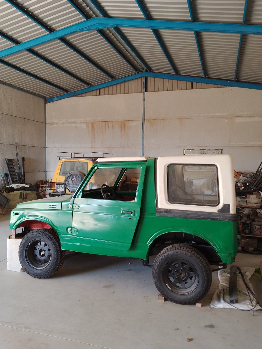

Post by Toodlepip » Sat Oct 07, 2023 8:38 pm
So this is how she is currently, and has been since this April if I'm honest due to a busy old summer. The chassis is 95% built, slight issue with the left hand axle shaft at the moment. Seats are 'offered in' but not fixed in place as I'm still working on the wiring loom/dashboard area. Also the bonnet and wings are just slaved into place for alignment purposes and ensuring the correct size fasteners go in the correct place. Engine and gearbox are currently on the bench awaiting my e making space so I can strip and overhaul them. I'll attempt to post updates more often instead of en masse!
