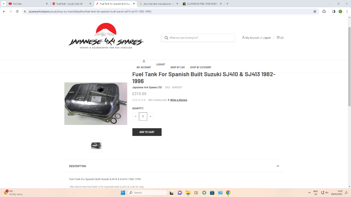

Found this website with Samurai fuel tanks in UK.
When I wanted to order one they were not available!!

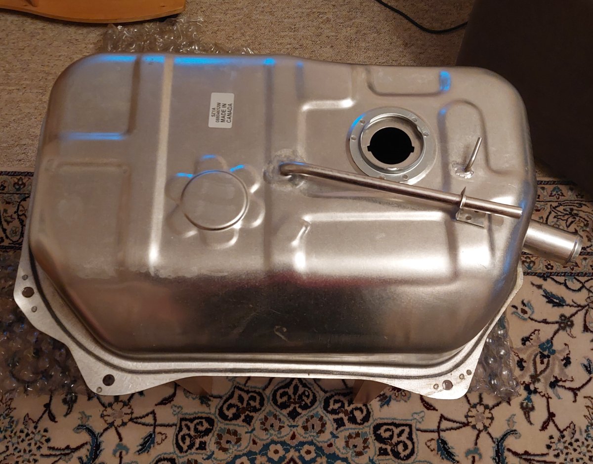

After extensive searching found a "Spanish" fuel tank from France, but made in Canada.
Not fitted yet.

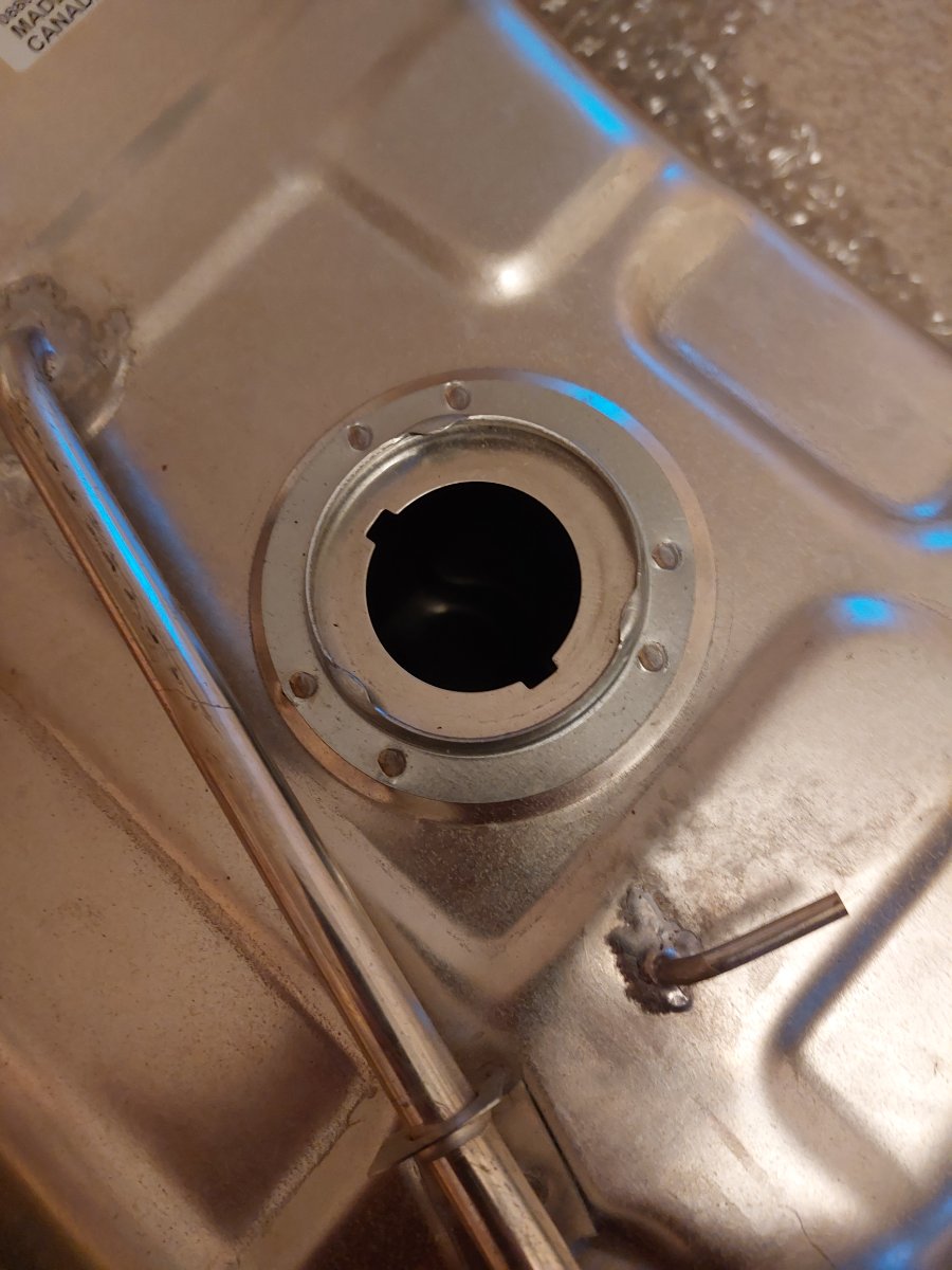

Post by tomcat » Fri Feb 16, 2024 1:52 pm
With the new tank sitting in the garage I thought about whether any fuel tanks had a drain point underneath. There is a hole in the tank guard suggesting it was a thought by Suzuki.
A review online of Catcar.info showed 2 items of interest:-
09168A12005 Gasket Washer and 09247A12101 Filler plug.
Can anyone advise if they have a drain plug in their fuel tank please? Thanks
