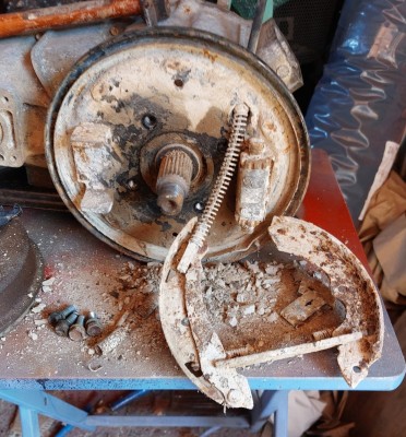

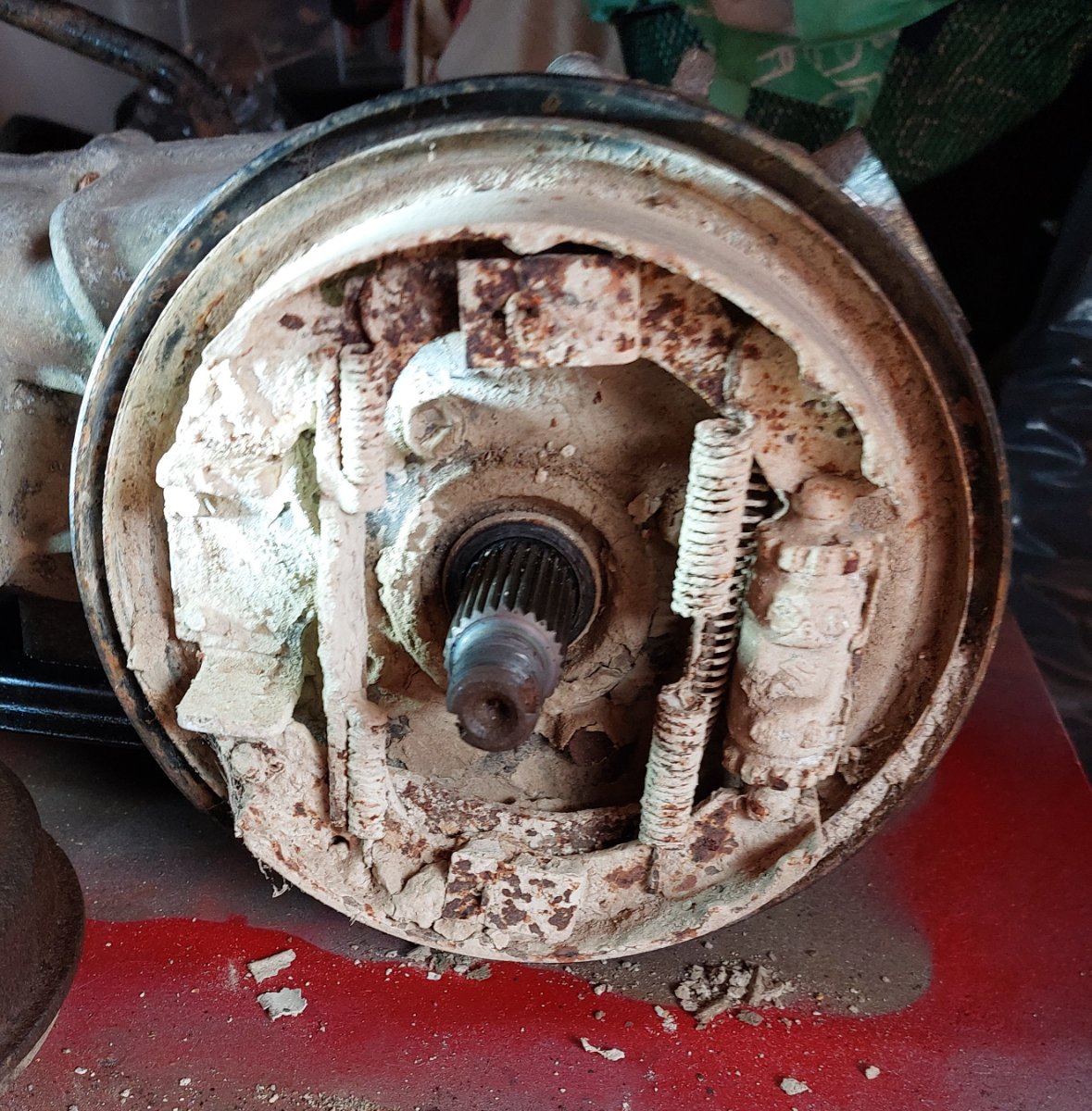

A rear disc conversion is ongoing with refurbished calipers, discs and pads obtained.
Purchased an early SJ413 transfer box with handbrake attachment. On removing the cover rather "muddy" interior was revealed.

Post by tomcat » Sat Jan 27, 2024 1:03 pm
First stage remove dried mud and remove 4 No backplate attachment bolts.
