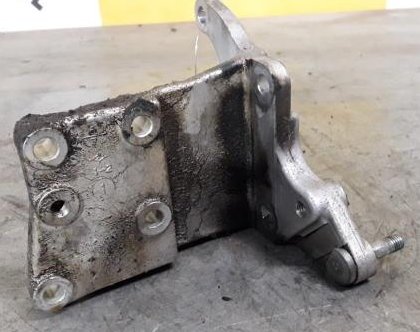

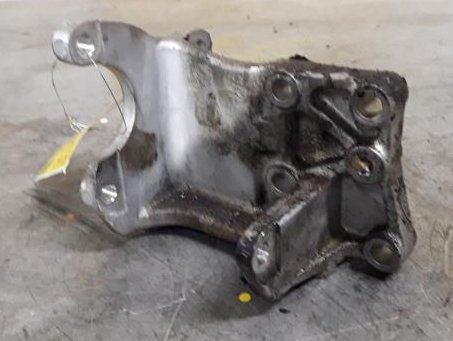

Can I revive this thread with a question.
Have purchased a PAS system from a Jimny.
The engine mount for the PAS pump is as the attached pictures.
It does not seem to fit my G13A Santana Samurai engine. What am I getting wrong?

Post by ScottieJ » Sun Jan 28, 2024 4:56 pm
Was the set up and mount from a Jimny with an M series engine? You need a mount from a vitara G16 8v engine. It’s still not always a straight bolt on swap though as it can be tight for chassis clearance
