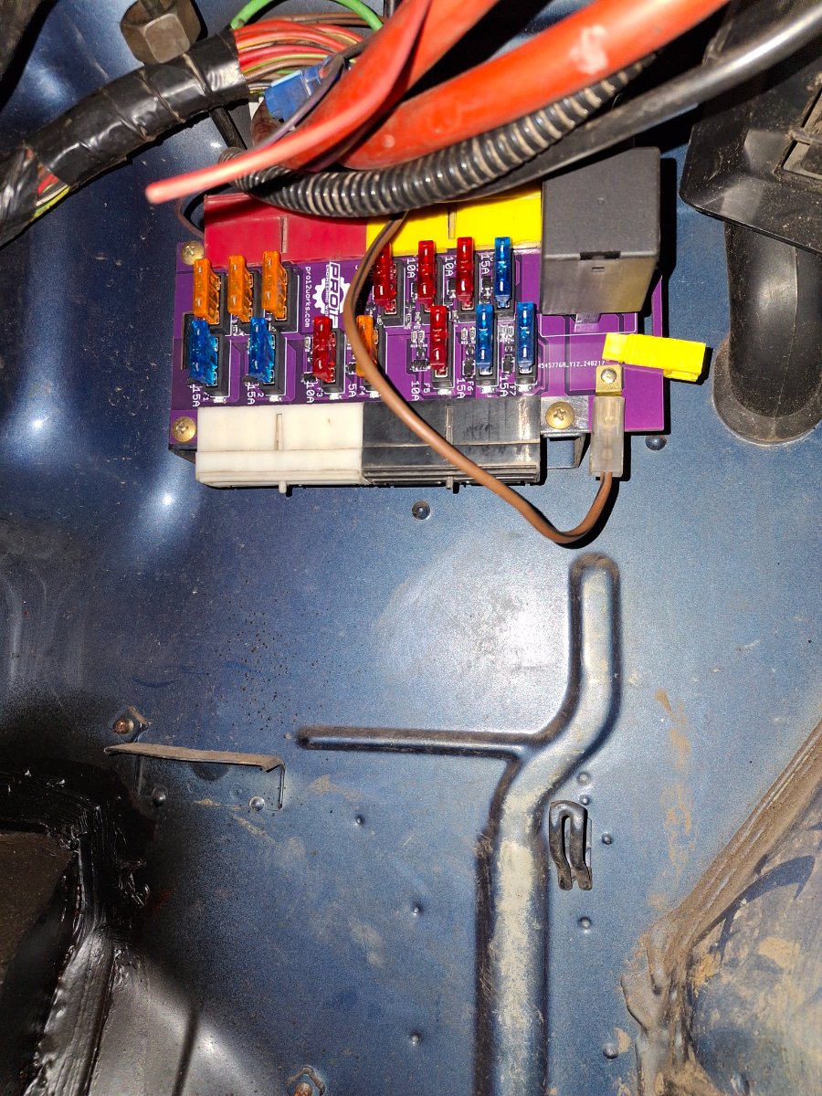

Was having some trouble with my hazards and Indicators.

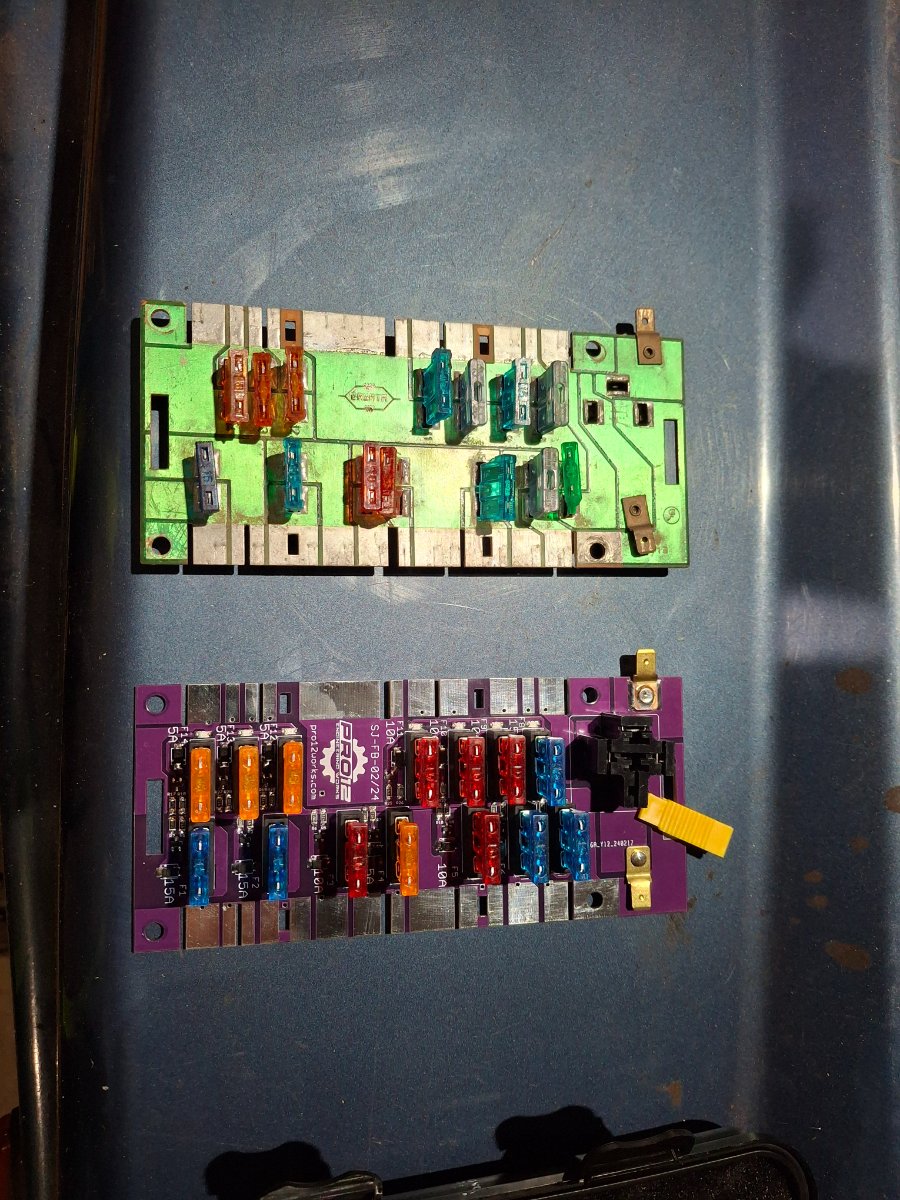

Being a Spanish model it had the old card style fuse board. Tracing some wires then bypassing the fuse board for the hazard relay got the Indicators working but not the hazards.
So instead of cutting the old one out and converting to the jap type or a aftermarket. I picked up one of these.
It's from ortuworks. Company in Spain making them. Has built in resistors that bring on leds if a fuse blows. It's now got all Indicators and hazards working. But still have a weak signal to passenger rear. But now I know any faults will not be coming from here.
