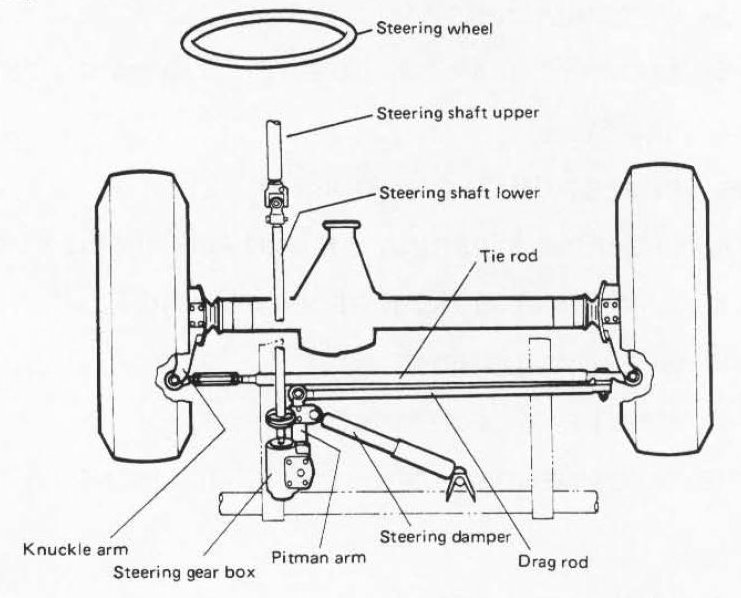

Im new to the forum and have recently purchased a 1992 Sammy and im having some problems with the steering. Had a look in the forum and couldn't find what i was looking for.
I have chaged the suspension using Rough Country add-a-leaf and also exdended the shock mounts by 2" so as to keep original shocks.
My problem is that my steering is know very heavy (unsure if this is related to the mod's above).
If i have a 2" lift do i need to change the steering damper? will this solve the problem?
Or could it be to do with the tire rod ends? or something else?
Any advice welcome as i am a complete newbie. :D
Thanks
Alex

Post by Darrell » Tue Apr 10, 2012 9:26 pm
I would get the front axle on stands and see how easy it is to move (should be very easy). If tight you could remove the damper and see if that is the problem. You could disconnect the ball joint on the pitman arm to drag rod and then see if the tightness is on the steering box/column or the ball joints including the one you've just undone. The lift will have moved the original drag rod angle but this is not normally any problem for a 2" lift and should have no effect on the damper. It could be the kingpin bearings seizing but I've not heard of them going tight, just wearing and being loose. Have fun and welcome to the club.
