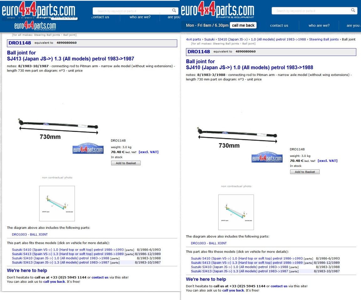

Had another look at it earlier, and found there is excessive play in the ball joint that attaches to the steering box. Im not sure if this is the main problem but it will deffinitely need sorting immediately.
Im under the impression i cant just change the ball joint so i may need to source a replacement bar. I know a sammy one would be longer but are the 413 and the 410 ones the same??
Re: Steering Problem
Post by Darrell » Thu Mar 13, 2014 7:36 pm
ferris wrote: are the 413 and the 410 ones the same??
This company lists them the same.
Untitled - 1.jpg (176.17 KiB) Viewed 3223 times

I replaced the steering bar today and it seems to have solved the problem :D .
