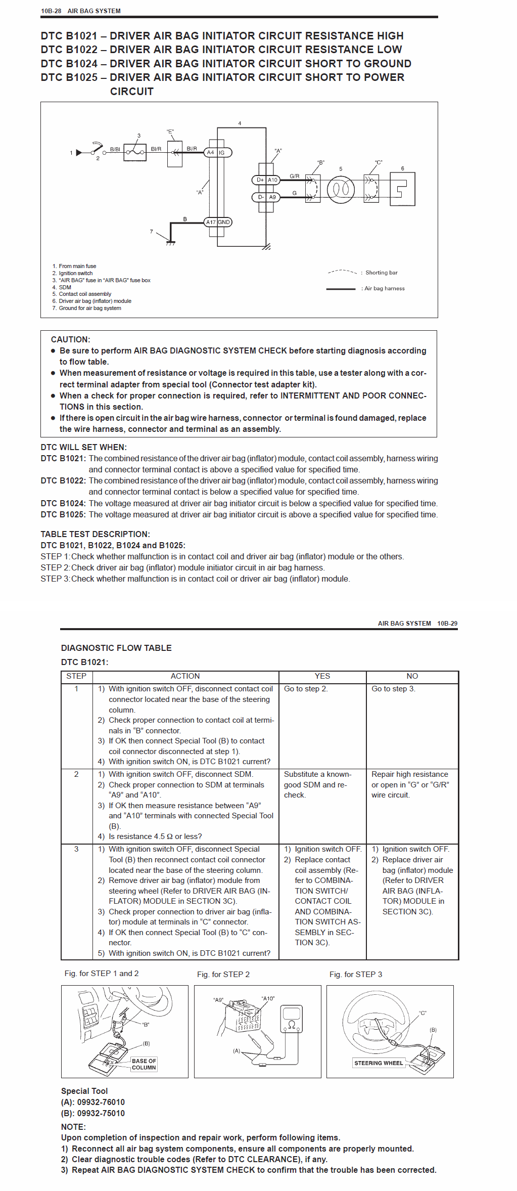

Re: Airbag warning light
Post by Darrell » Mon May 26, 2014 7:47 pm
I'm sure you have this from the link Rhinoman gave you......
But for those following with interest (I'm one :thumbup: ) here is code 21.
Jimny airbag code 21.png (350.36 KiB) Viewed 11956 times
