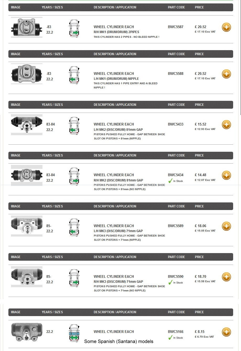

I put this together years ago from the brakes international site for the 410, so ignore the prices..
SJ 410 rear cylinders.jpg (206.82 KiB) Viewed 7638 times

Bwc5590 is this the one you have mate ?

lukey4x4 wrote:Bwc5590 is this the one you have mate ?
Looks like it, its the drivers side on yours. Goes from the flexi to this cylinder then out over to other side that has the bleed nipple on it.
Fun fact, this is the exact opposite on a kja as the exhaust is on the right and the flexi is on the left.
