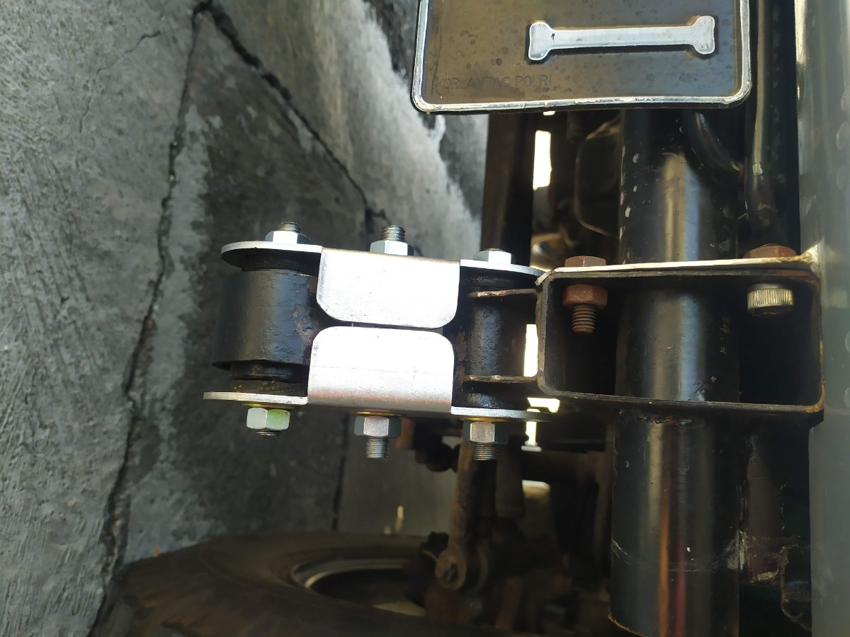

Evansyah
Posts: 1
Joined: Sun Aug 08, 2021 3:55 pm
Re: Shackles
Post by Evansyah » Sun Aug 08, 2021 4:00 pm
Just made the custom one. Look better (for me) :)
It has 10cm space between top and bottom hole. Not sure about the stock one, i think the stock one has 6cm space 🤔
