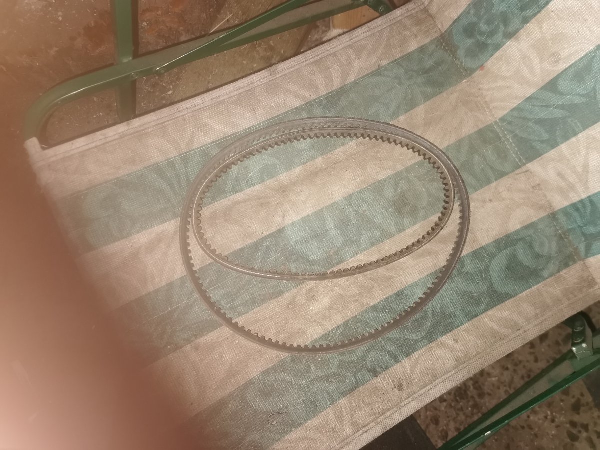

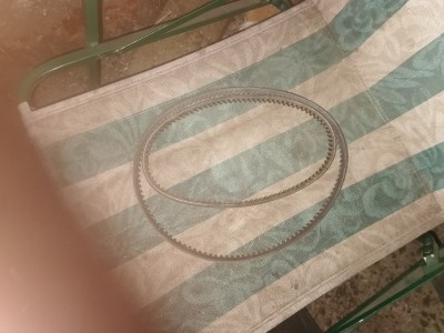

Took belt off and ran engine, noise dissapeared, the bearing does have a litle noise when spinning by hand in Vid, ignore the noise at start is my elbow hitting something, https://youtu.be/AJypNpeXevw. Thought I had a new belt to try but looks like the wrong one .

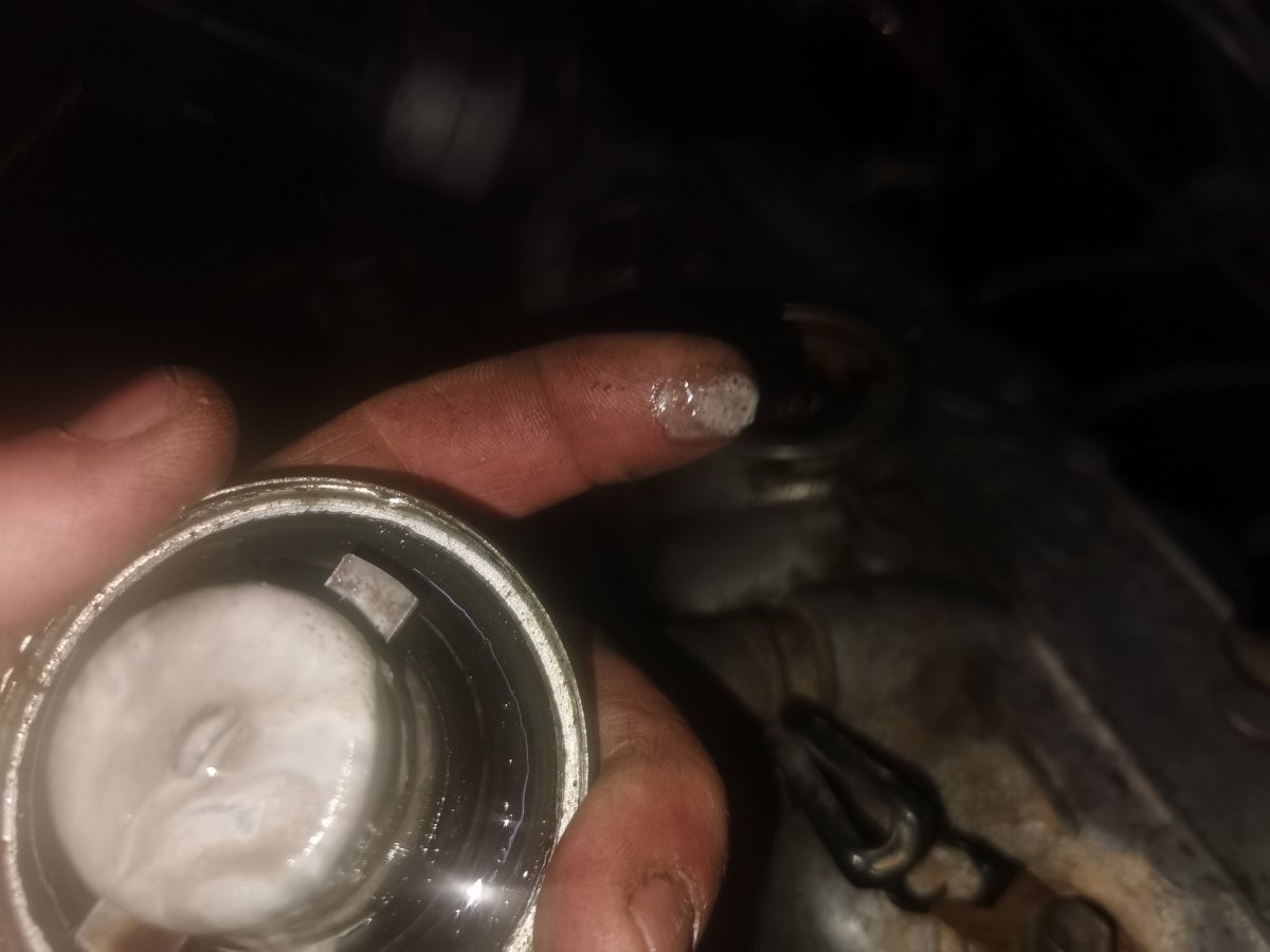

As for smoke, ran it foe a god half hour before I had to get out for the fumes :D still smokey. It starts first time and sounds ok took oil cap off and whitish sludge, in pic not sure if its head gasket or not, but Temp Gauge does not go up high and does not loose any Water or Oil at all.

If the SJ has been standing for sometime, been jet washed, short runs only it is probably a build up of condensation, if temperature and water level are staying the same. Once warmed up beads of water on dipstick could indicate a head gasket problem. Has the oil been changed since you acquired the SJ? A pressure test could tell you a lot, or put your mind at rest.
There is a slight squeak on the alternator, difficult to tell, possibly a dry bearing warms up over 10 minutes to get noisy. What was your verdict on the water pump bearing, any movement. Wondering if the thermostat opening after 10 minutes would influence the sound.

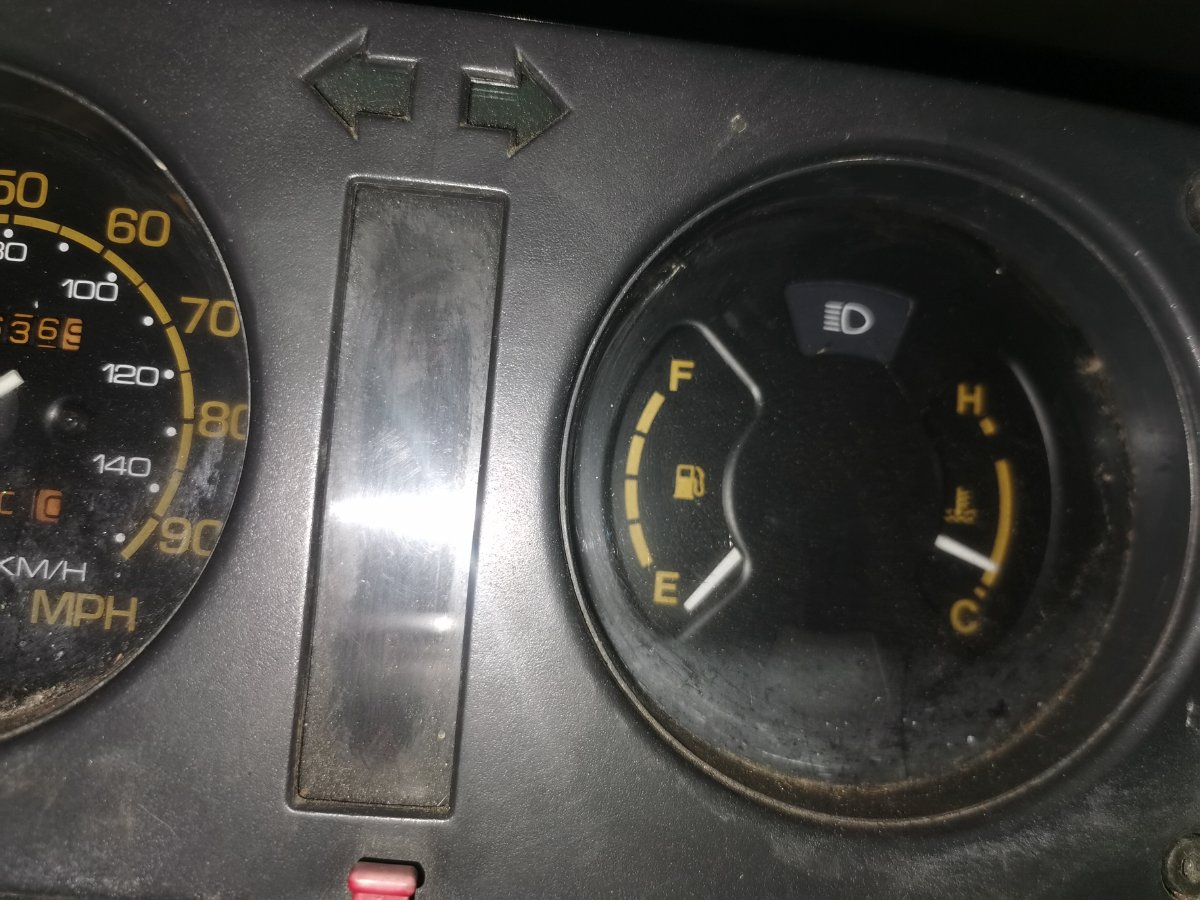

Well litlte bit of Progress , I Think. Went up tonight and took it out for the first time, this is the longest it has gone or been run since we got it, Could only go up and down the back streets as no MOT or Insurance yet. Got up to third gear everytime never tried 4th or 5th .
Anyway ran up and down streets like this for just over half hour till Temp went up, Got back to garage and let it Idle No Smoke as in first Vid, Revved it a few times and yes smoke but not excessive, Temp gauge never went past where it is on pic, No Water or Oil lost, Question is Is it OK ? or should I have ran it for longer ?
https://youtu.be/nqNX8w0Sdgk
https://youtu.be/k7pXqa0jciE
lundigee
Posts: 114
Joined: Sat Oct 19, 2019 11:04 pm
Re: SJ 410 Engine, Help Please
Post by lundigee » Tue Nov 10, 2020 10:29 pm
I would say that sounds good, you still got that bit of squeak to finish off, but I would have no hesitation to do a bit of a trip with confidence. I would get legal and some fuel (if the gauge is still not working) and take it for a 'lockdown' trip out. All the best with the MOT.
