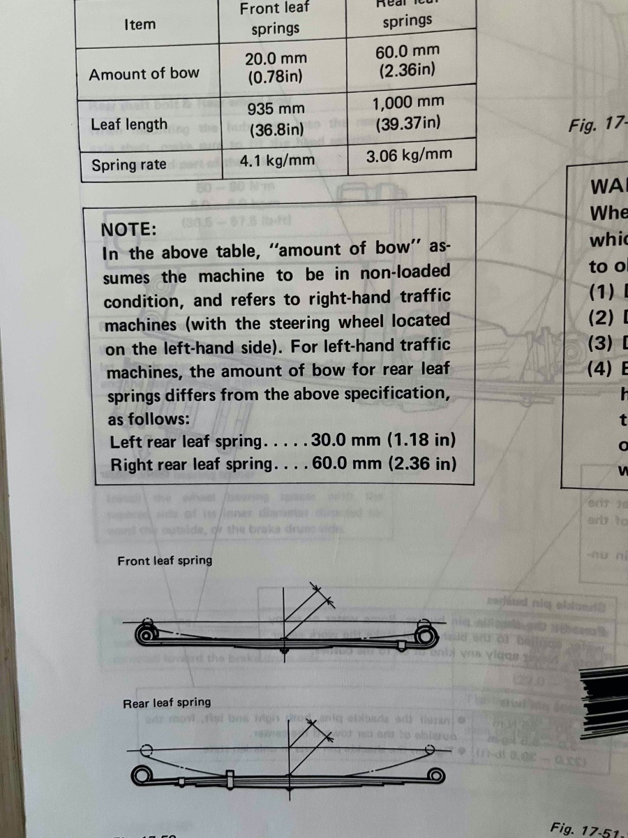

Drawn a blank everywhere on OEM spec springs. +40mm easy, but standard no-lift impossible (so far).
I'm considering having Jones Springs (Midlands somewhere) recondition a set of originals. Either take mine off or buy some from a breaker (think I have a source).
QUESTION: anyone know spec of the springs unloaded (off vehicle) - basically lengths centre - to centre, and amount of bow. I have a manual (official Suzuki I believe) and it specs bow when on vehicle but it will surely be more when it is off vehicle, it'll compress when loaded I expect.
What info I have is in pic - any more detailed springs spec anywhere?
