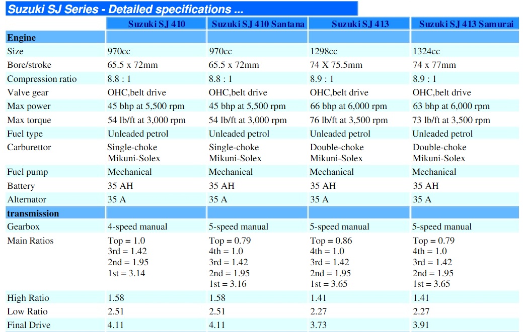

Finding conflicting info about
So is a 413 3.73 to 1
and a sammi 3.91 to 1
Top of page reads 413 = 3.93 to 1
Sammi = 3.727 to 1
I've also read the same elsewhere. So what are they.

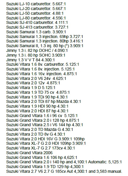

Also I found a spanish list on a couple of other sites and tidied it up (in english)
If it's wrong, let me know and I'll alter it (or scrap it )
SJ axle info

I've corrected the original ratios it should be 3.909 (3.91):1 not 3.93:1
From what I've always thought in this country the early 413s were the 3.909 ratio and all samurais were 3.727 (3.73):1
However that is not to say it is the same for all countries! There are many differences between SJ models over the years in different markets and things were changed at different times. Hence the various different ratios on the Spanish list, I'm pretty certain we've never had a 3.4:1 ratio diff in this country.
Where is that first chart from Darrell? I think its wrong.
