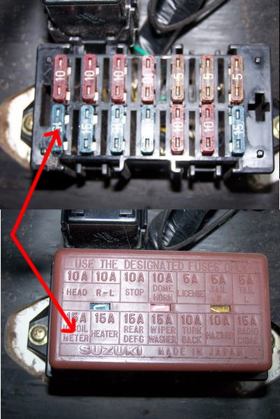

When you say used to go to carb solenoid I assume you have something non standard, IE SU.
If that black and white wire touched earth it will have blown the shown fuse. The engine ran when you connected it to the large terminal on the starter solenoid as this is permanent live (which is why it didn't stop). The yellow to sender will/should have a white tracer.
If the fuse has blown, just insulate that loose black/white wire and replace the fuse.
The black/white is the supply to ignition coil and alternator.
- fusebox.jpg (63.39 KiB) Viewed 7675 times

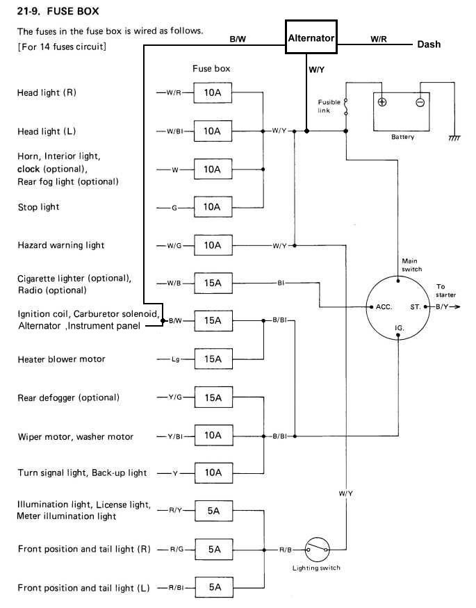

Added the alternator to the supply diagram...
- Supply with altnernator.jpg (70.39 KiB) Viewed 7649 times
