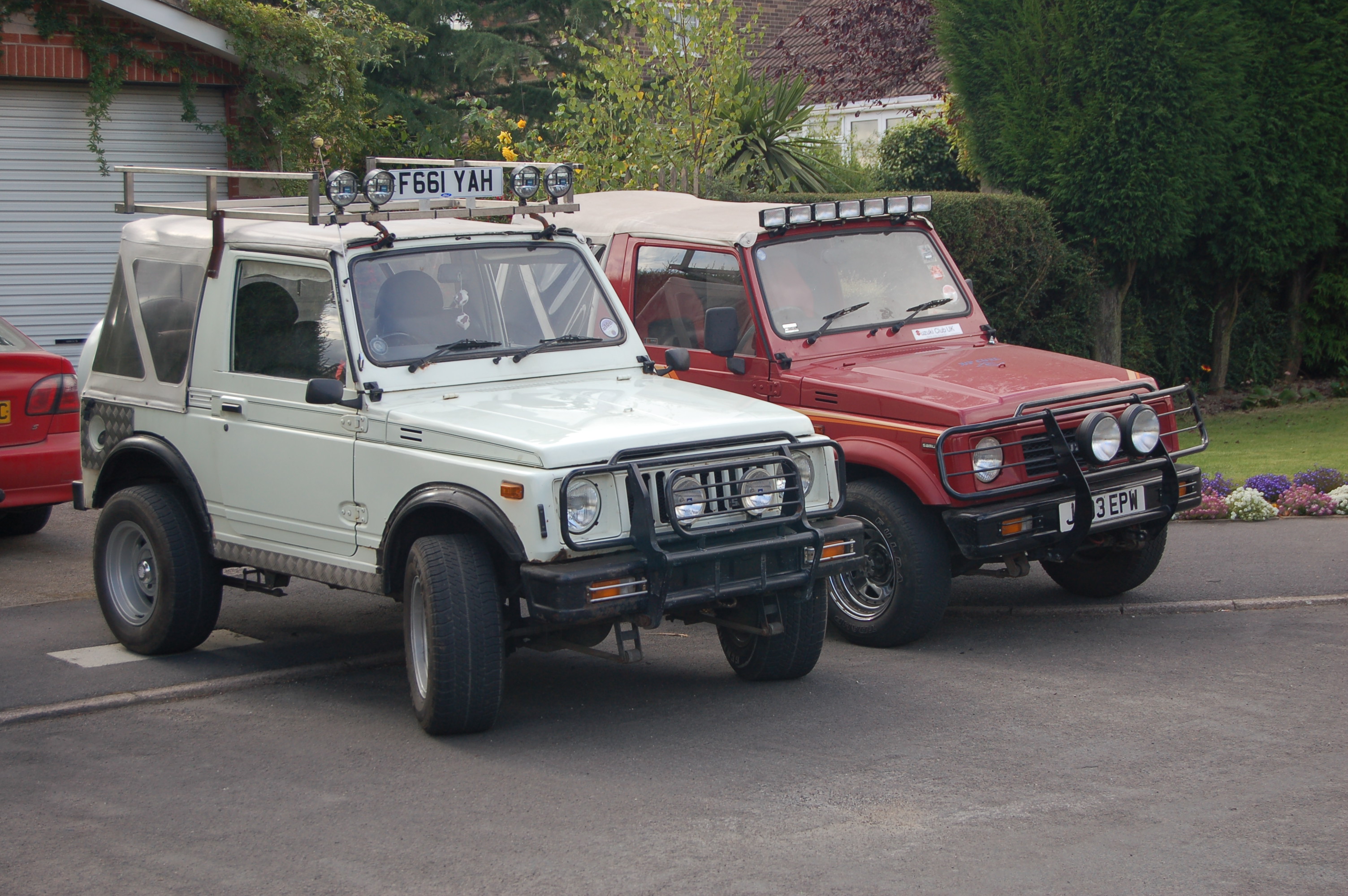

Re: in need of some advice
Post by Tramp » Mon Mar 11, 2013 10:24 pm
On this photo you can see my mates old 410 with the parabolic springs, if you look behind the front wheel you can see how flat they are.... I suppose it doesn't help that he put +2" fangs on the front but they were flat even when they were on standard shackles
