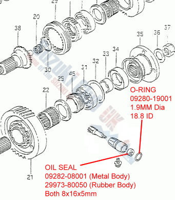

In case anyone else has the same problem, I thought I'd add the following info.
The o-ring you need is just an ordinary 19mm ID o-ring. Alternatively if you want one from Suzuki, the part number is 09280-19001 and they're about 60p.
Also, most of the exploded parts diagrams have two different part numbers for the oil seal.
One is 29973-80050 and the other is 09282-08001, although they look identical on the drawings. I called Suzuki and they had no idea what the difference was.
They were only a couple of quid each so I bought both so I could post the differences here and keep whichever is the correct one.
From looking at them both, either part number will work. It looks like one is just an upissue of the other.
I dimensioned them both with a vernier and they have exactly the same physical dimensions.
If you have one that is all rubber, then the part number is 29973-80050. If you have one that has a metal outer edge to it (a bit like the rear axle oil seals) then the part number is 09282-08001.
Re: Leaky Transfer Box
I did have the part numbers for the oil seal but didn't post them as I had no idea what the differences are, so thanks for the info.
My searching also says the seal is 8x16x5mm
The O-ring came back as 1.9mm diameter and 18.8mm ID
But I expect a 2mm X 19mm would fit fine as that probably what you have.
I'll have to do a diagram
Hope this is correct...
