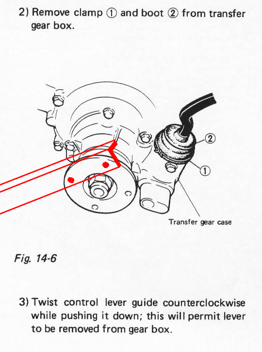

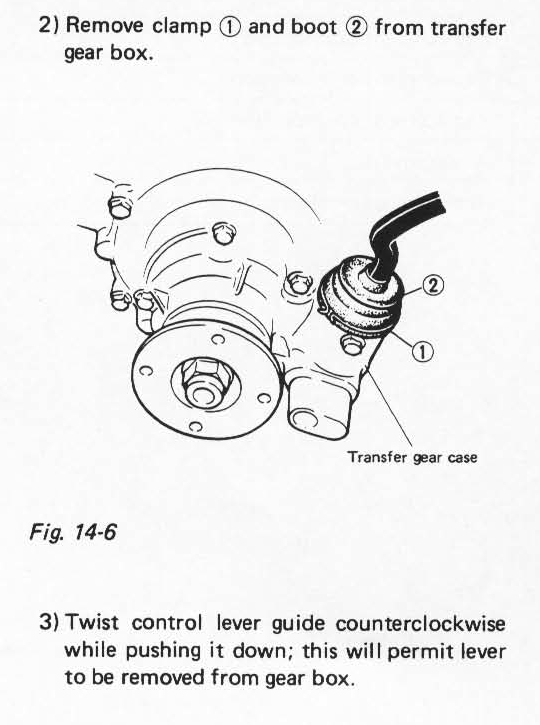

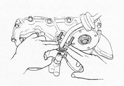

Re: Transfer box input oil seal sj410 1986
I'm sure a bit of angle iron would do the job and be cheap.
Here's the workshop page on the lever removal.
Update
Thanks Darrell for helping out, see pics for my simple interpretation, it has worked well on flange and drum brake.
