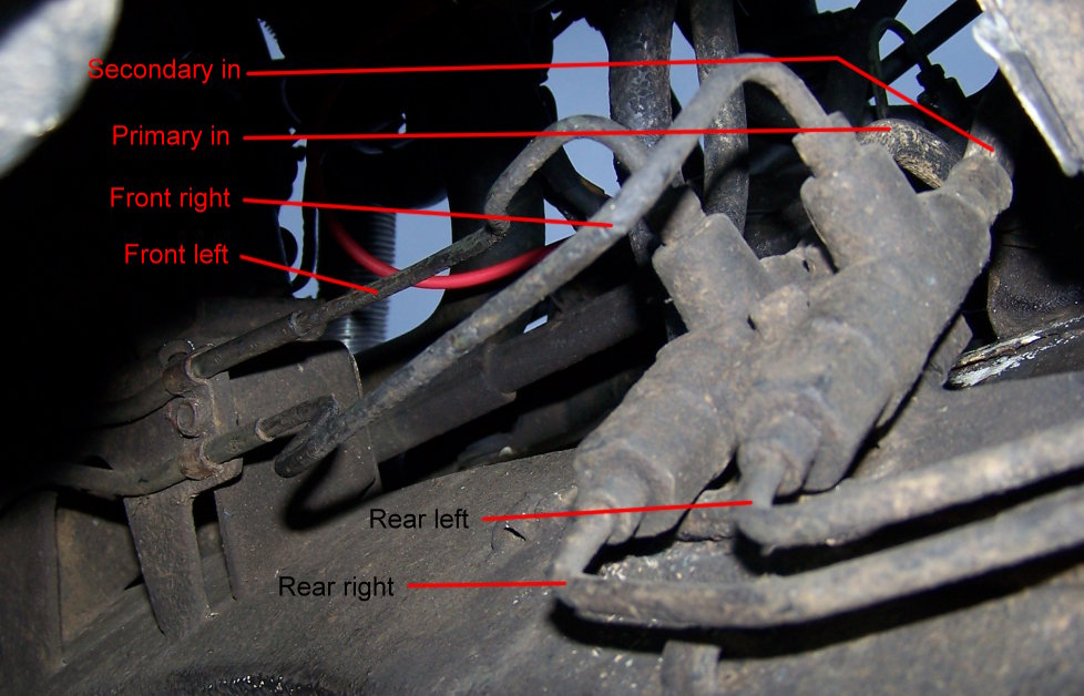

Not sure how the 6 way valve could cause this problem
I only say this because my valve does one front, one rear from either feed from the master cylinder.
It is just your front brakes sticking on ?
Have a look at your valve plumbing as they are not all the same, some only have a 5 way valve and one side does the front brakes alone and the other side the rear brakes.
- My sj brake pipes.jpg (198.79 KiB) Viewed 6798 times
- 100_5016.JPG (177.72 KiB) Viewed 6798 times

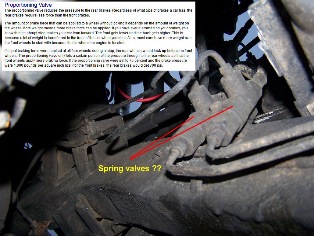

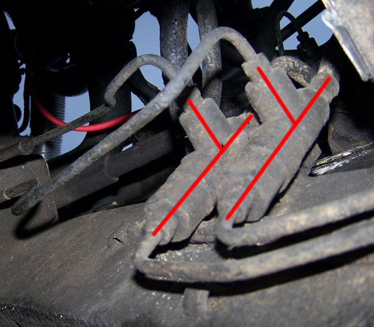

That's the same as mine. I agree with what you say but it is the only thing I have not changed and I don't know how they work. Is it unheard of for these to fail??? Thanks for the help.
Re: Brakes seizing on help.
Never heard of one failing.
Just wondering if it's possible for the servo to stick on applying force after you have braked
Strange one this !!
Strange one this !!
- dr.jpg (281.09 KiB) Viewed 6785 times
- Edweird
- Posts: 2531
I thought the portioning valve was the gadget near the fuel filter?
