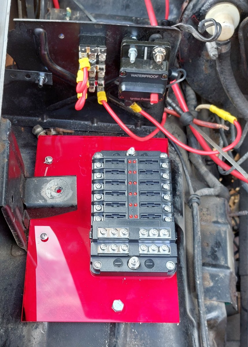

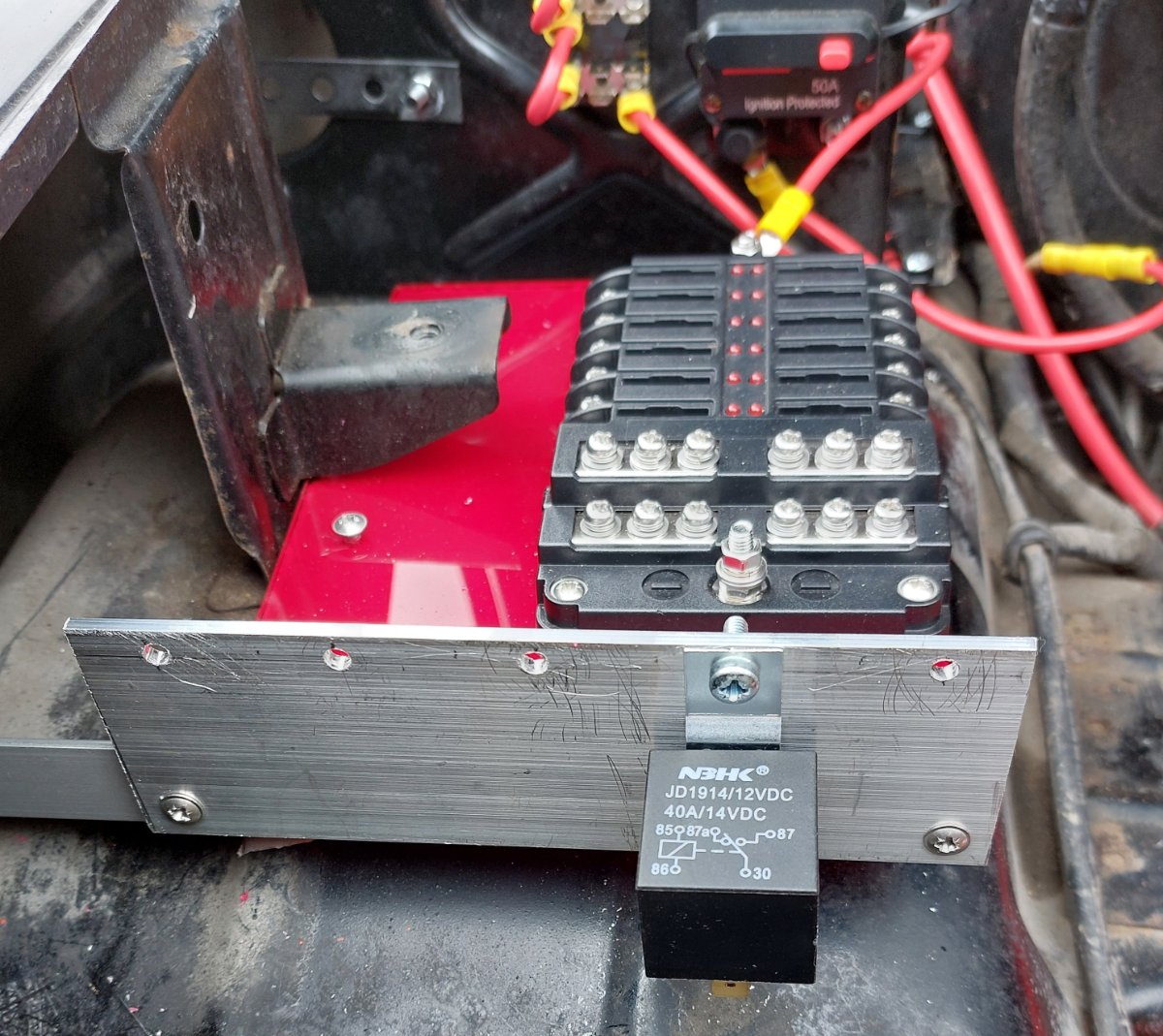

2. Tried preliminary position for auxiliary fuse box.

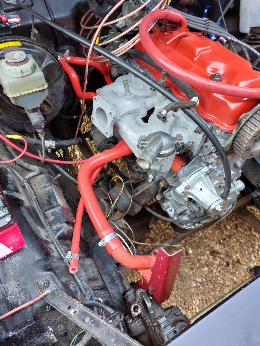

Busy morning. Jimny steering box fitted, adjacent radiator support fitted with no clash.
Rockwatt inlet manifold fitted together with cooling hoses.
Fitting for relays trial fitted. Start made on replacing all fuel and brake lines.

Trial fix for relay location.

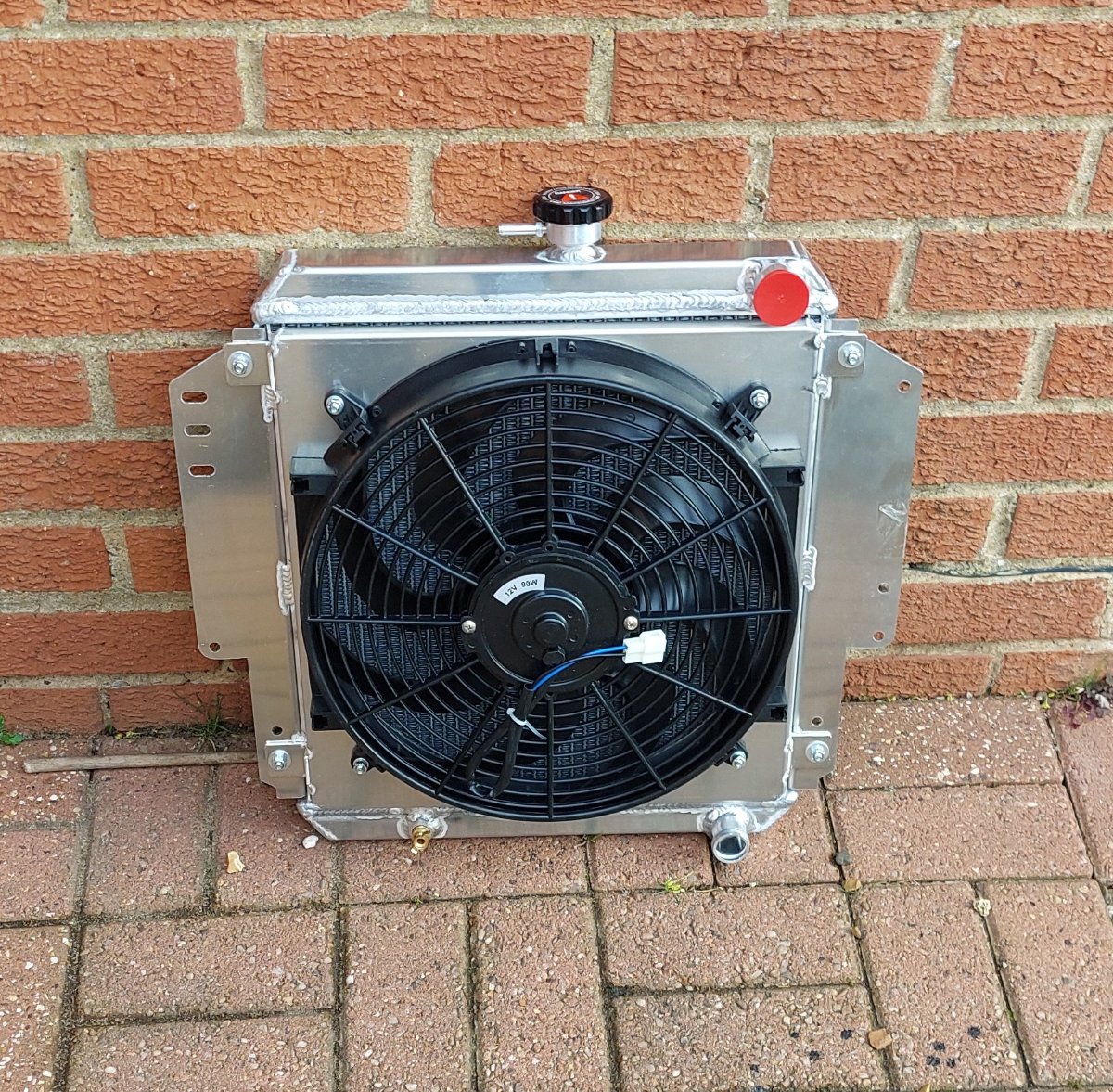

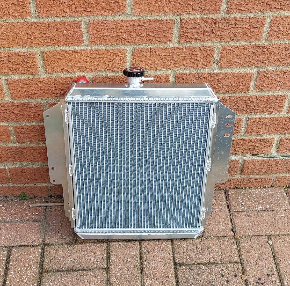

Post by tomcat » Wed Apr 10, 2024 10:32 am
Unboxed the new radiator. Will be fitting a power steering oil cooler to the radiator as well.

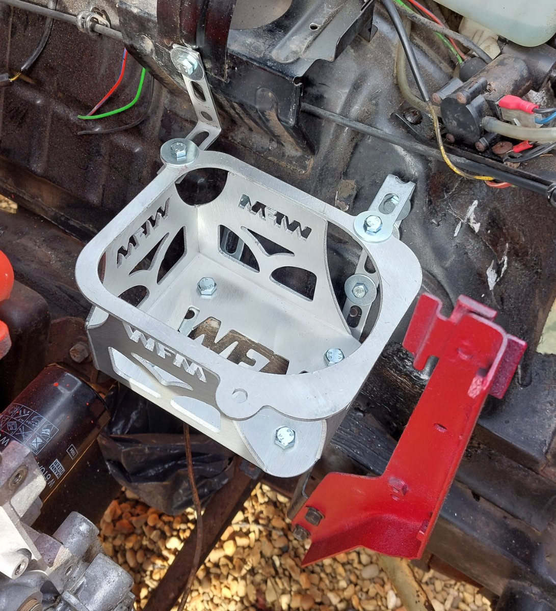

Post by tomcat » Fri Apr 12, 2024 4:27 pm

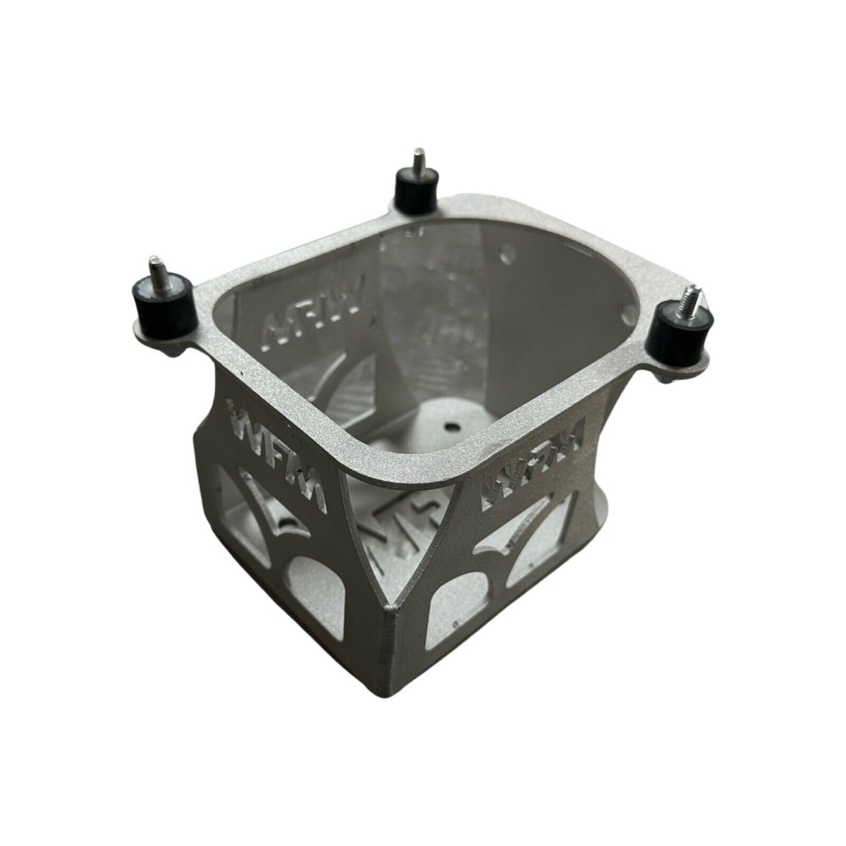

Obtained a WFM bracket / box for the Volvo electric pump. Been measuring / sketching and 'may' have a solution. More later.
Have purchased a set of the rubber anti-vibration bushes as well.

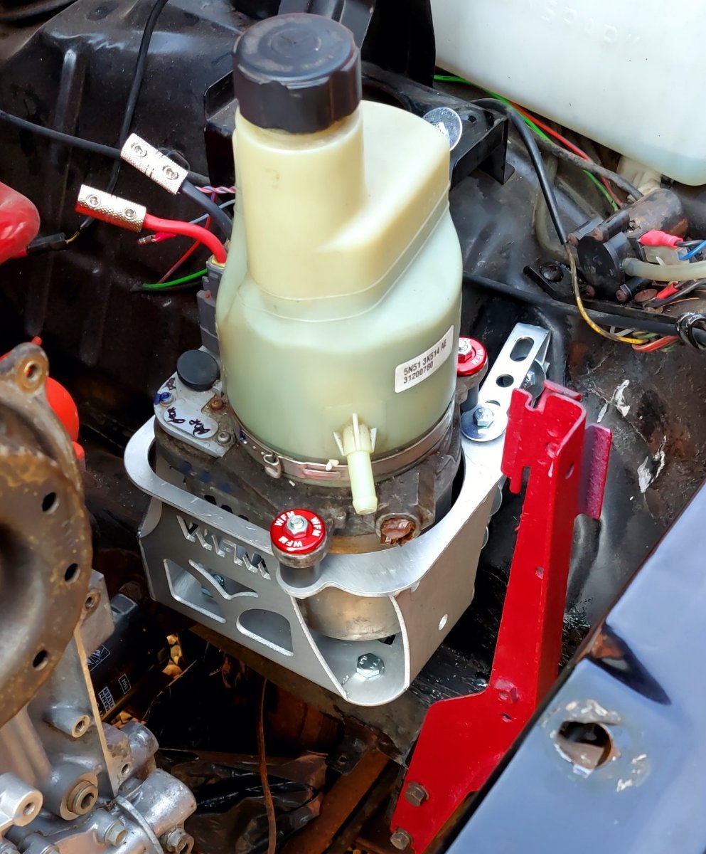

Post by tomcat » Sat Apr 13, 2024 9:45 am

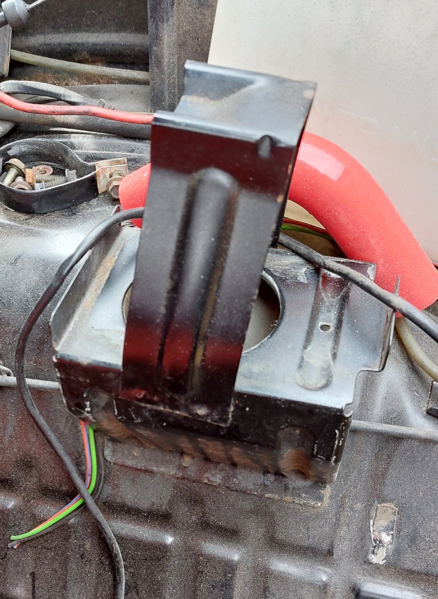

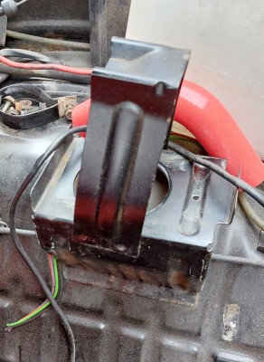

First trial fix still retaining jack position. End bracing still to go in.
Some tweaking needed but in principle it works OK.
Some tweaking and pump in position. :thumbup:

Post by tomcat » Tue Apr 16, 2024 3:45 pm

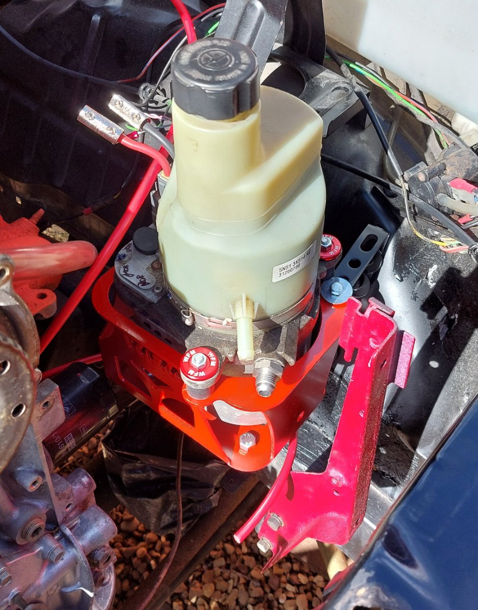

'Final' fix of the Volvo pump. Some paint as well.

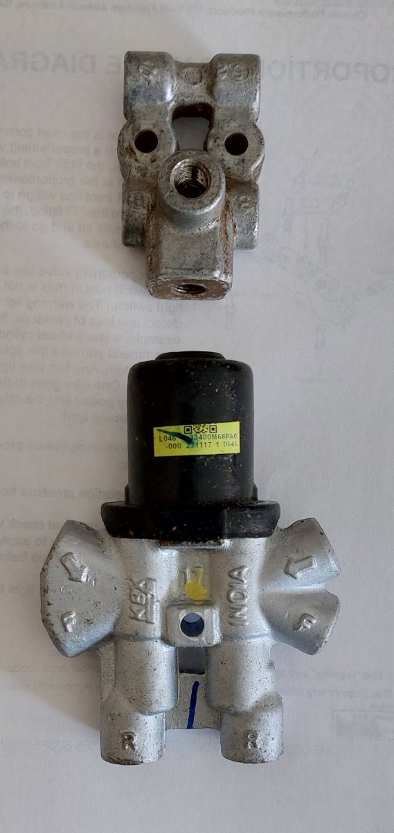

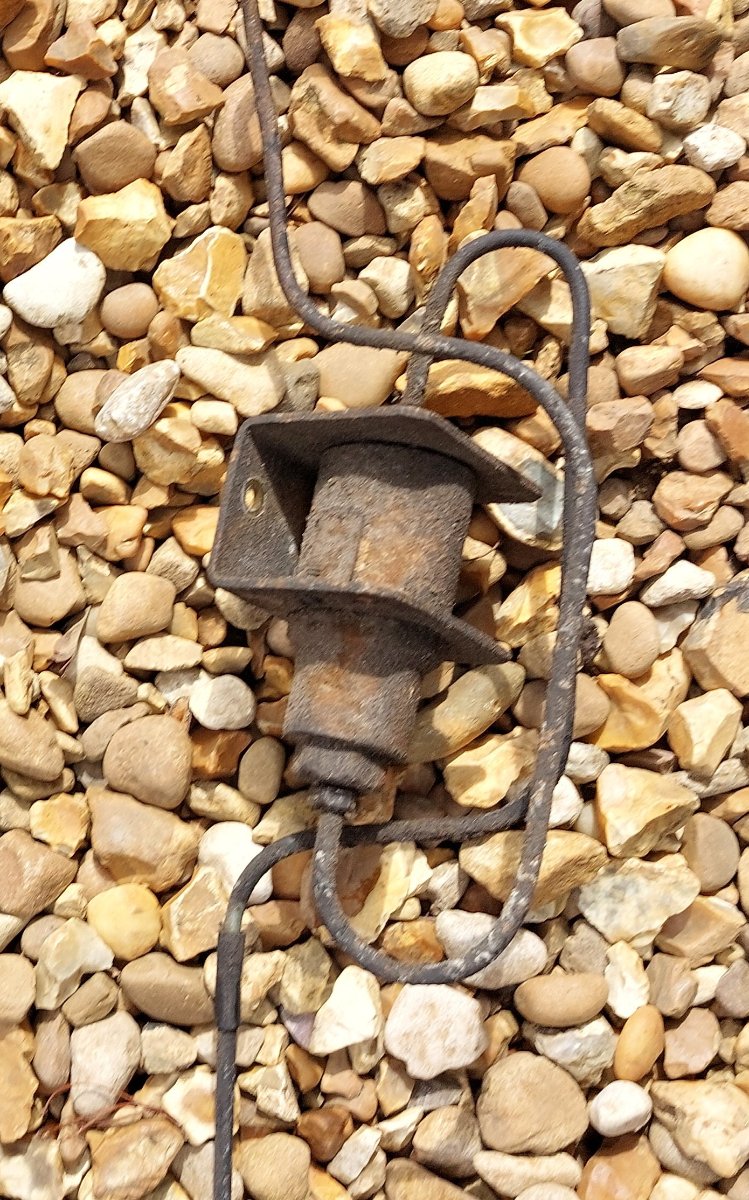

Stripped out brake system for complete renewal. Proportioning valve has seen better days.
As have done rear disc conversion intend to fit a proportioning valve.
tomcat
Posts: 236
Re: 1991 Santana Samurai
Post by tomcat » Wed Apr 17, 2024 9:36 am
My 6 way and proprtioning valve I plan to fit.
