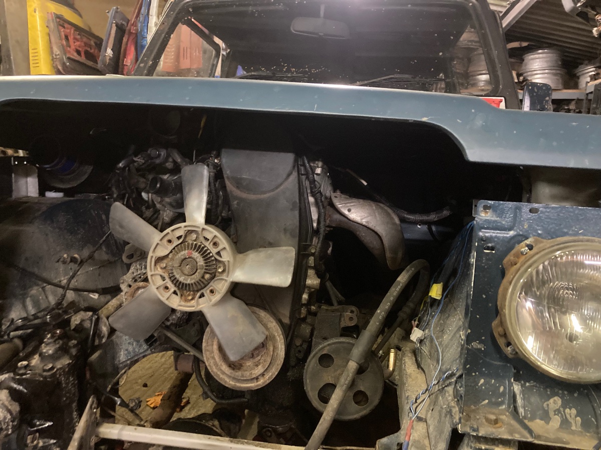

Turns out the inlet manifold on the GV G16b has a rather tall inlet manifold compared to the earlier 16vs as I’ve used the same engine mount set up that I have many times before with g16 swaps and can’t close the bonnet :lol:
I’ve just bought a Jimny inlet manifold to fit to hopefully solve that issue as they don’t sit as tall.

Soooo I’ve been continuing with this, almost got the wiring loom finished and made some new rad mounts to drop a vit 1.6 rad in.
Ran into an issue trying to use a g13bb inlet manifold though. Although the inlet will bolt onto the g16b (as people do when converting a Jimny to 1.6) the electrics are not compatible with the GV loom and ECU. I thought ok, I’ll just swap the EGR, throttle body and MAP sensor onto the g13bb inlet. No cigar! The TB has a different bolt pattern and the MAP sensor is a completely different style. I think the EGR and Evap canister purge valve would swap over though.
I know guys in Australia use the G13bb inlet on baleno engines and I’m pretty sure they fit the baleno TB so I’m presuming the coil pack baleno engine has the same electrics as the Jimny.
So I think I’m gonna fabricate some new engine mounts and drop the engine 40mm, this shouldn’t be an issue as it has suspension lift so the sump should clear fine. Just another hurdle I didn’t need 🤣
It’s all part of the fun though to see what works and what doesn’t with SJ engine swaps.
