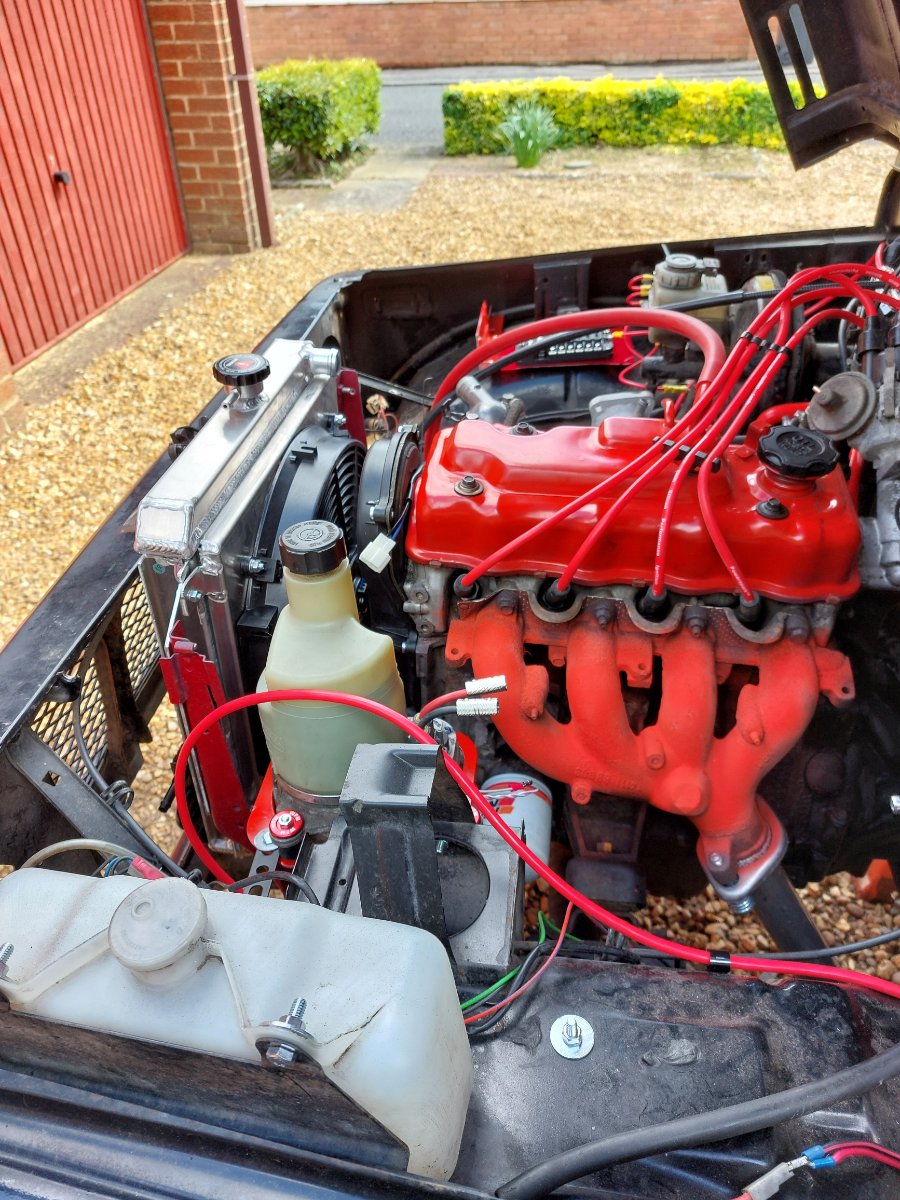

Post by tomcat » Fri Apr 19, 2024 2:34 pm

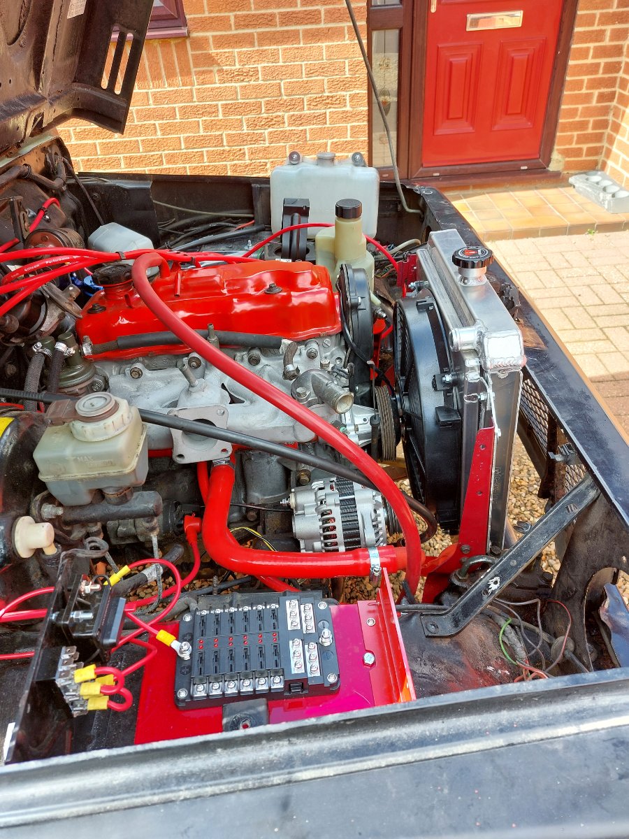

Between rain showers few more bits done.
Radiator in place, alternator needs bracket made, new plugs and leads.
Has raised certain issues to be solved over next week or so.

Bay is looking good!

Re: 1991 Santana Samurai
Post by tomcat » Sun Apr 21, 2024 10:10 am
Rankine wrote:
Sun Apr 21, 2024 9:06 am
Thank you. Still some way to go.

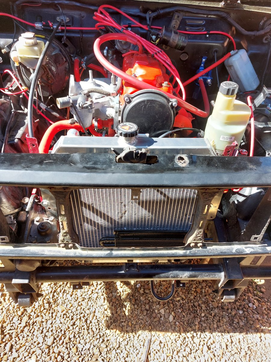

Replacement radiator prevents bonnet from closing properly so that will need rectification.

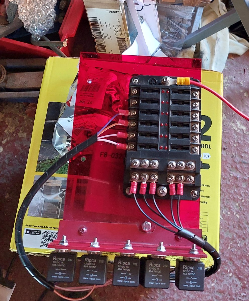

Post by tomcat » Tue Apr 23, 2024 11:55 am

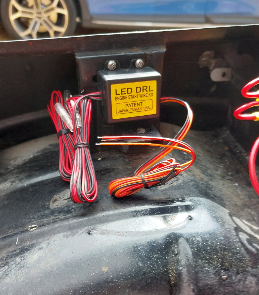

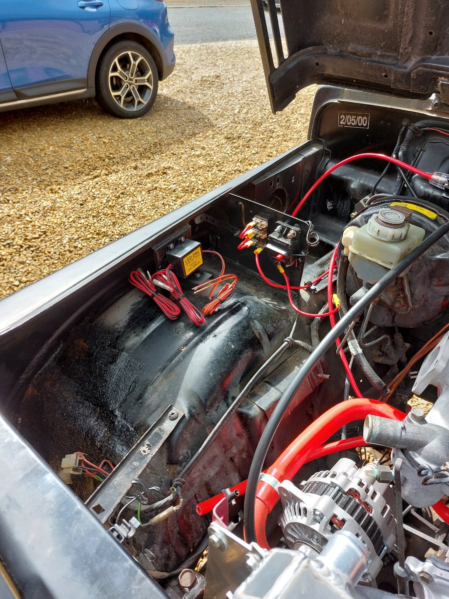

Some wiring undertaken to fusebox / relay board. In garage due to wet weather.
LED DRL controller arrived and positioned as at the moment it is still dry!!

Post by tomcat » Fri Apr 26, 2024 9:33 am
Some more electrical work on fusebox / relay board.
Post by tomcat » Tue Apr 30, 2024 11:00 am

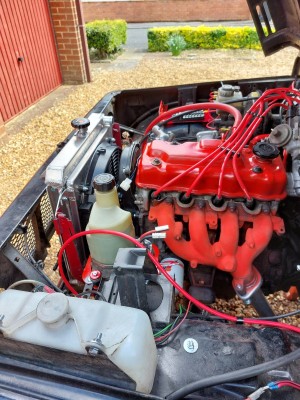

Radiator dropped so that bonnet closes as it should.

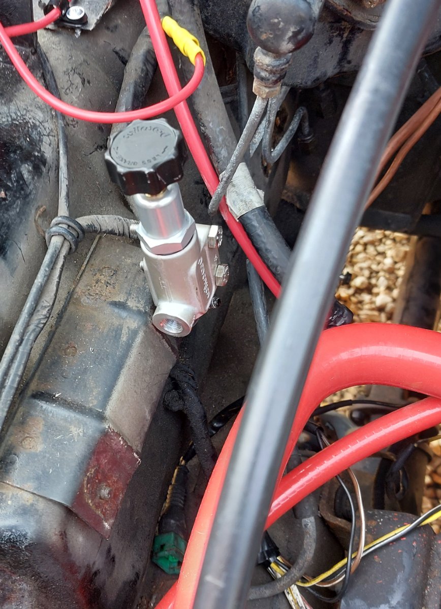

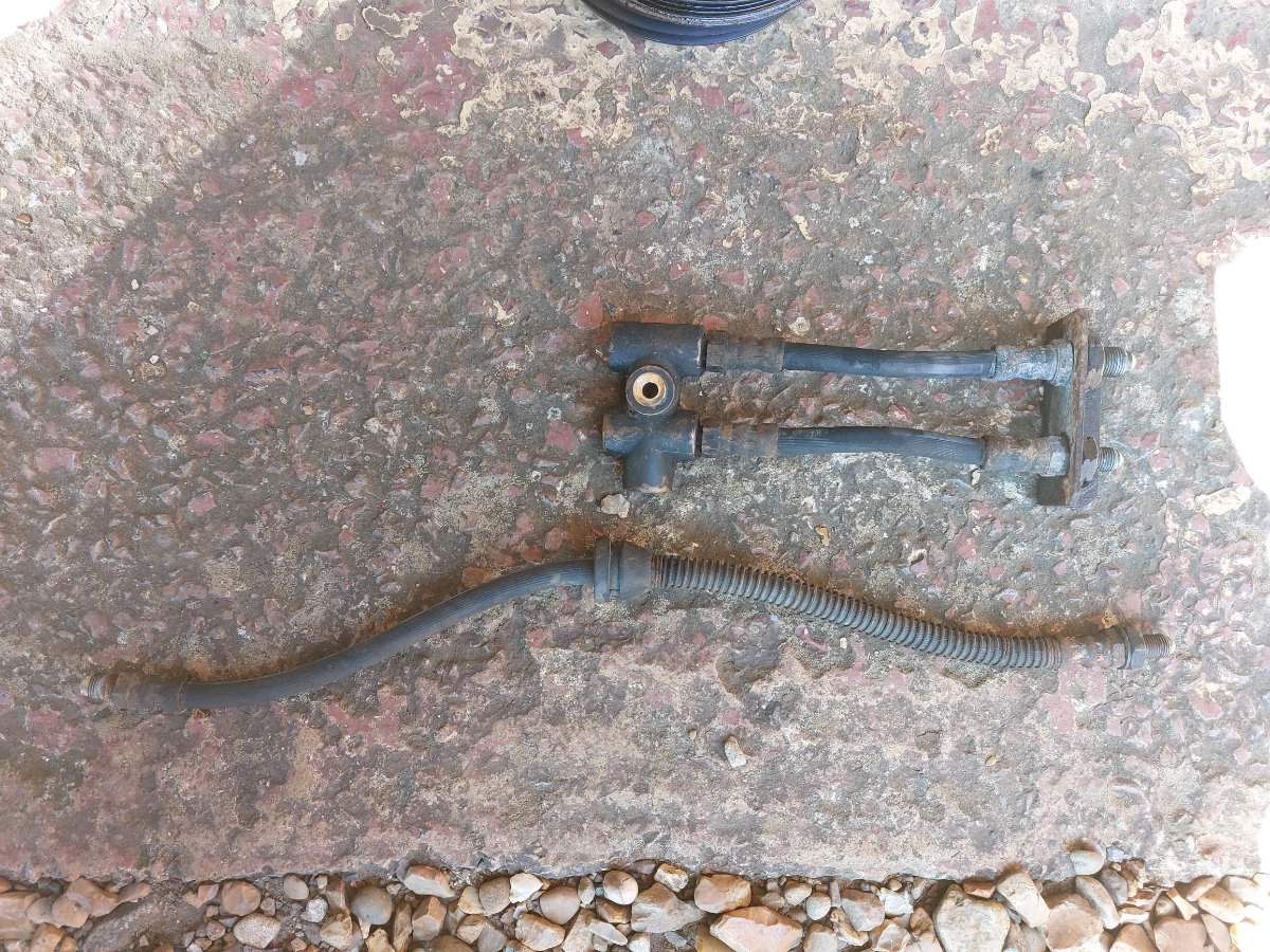

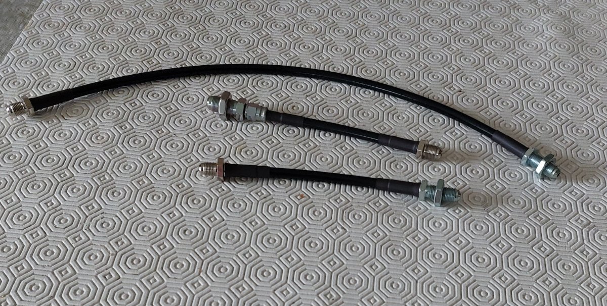

Post by tomcat » Thu May 02, 2024 12:03 pm
Old brake lines.
After trip to Earls at Silverstone, replacement lines.
Provisional position of Wilwood valve, to be verified after installation SU carb & air cleaner.

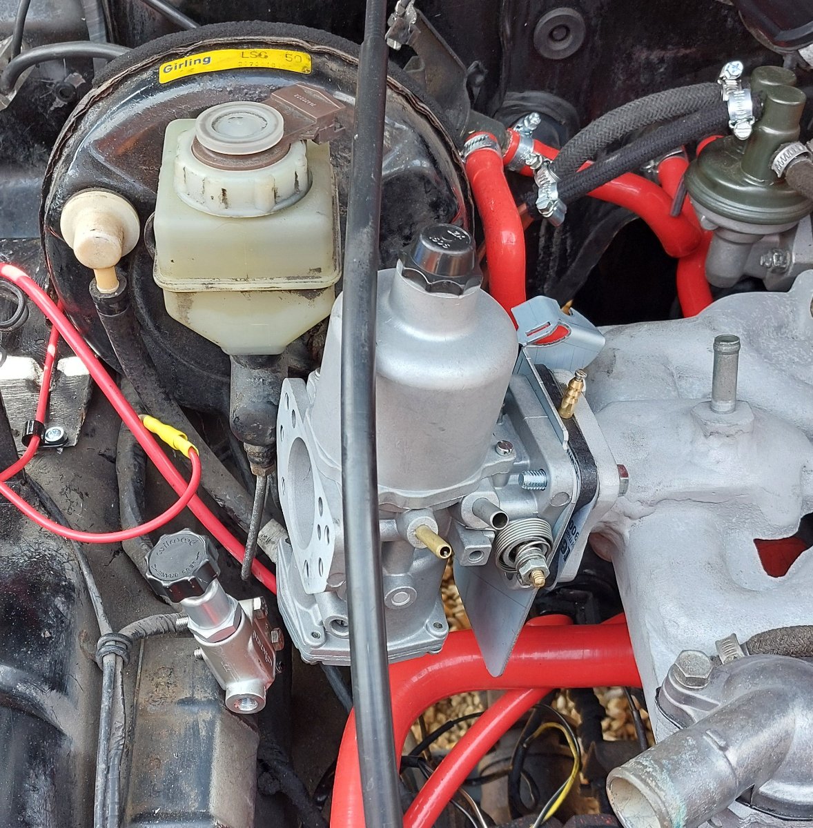

Post by tomcat » Sun May 05, 2024 4:16 pm

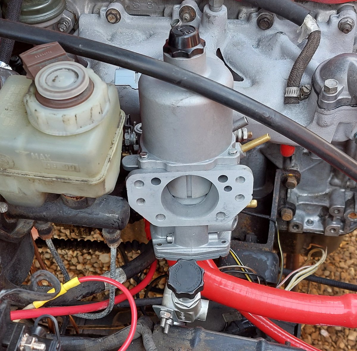

As expected clash when SU carb fitted. Wilwood valve easy movement. but seems the Rockwatt modified manifold does not move the carb away from the servo / master cylinder enough.
Posts: 340
Post by Rankine » Sun May 05, 2024 6:19 pm
Is the carb making contact with the servo?
Where did you get your throttle linkage plates? I've just sent my manifold off to Richard aswell. Hopefully I'll clear my servo.
Posts: 11699
Post by ScottieJ » Sun May 05, 2024 6:43 pm
Does the carb clear with the vacuum takeoff spacer removed? You need to remove that spacer anyway as the vacuum takeoff is on the wrong side of the butterfly with that fitted.
As per Nigel heads write up, linked in the SU carb thread the dizzy vacuum takeoff needs to be on the air filter side of the butterfly valve.
