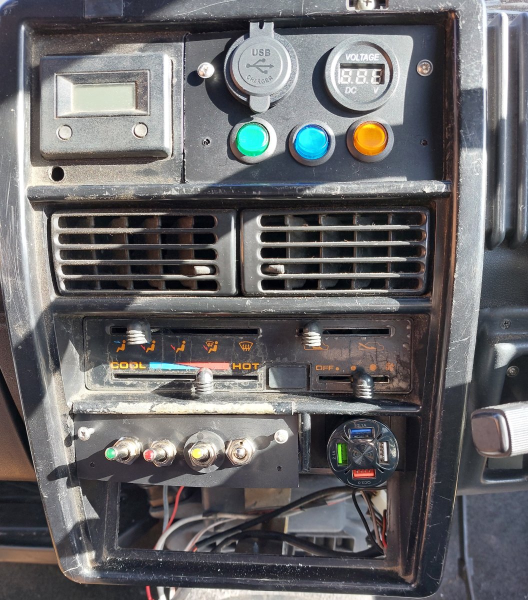

Interior panels in place. radio/CD/MP3 player yet to go in.

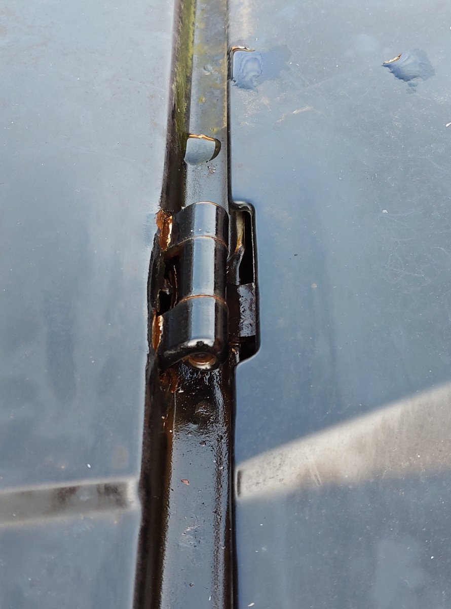

Sorting out bonnet hinges. All 4 No bolts loosen which is good news.

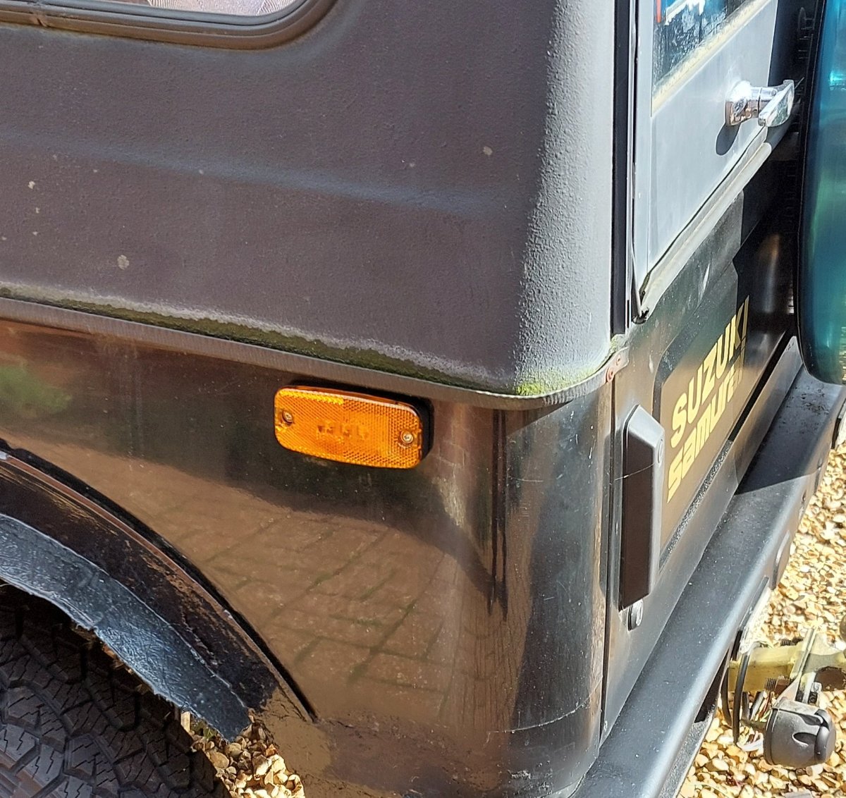

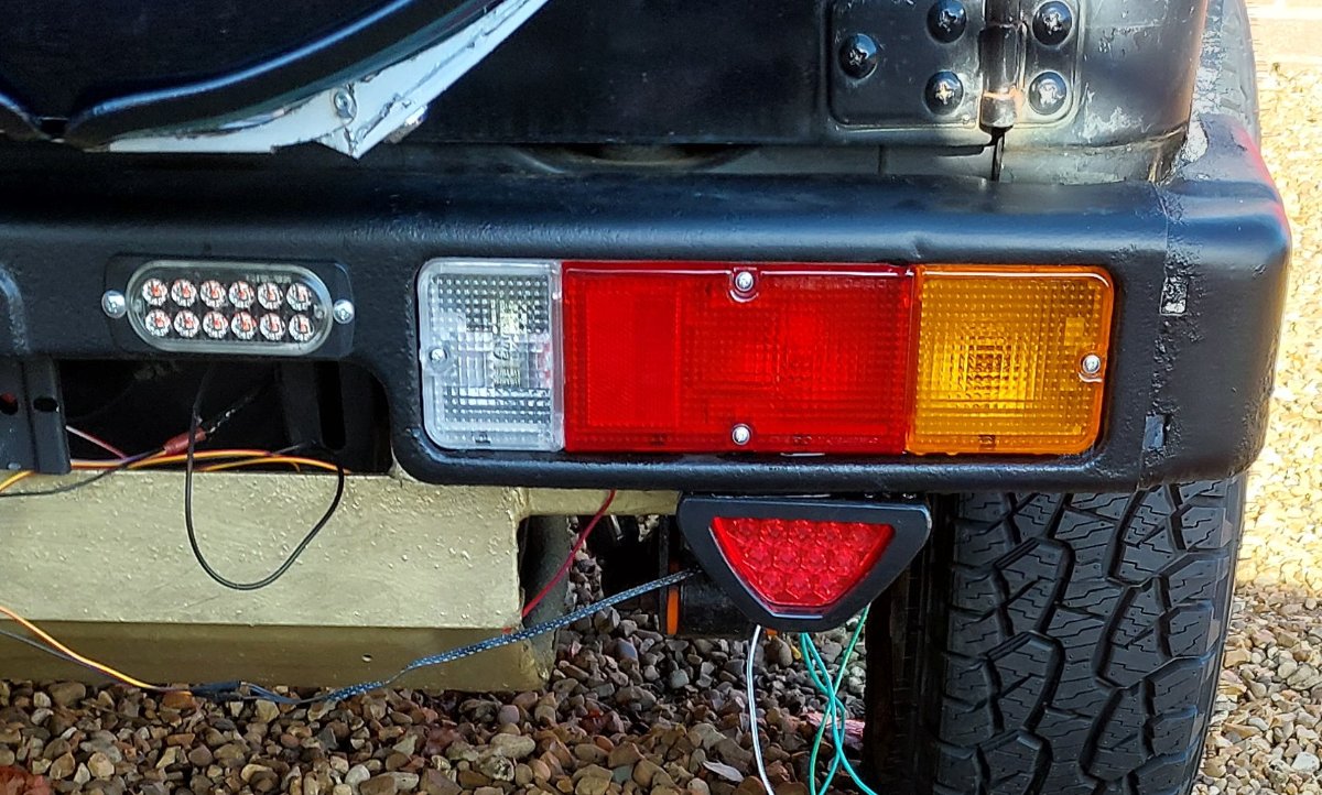

Adding some additional rear flasher lights.
tomcat
Posts: 236
Re: 1991 Santana Samurai

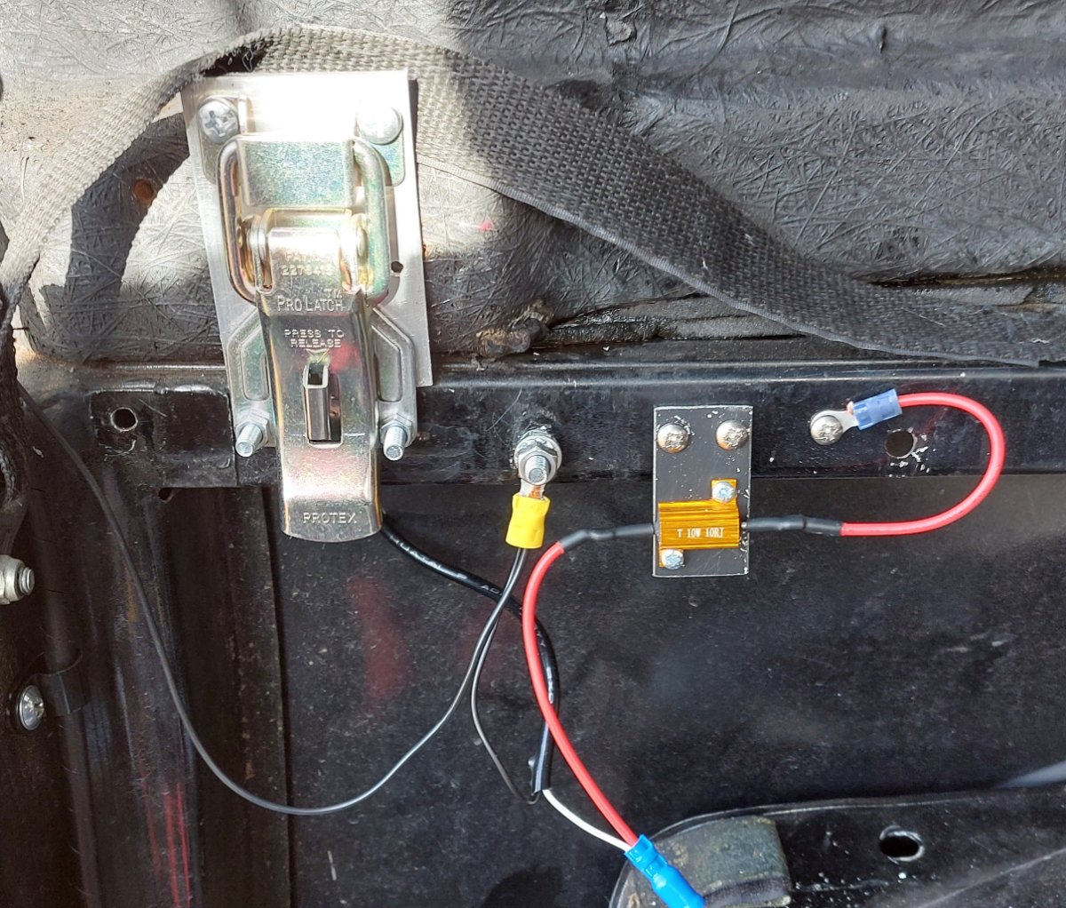

Post by tomcat » Thu Oct 17, 2024 10:27 am
As rear flasher lights were LED's needed to add in a resistor.
Area still needs tidying up but in position.

Rear Fog lights fitted.

Post by tomcat » Sat Oct 19, 2024 3:38 pm
Rear Fog Light set-up.
Slight tweaking needed!!
Just swap to a led flasher relay. There are under £10 on eBay. Just need to order one that is the correct polarity.
tomcat
Posts: 236
Post by tomcat » Tue Oct 22, 2024 9:56 am
[/quote]
[/quote]
All bulbs are non LED except for the 2 new rear side lamps. So I felt I only needed to add resistors to cover them. Is this not correct?
Posts: 340
Post by Rankine » Tue Oct 22, 2024 8:11 pm
When I only had led fronts I didn't bother with resistors. But when I went full led, I did as scottie suggested.
Posts: 11699
Post by ScottieJ » Wed Oct 23, 2024 12:51 pm
[/quote]
[/quote]
You don’t actually need the resistors if they are additional lights as you still have the resistance from the factory bulbs for the flasher relay to work correctly. They are only
needed if your are replacing any of the original indicators with leds.
However it’s just easier to swap to a led flasher relay anyway, these still work with normal bulbs, they just don’t need the resistance from the bulbs to set the flash speed.

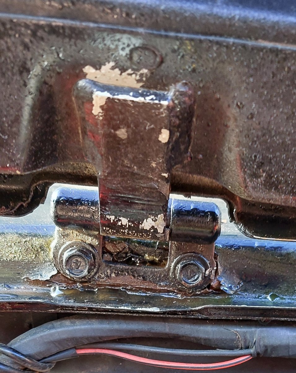

For all sorts of reasons work on "Sammy" has been very stop / start.
Got bonnet hinge area welded up and hinge itself free to move easily. Was well clogged up and took a lot of time to free-up properly.

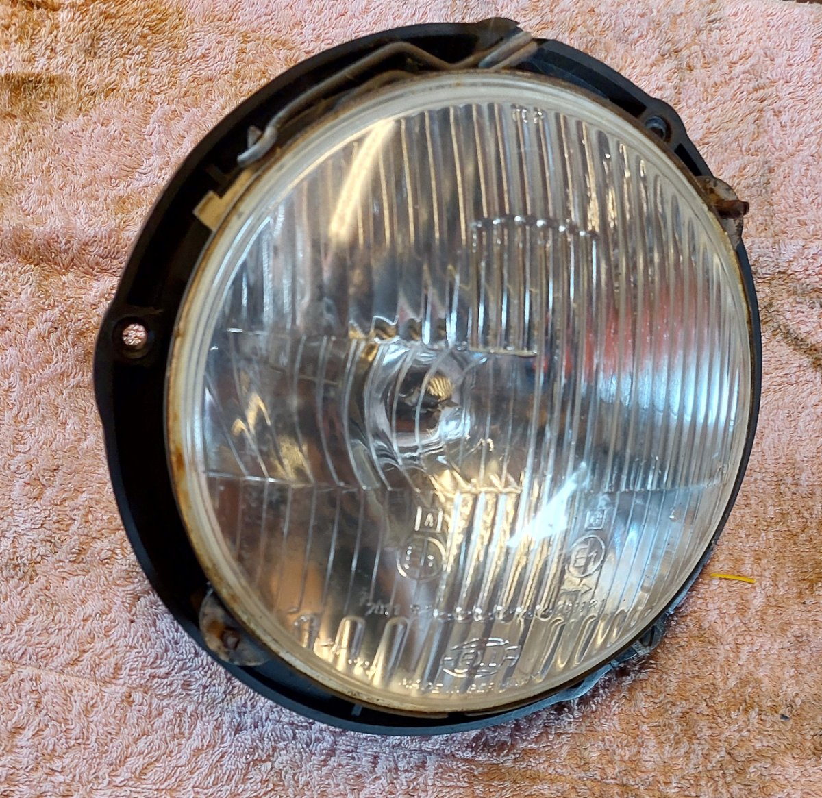

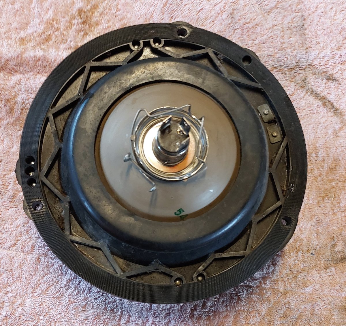

Looking at headllights as originals were 45/40 watt. Plan on 60/55 w H4. Looked at a way of inserting a H4 bulb into the existing casing. Seemed a no go.
