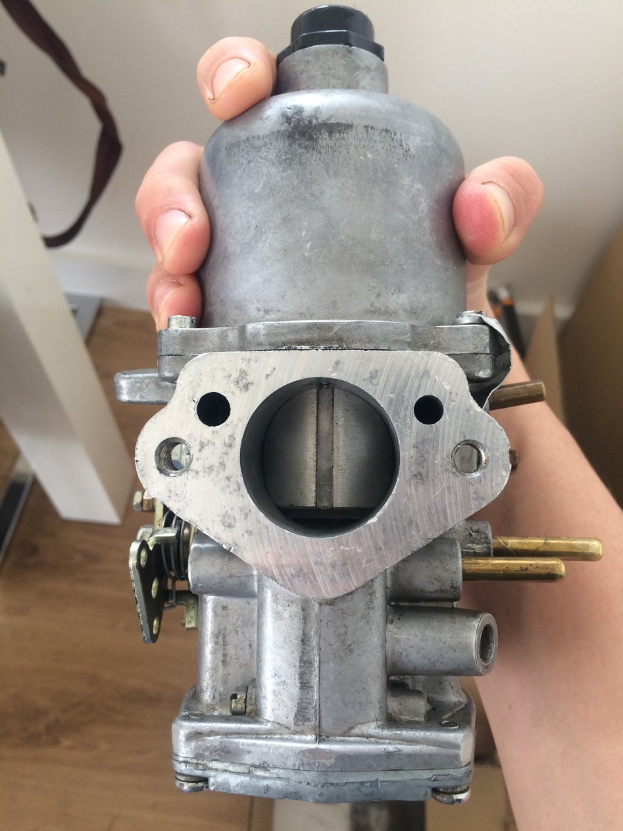

Hi guys

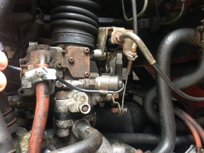

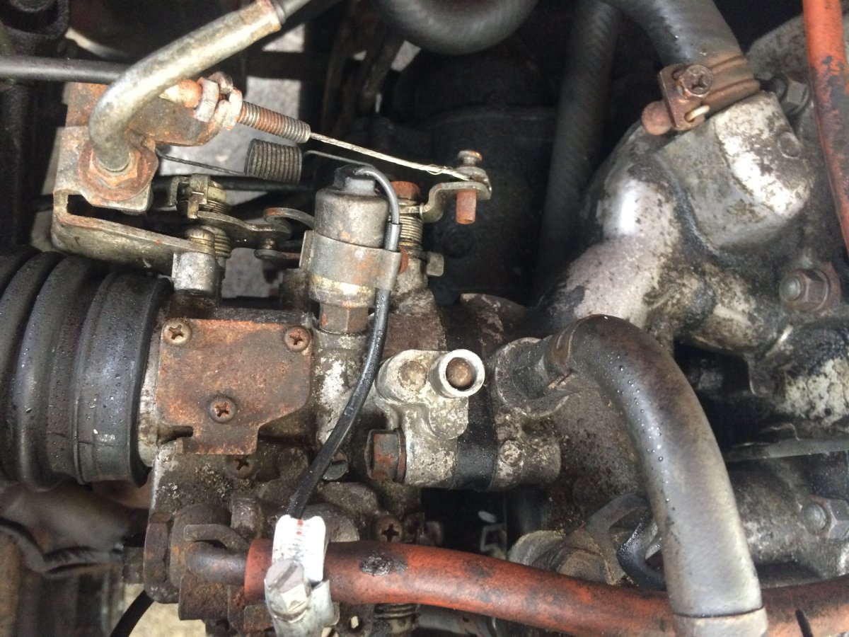

A bit of a novice here but was wondering if someone could assure me i got the right SU to bolt up to my SJ410.
The garage insists I'm missing parts for it to make it a direct fit to the mani? Its a Hif38 (fzx 1414).
Do i need a mounting bracket ? Seems like the bolts where the current carb is bolted to the mani are not diametrically
opposed to each other like they are on the SU, could be a slight of eye though. Any thoughts?

That looks like a HIF44 or bigger.
You need a HIF38 for the f10 engine. personally though I prefer the original aisin carb. if they are looked after, cleaned well and set uop properly they are awesome carbs.

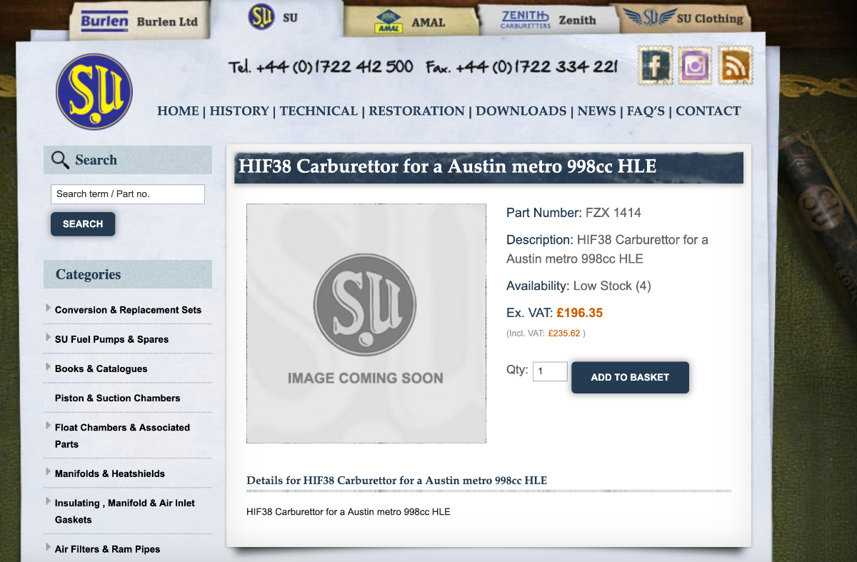

Ah, strange.
Per the part number tag on the SU i have it matches a hif38 for a metro on the SU catalog website
Could there be a different model that is a direct fit for the F10A?

sorry I was a bit tired last night....was a long day in the workshop.... your picture is of the air filter side, not the side that bolts up to the inlet
The side that bolts onto the inlet should have 4 bolt holes and you just use 2 to bolt it up to the inlet manifold.
You do need to do a bit of port matching on the inlet and open up/oval the bolt holes slightly.

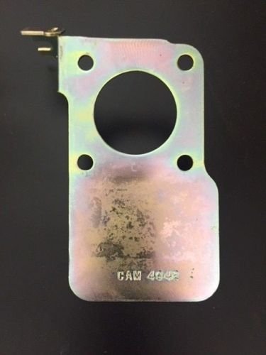

Thanks gents, much appreciated. One last one, just wanna make sure this is nearly foolproof
I saw this plate for rigging the throttle linkage but how did you guys do the choke?

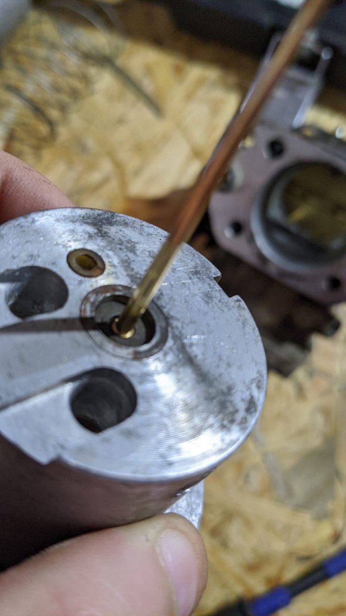

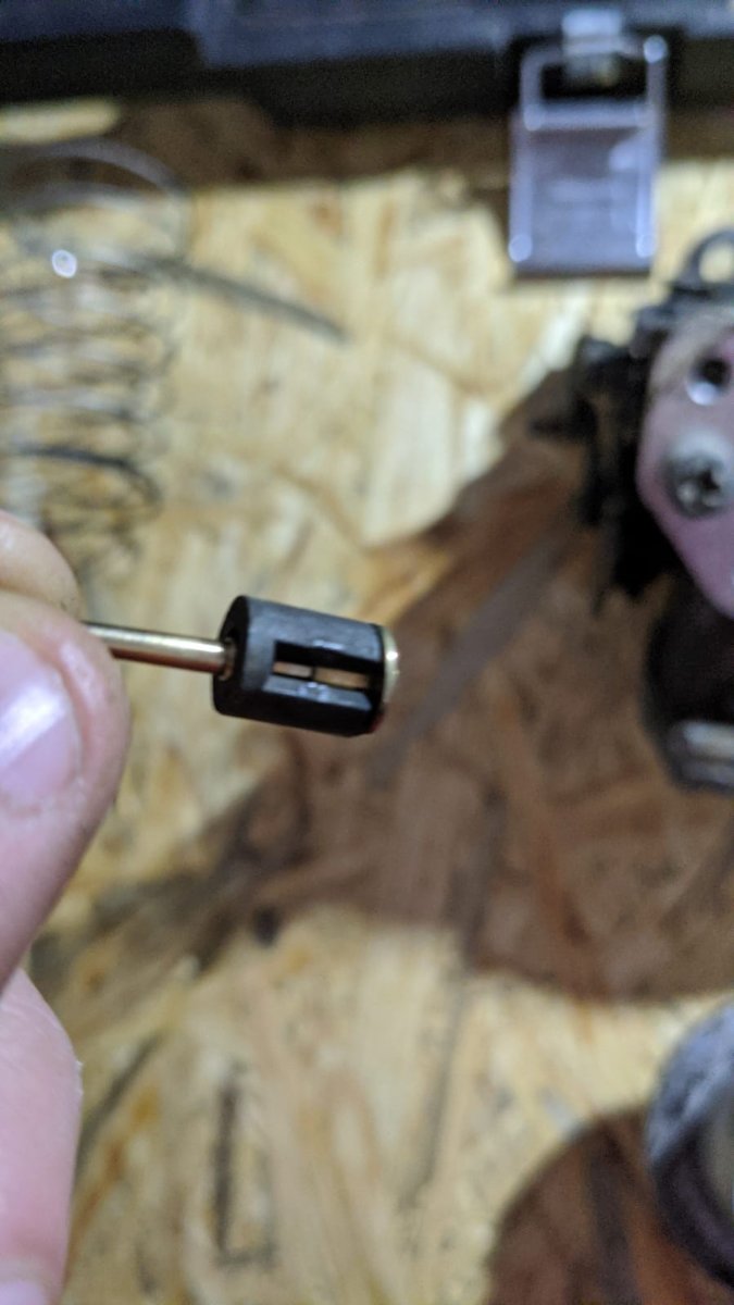

Needle question, where should this black retainer sit in relation to the damper, should it be recessed, flush, or proud? There is only a groove not a specfic locating point for setting the height, so I can set it wherever, just need to know what the 'wherever' should be.
