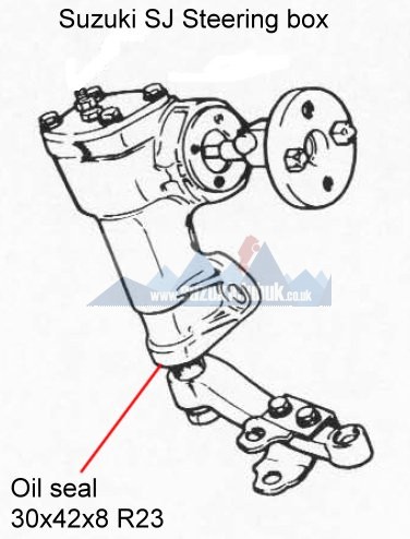

ScottieJ wrote: So far only found a size for the lower seal
Stock is 30x42x8 but a easily a available 30x42x6 should work fine
I'm sure the input seal will be easy to get a replacement for as well, I hope so as mines leaking on my power steering :lol:
Thank's for that :thumbup: , I tried to get the number off mine but couldn't read it. It did look like an R23 seal though, So guess what.....................................
Steering box seal.jpg (40.45 KiB) Viewed 5939 times

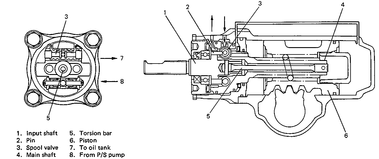

ScottieJ wrote: I'm sure the input seal will be easy to get a replacement for as well, I hope so as mines leaking on my power steering :lol:
If you have vit power steering it looks a nightmare!! :thumbdown:
Vit ps.jpg (169.77 KiB) Viewed 5930 times

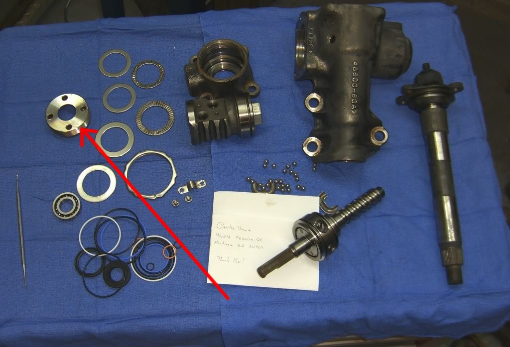

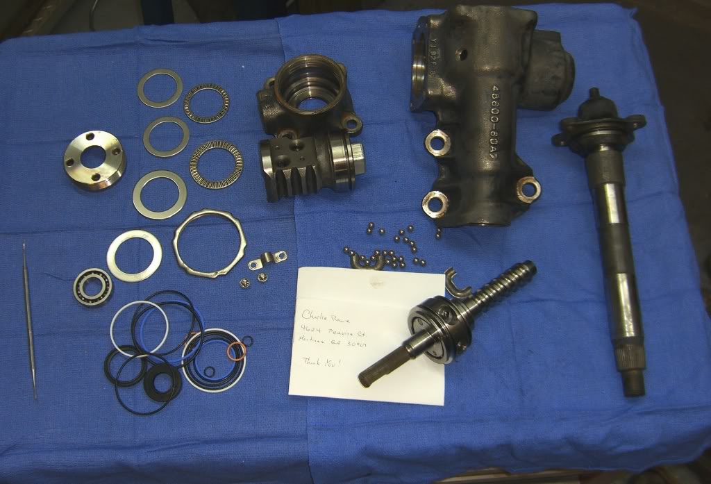

Post by Darrell » Tue Jan 22, 2013 11:07 pm
Or does this unscrew and have the oil seal pressed into it?????
Sod the rest, look at all those balls :shock: :shock:

Post by ScottieJ » Tue Jan 22, 2013 11:26 pm
Doesn't look too bad :lol: apart from all the balls :shock:
Where did you find those pics Darrell? Was it a rebuild guide?
