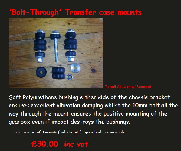

Re: Transfer box mounts
Post by Darrell » Mon Sep 16, 2013 5:27 pm
They look fine, just like what llama4x4 sells. :thumbup: I see they have compressed a little, so at least they have some give. I had visions of poly-bushes being too hard.
I would keep an eye on the nuts coming loose, but if they do just bung some nylocks on.
llama4x4 tranfer case mounts.jpg (94.31 KiB) Viewed 5998 times
