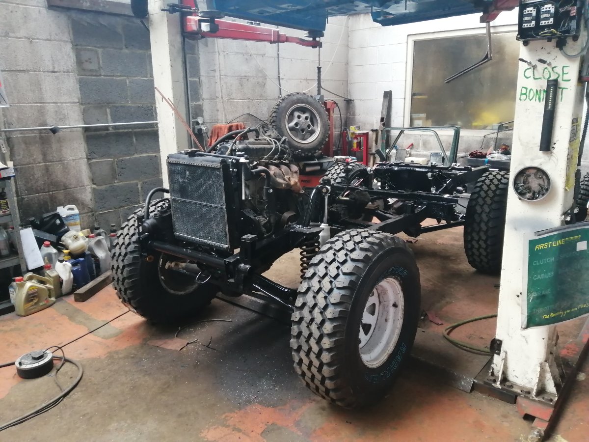

Post by d_r_1989 » Sat Oct 17, 2020 11:53 pm

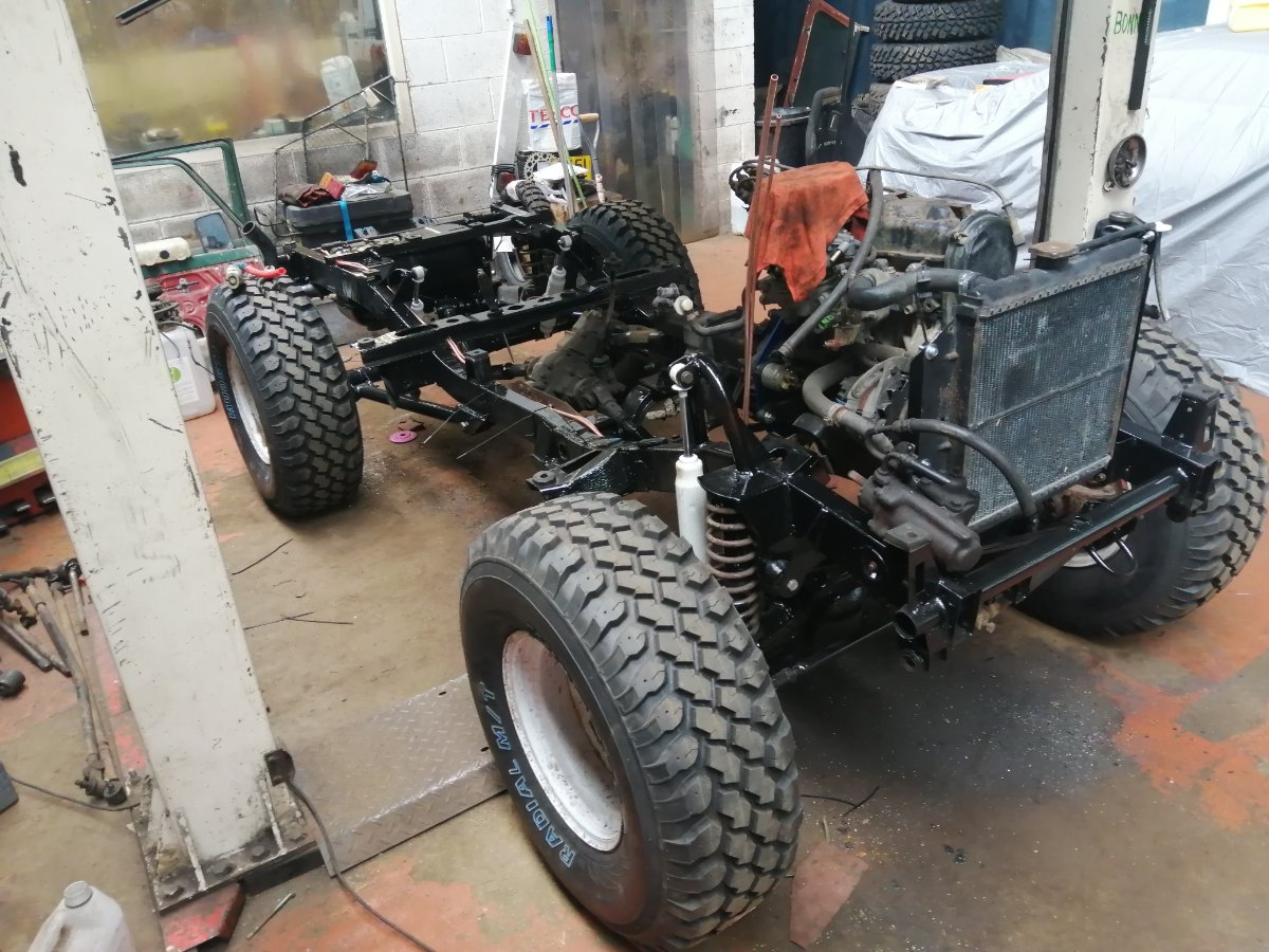

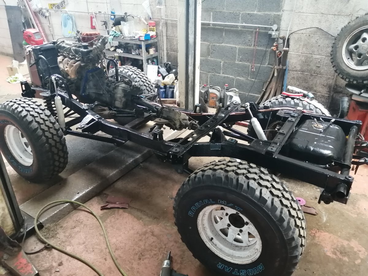

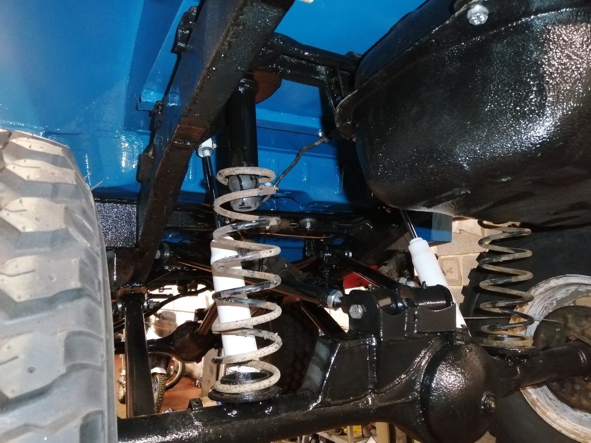

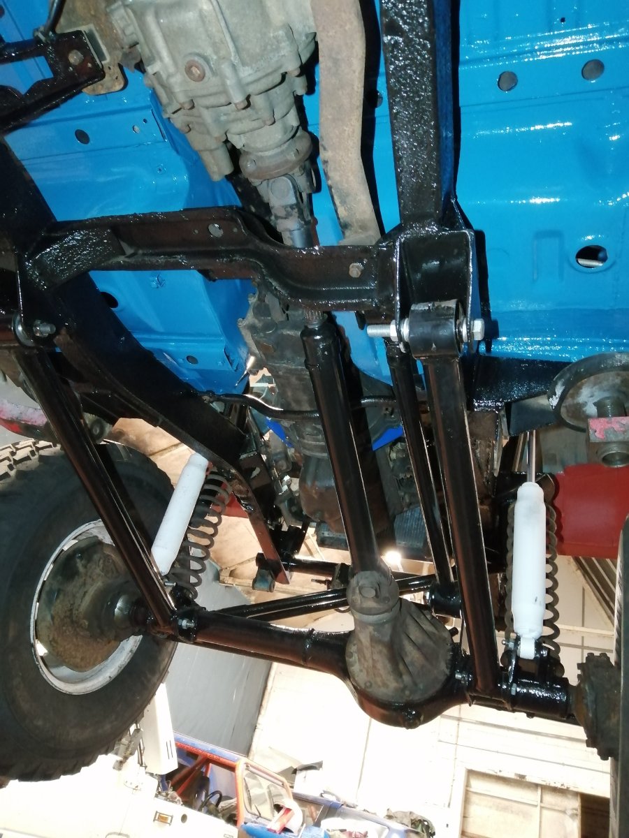

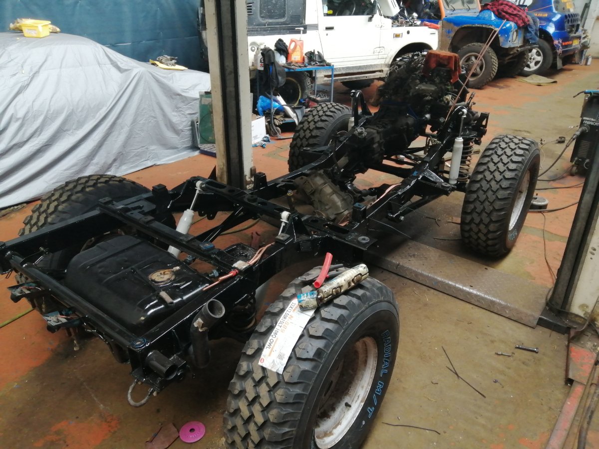

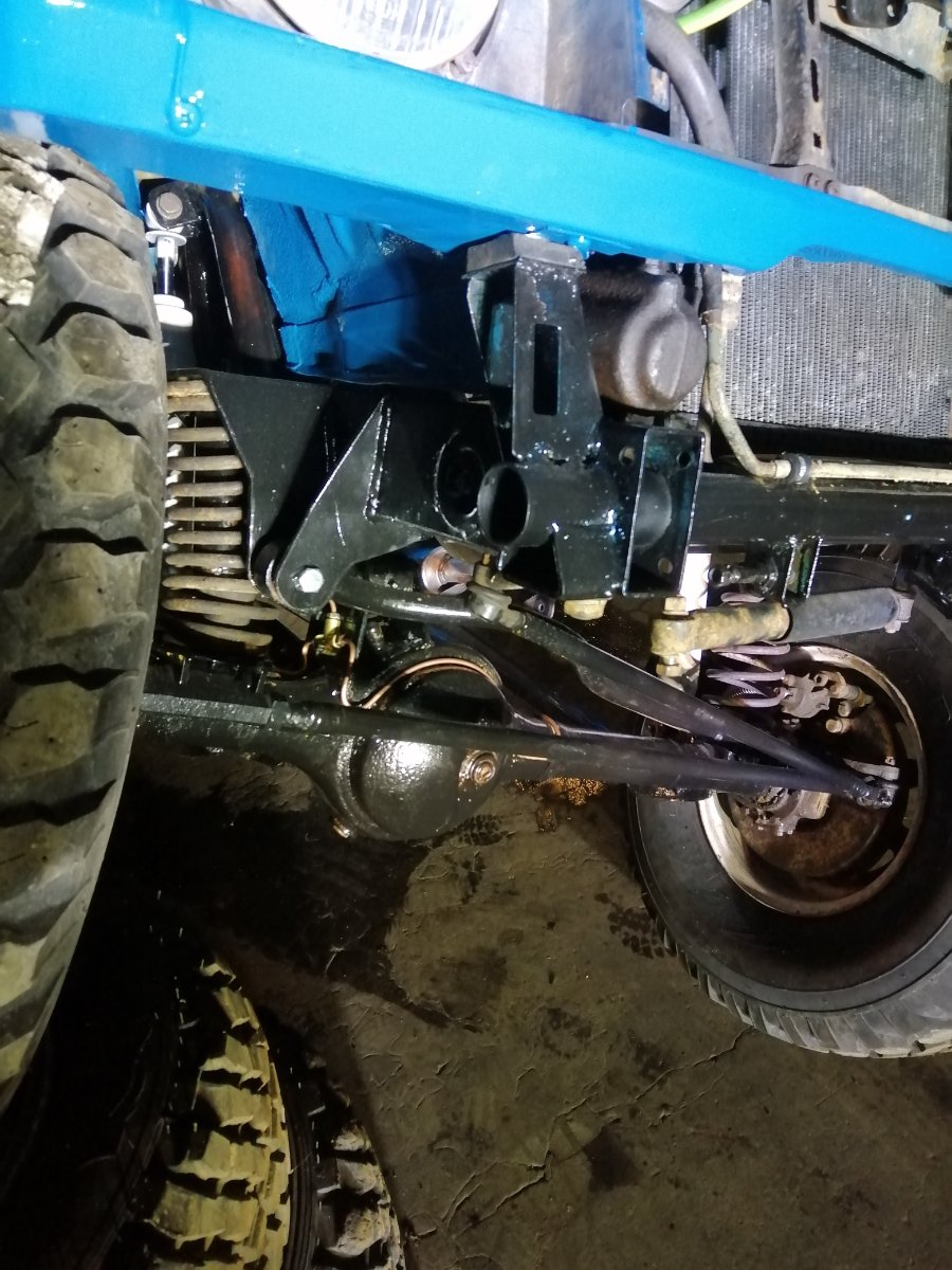

A bit of an update, chassis is now complete and iv bolted everything back on. Chassis and axles are painted in por 15. Had to make radiator mounts and notch the chassis for the power steering pump to allow adjustment. Made both propshafts now although not pictured. The underside of body is painted and should be bolted down for the final time by the end of next week. Then i can see about painting the body and getting it running.

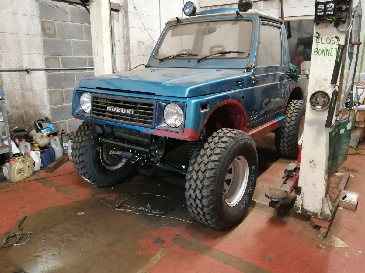

Post by d_r_1989 » Mon Oct 26, 2020 9:48 pm

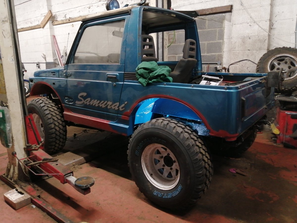

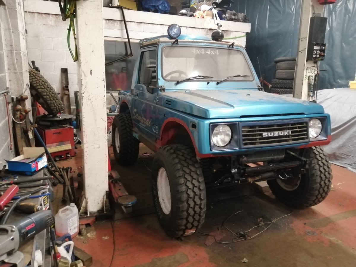

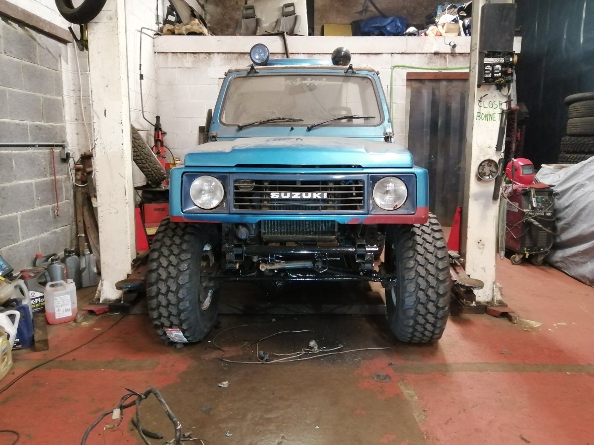

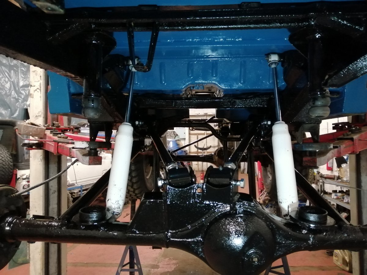

Few more pics now body is bolted on

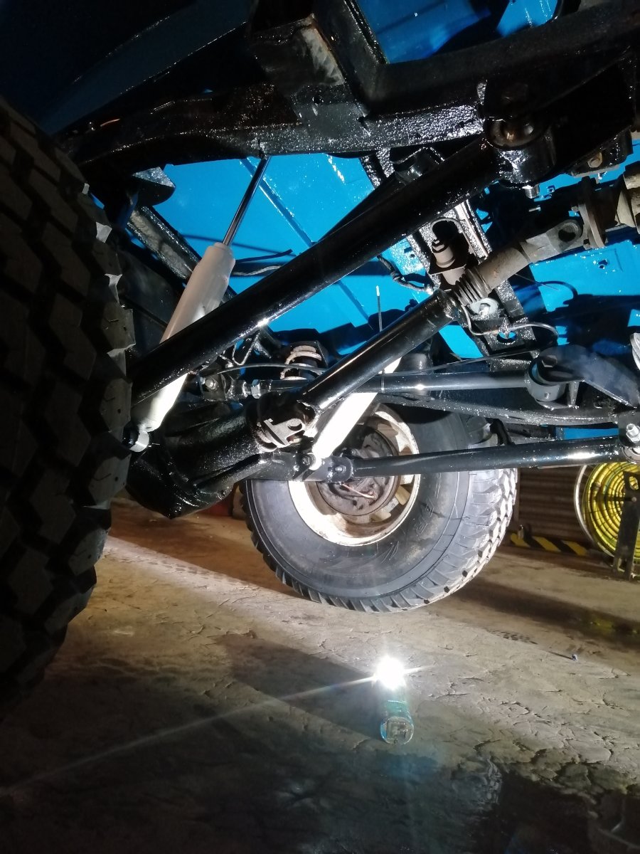

Post by d_r_1989 » Thu Oct 29, 2020 8:47 pm

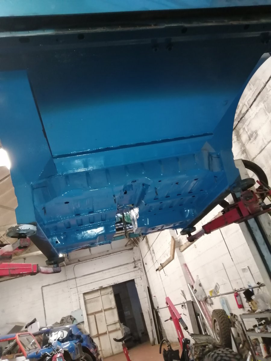

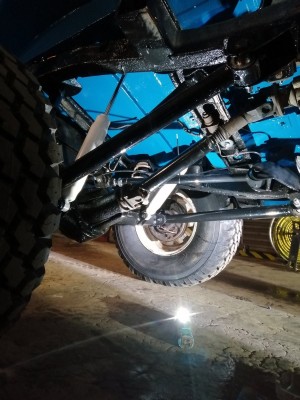

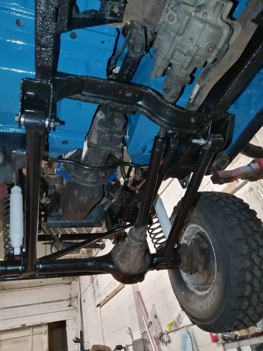

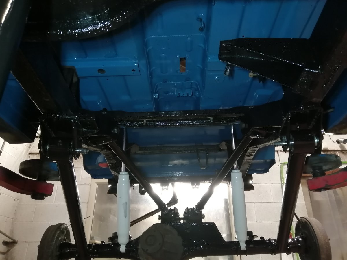

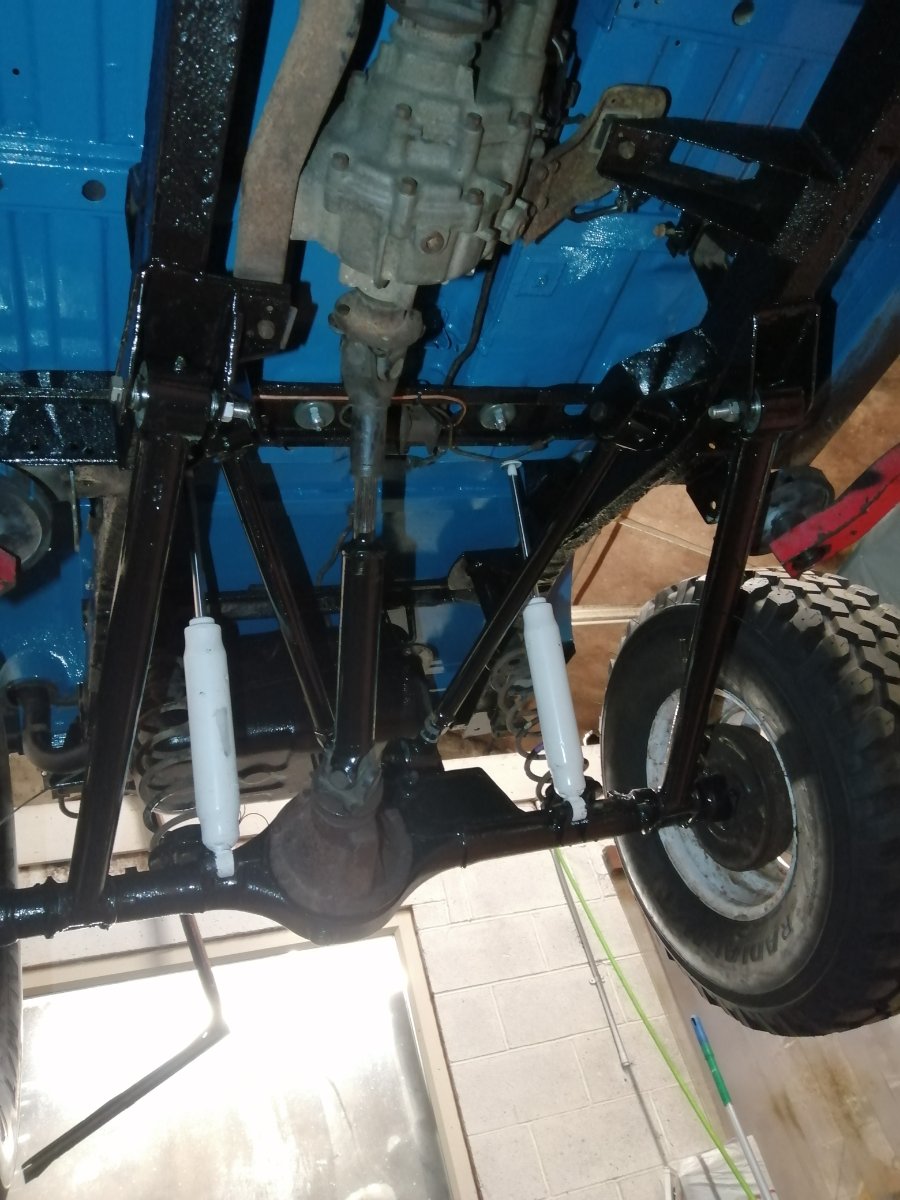

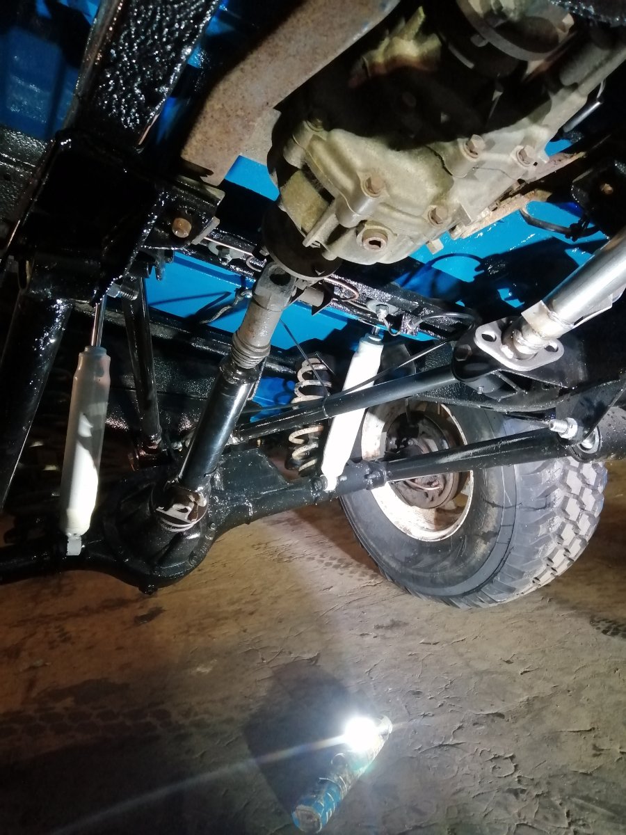

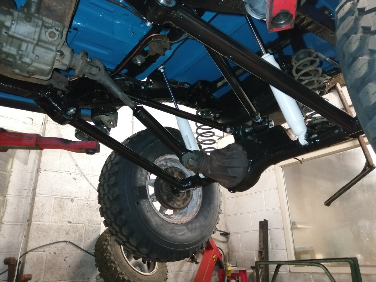

Few underside pics. Aiming to get it running in the next week or so. Then body can be painted and everything back together. Still have the diffs to swap and an exhaust to make.

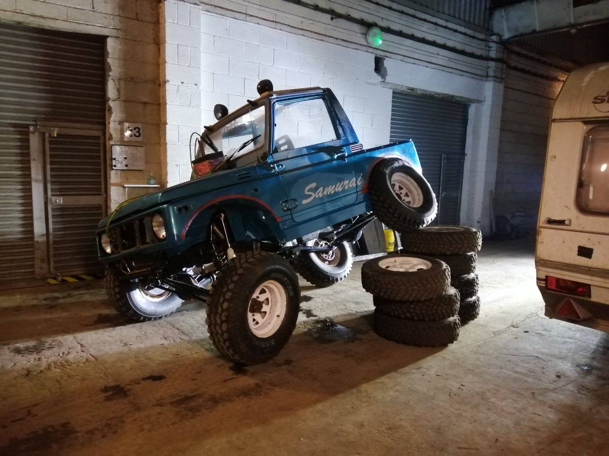

Post by d_r_1989 » Wed Dec 02, 2020 12:12 am

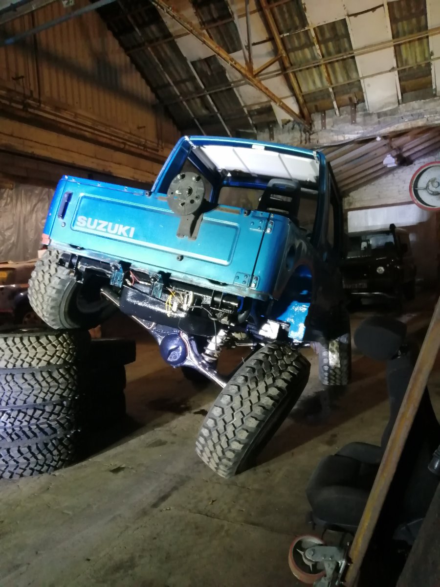

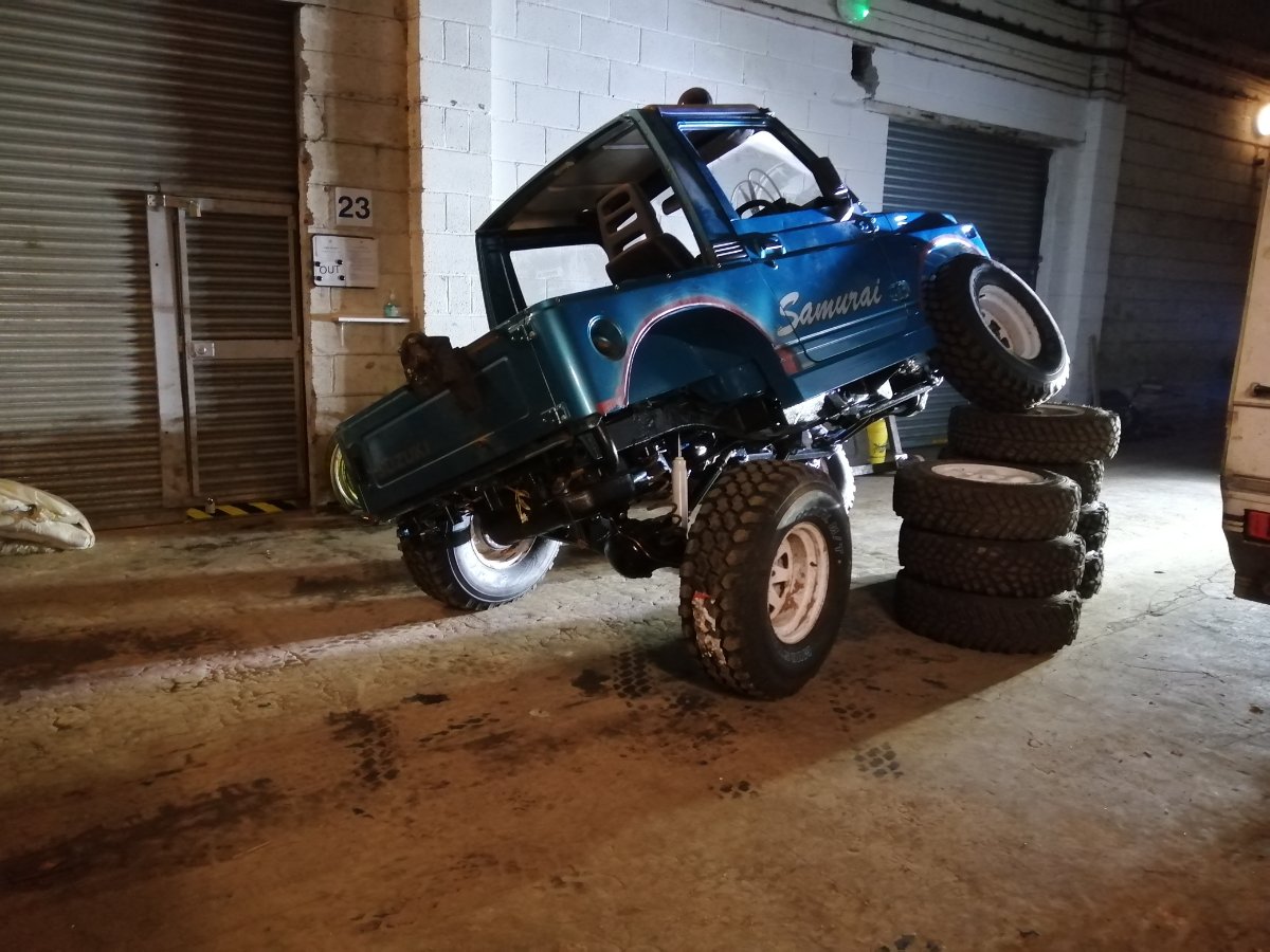

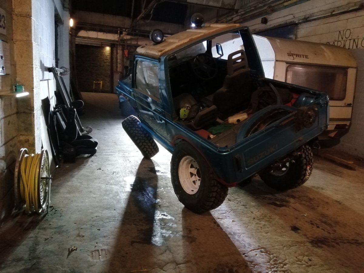

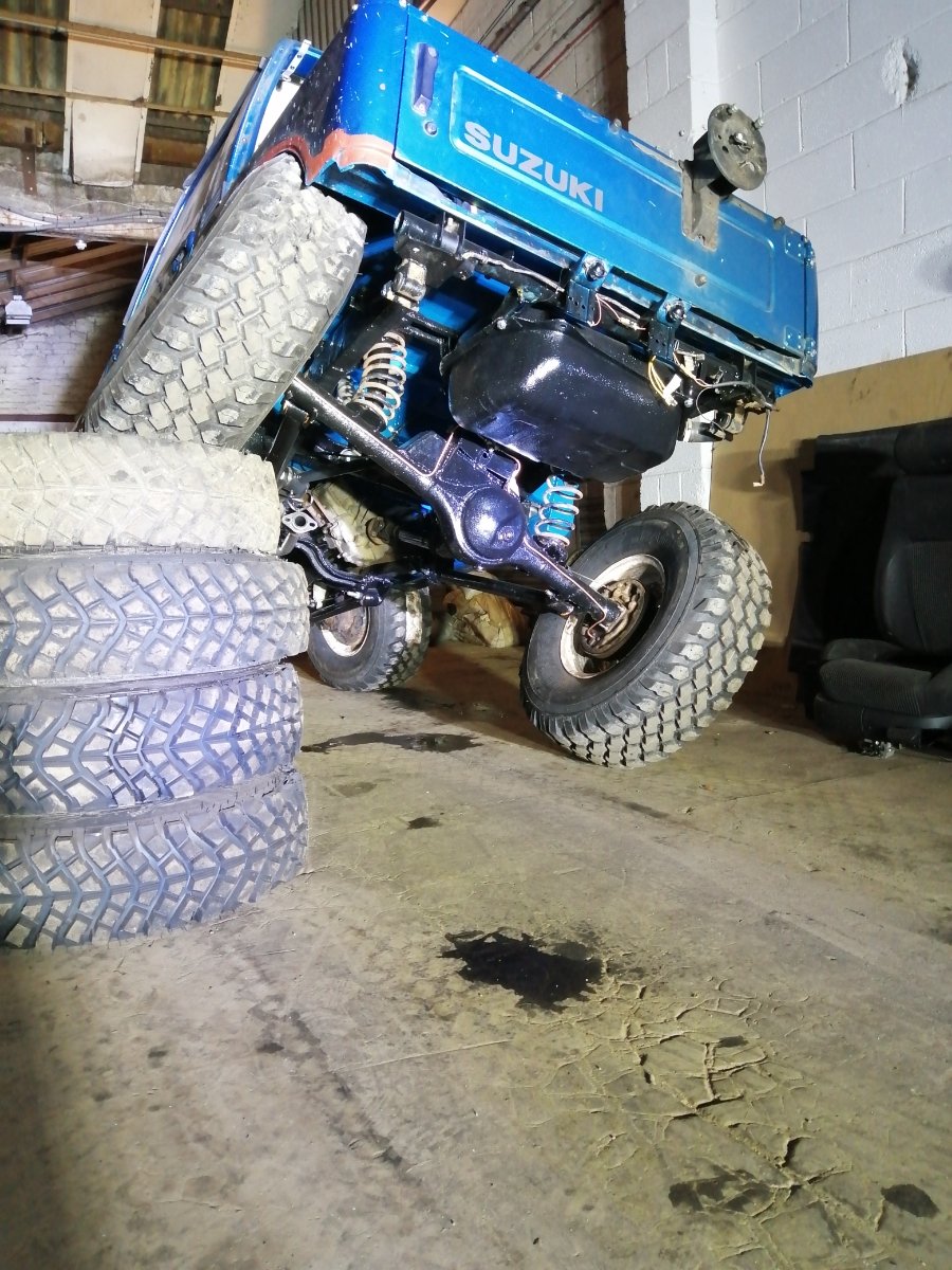

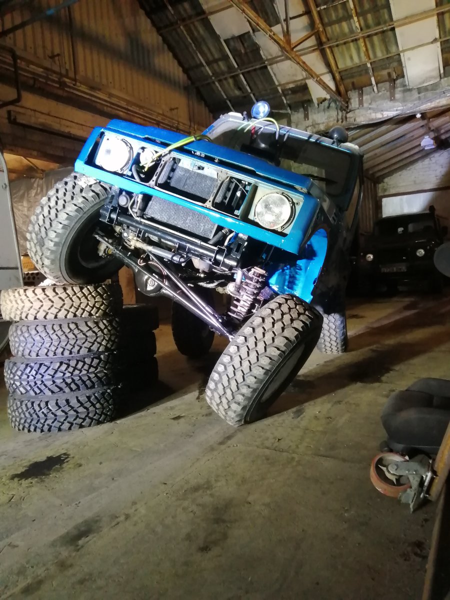

Been slacking with progress but had a fee nights this last week. Body is finally all bolted on, she runs and drives though brakes require more attention. Been having abit of a mess about to see what it can do, all 4 wheels have contact with one 33" in the air, pretty impressed for such a short wheelbase.

:smokin: Looks like that virtual lift has been cut to perfection!
Great looking truck!
