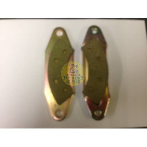

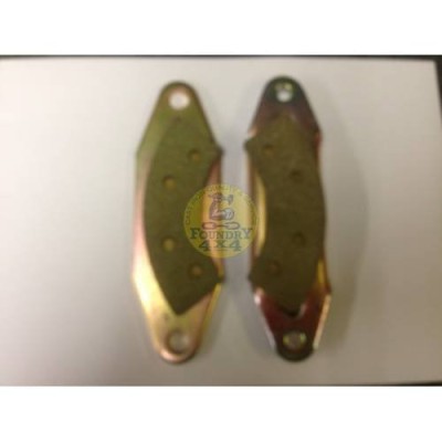

Ordered new pads for the X-Eng handbrake.

Just a word of warning, those X-eng handbrakes are a nightmare to get set up right, then when you get it right it gets dirty and eats the pads in a few weeks. They also rattle horribly while you are driving along.
I spent quite a few years with one fitted. I modified it loads to get it to work well, not rattle and not eat pads. Then bent the disc offroad so scrapped it and went back to a tbox drum brake set up, a decision I’ve never regretted.

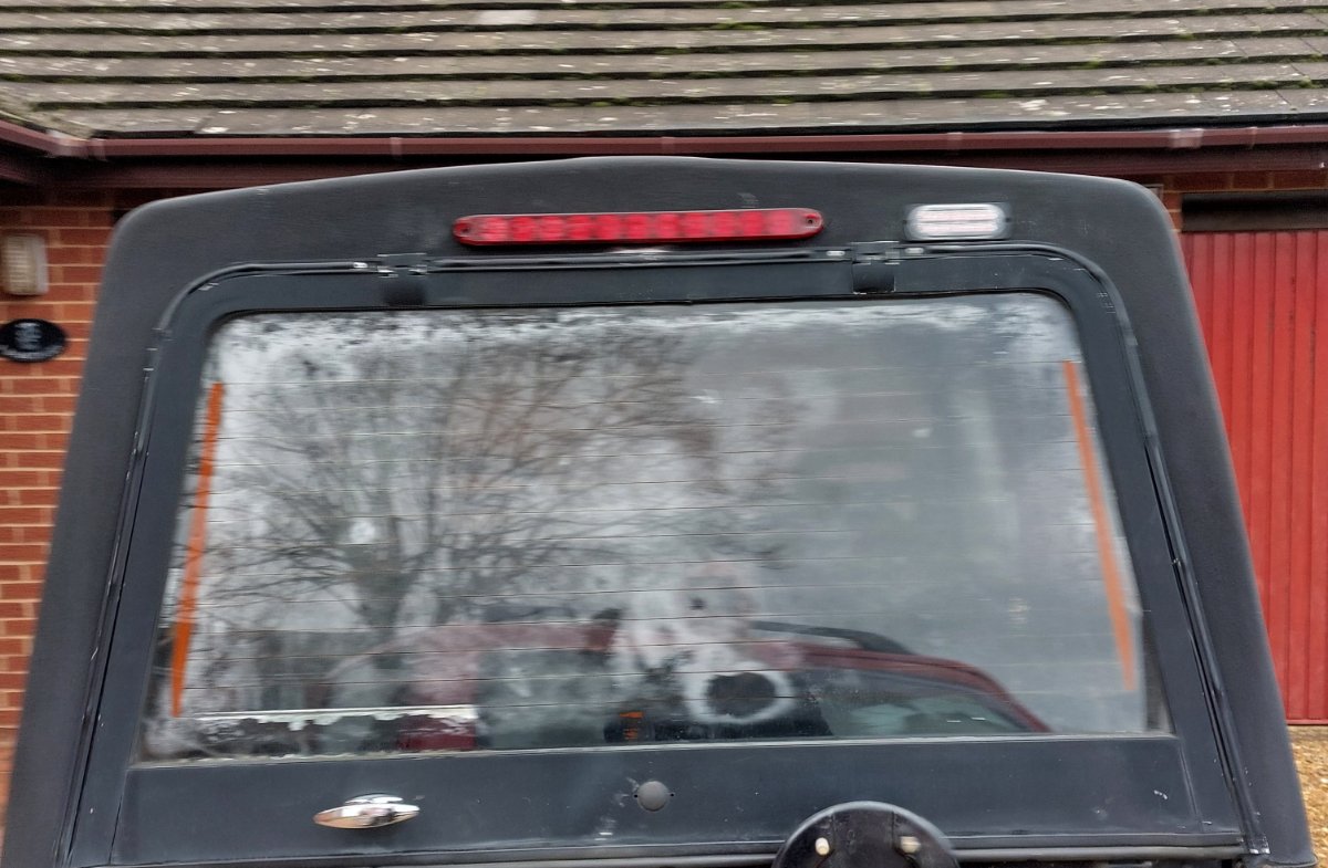

Before the rain started again managed a little work on 'Sammy'.
Setting up the High Level brake light and the RH Rear Fog Lamp. LH Rear Fog to follow.

Have to change my idea for rear fog lights as they will exceed the maximum height of 1000mm from the ground.
Back to the drawing board!!

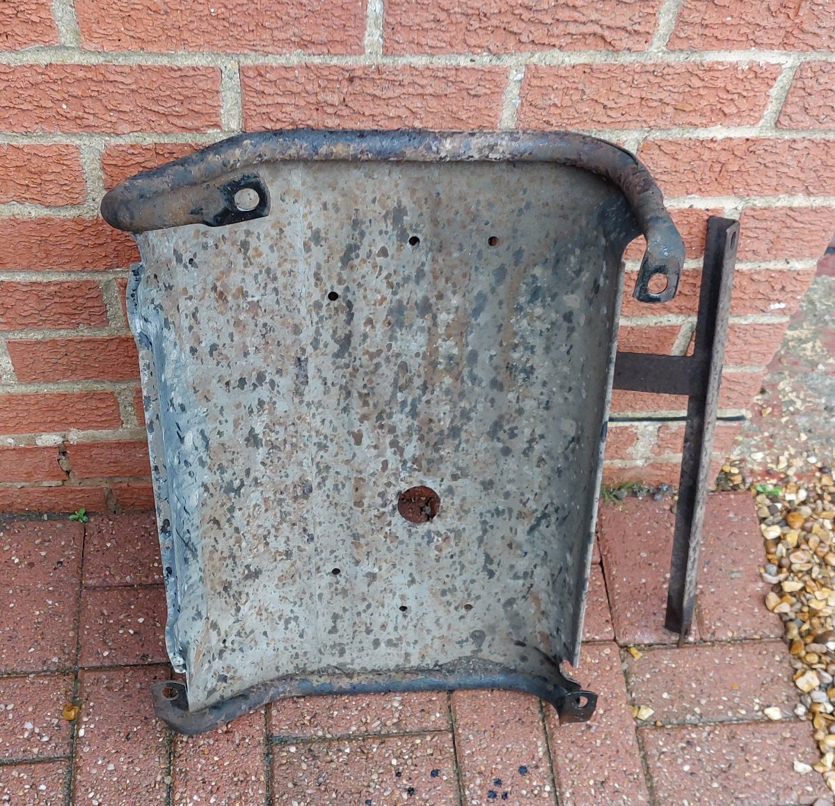

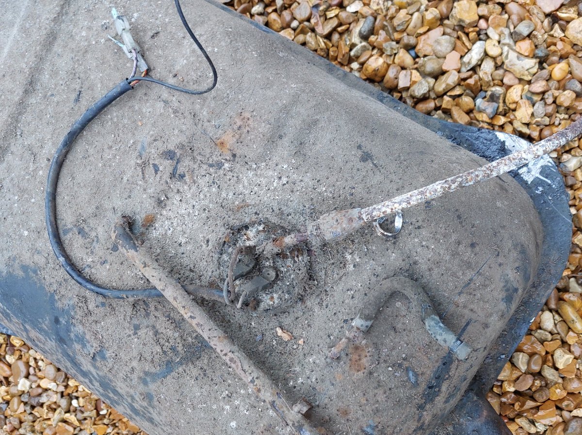

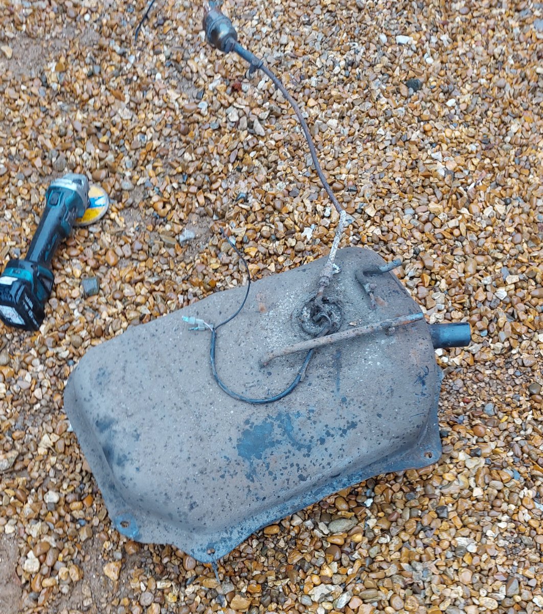

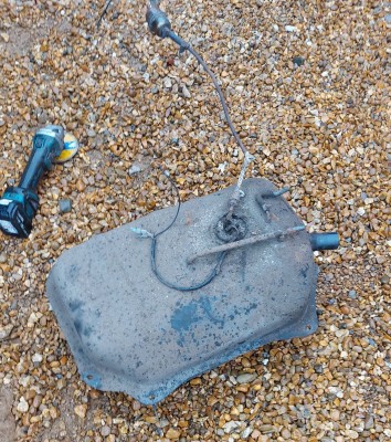

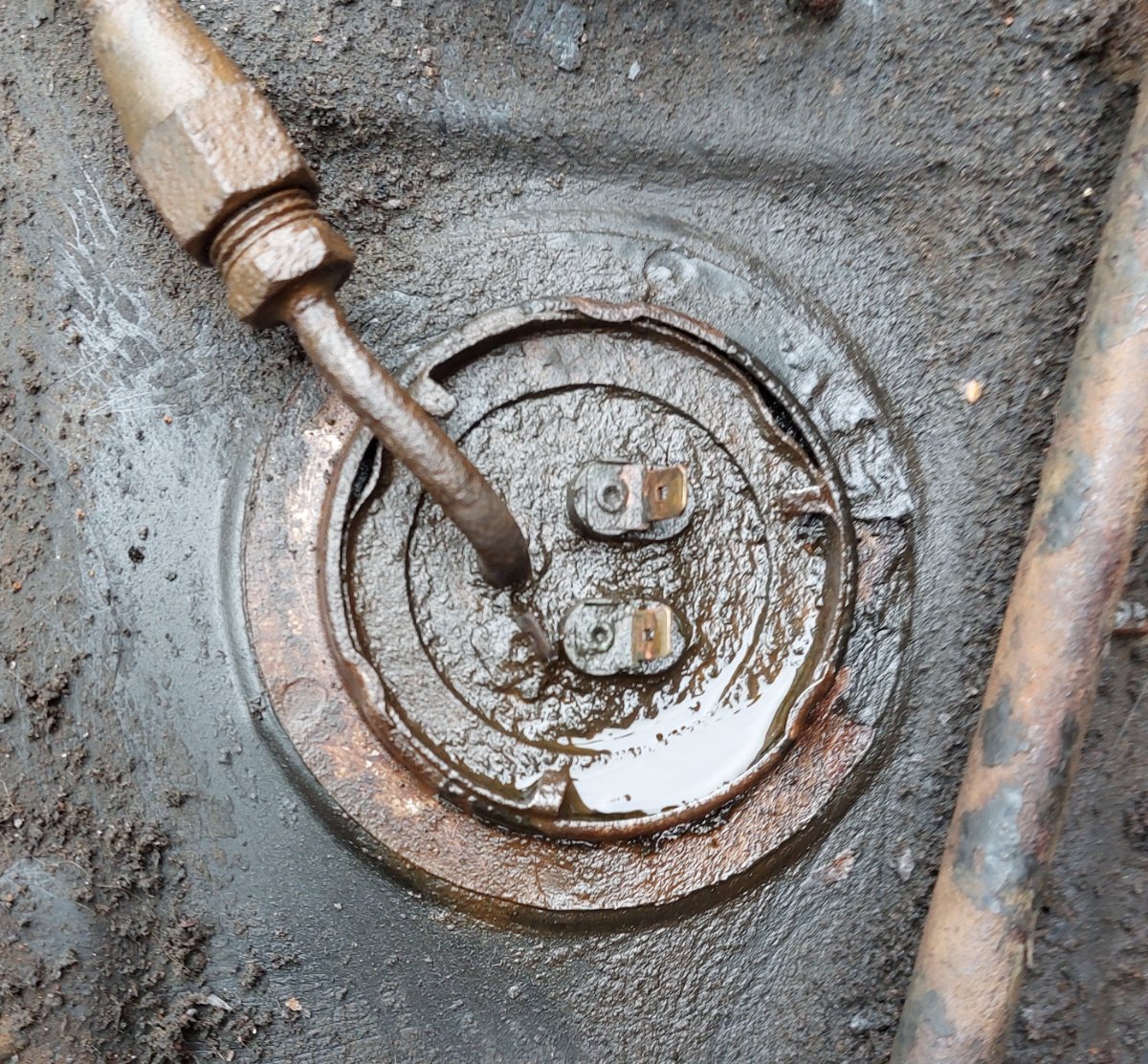

Decided to loosen off the fuel tank and guard. In the end stripped them out completely!! Captive nut was rotating with bolt on 1 corner to add to the fun. Also it started to rain again.
I think some very delicate work is going to be required to remove the fuel sender unit.

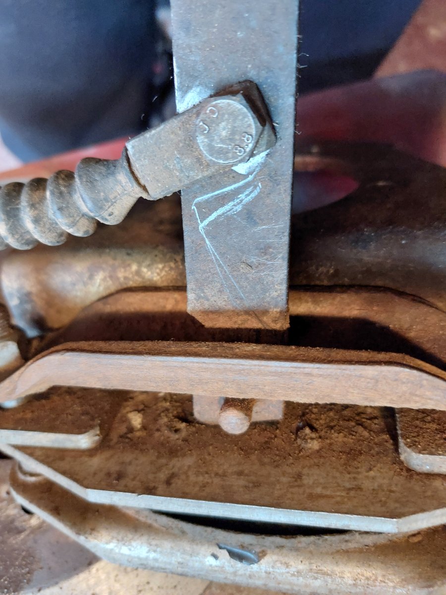

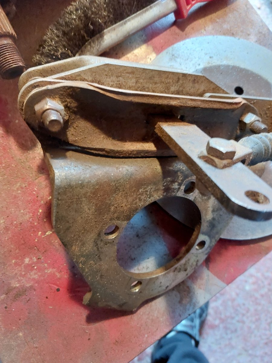

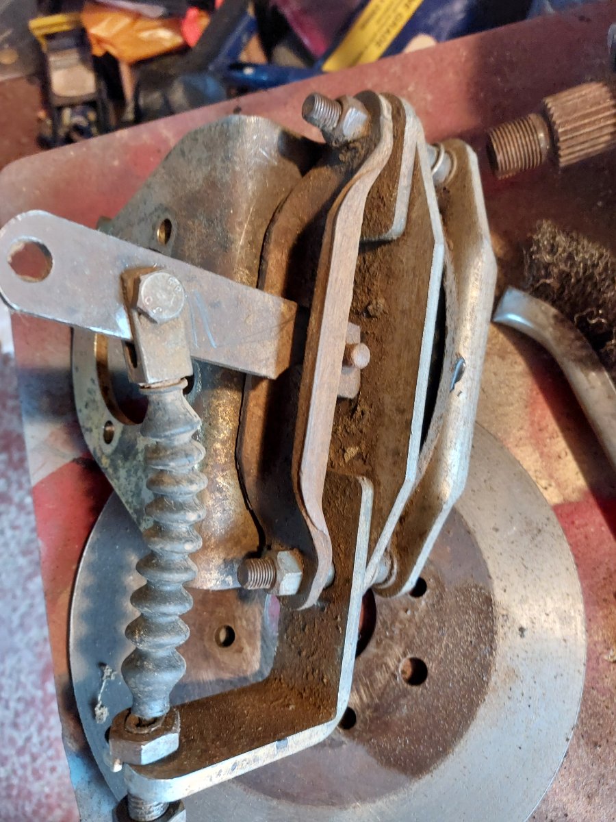

I am looking in great detail at potential "rattle" points on the X-Eng handbrake system
Certainly feels 'sloppY' around the cable and bar mechanism. See if this can be tightened without causing a problem in operation.
Perhaps ScottieJ could make some comment on this post?

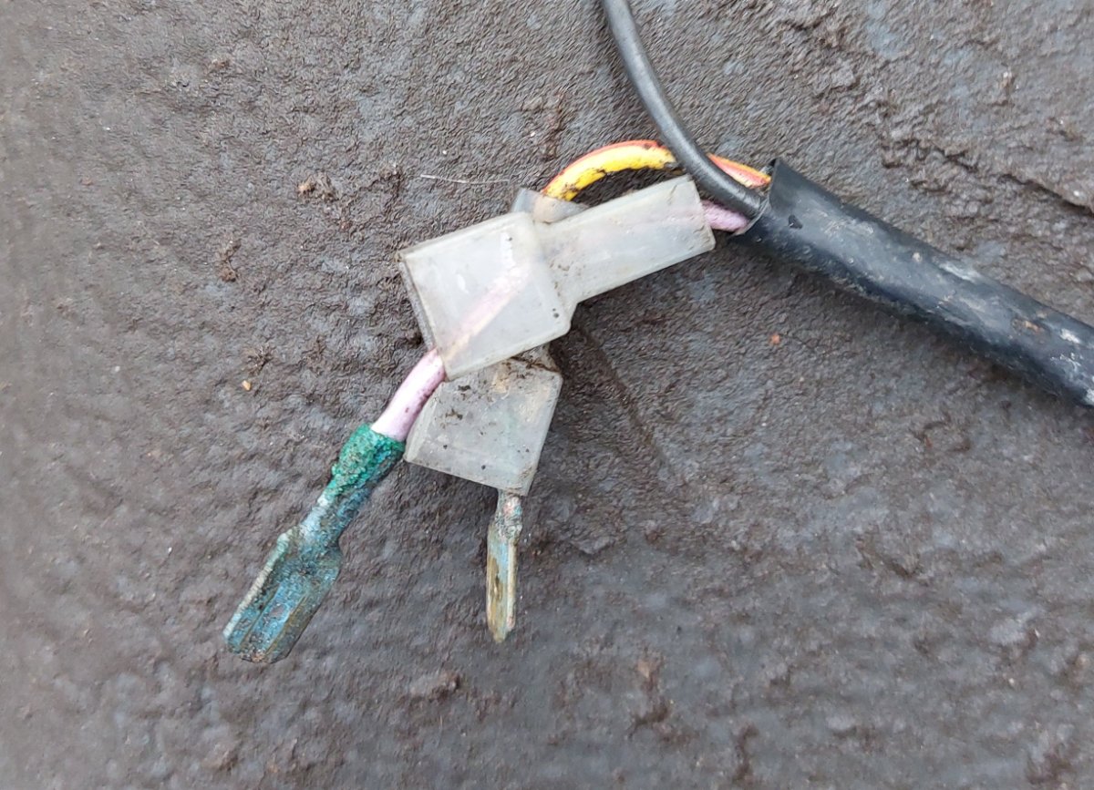

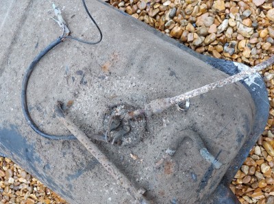

Did some work, between showers, cleaning up the fuel sender area.
Checking wiring colours and location on unit.

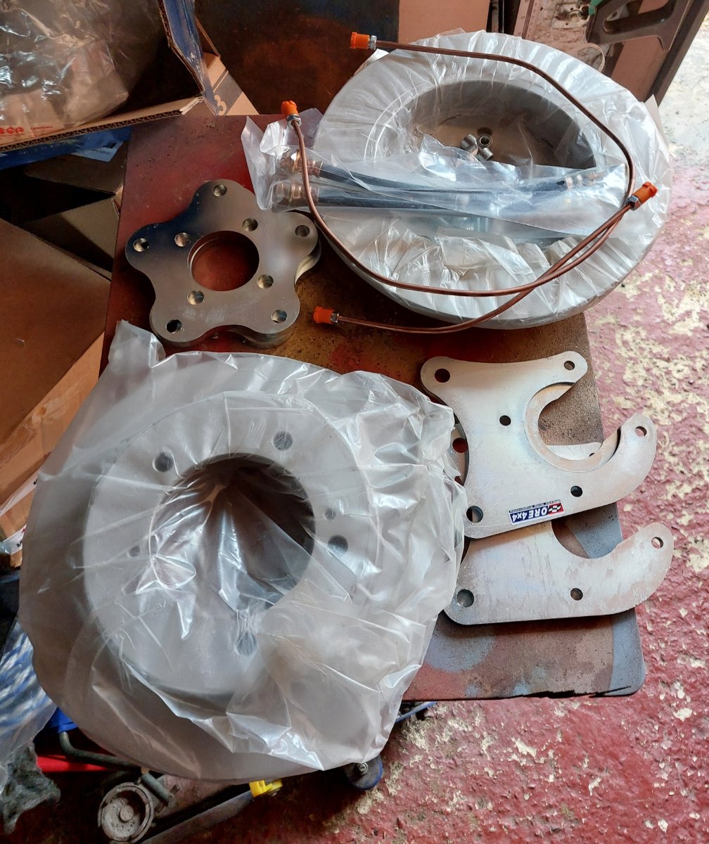

Rain permitting hope the rear disc conversion can commence tomorrow.
So packaging opened up to reveal some of the parts necessary.

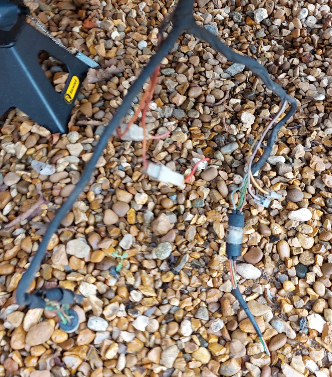

With the fuel tank out of the way I could access the rear wiring loom, remove the loose tape, plan for splicing in the trailer lights and high level brake light.
