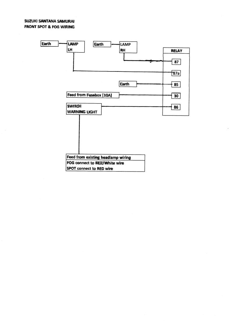

I am looking to add both front spots and fogs wired for "road" use.
Developed my own 'simple' logic diagram which is attached.
Any comments, corrections appreciated. Thank you.
