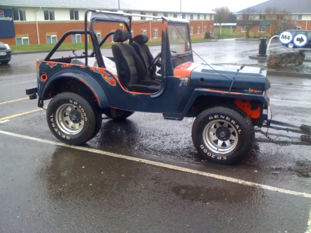

Few pages back u posted a pic from when we went to get those parts and matey was A-framing on the motorway with that ratty vento.
Re: trotters sammy build 1 step forward 3 back
Oh nooooooooooooo - A Frame

Quick update- 8hrs last weekend had the front clip off, engine out, inlet and exhaust manifolds, dizzy, starter, alternator, pulleys, clutch, flywheel and engine mounts swapped to new engine then refitted everything.. And bingo!! No more blue smoke
Cheers dan_2k couldn't have got it done so quick without your help.
New carb needle and spring turned up from burlen yesterday so just awaiting choke cable to arrive and i get to battle mr mot once more ;-)
