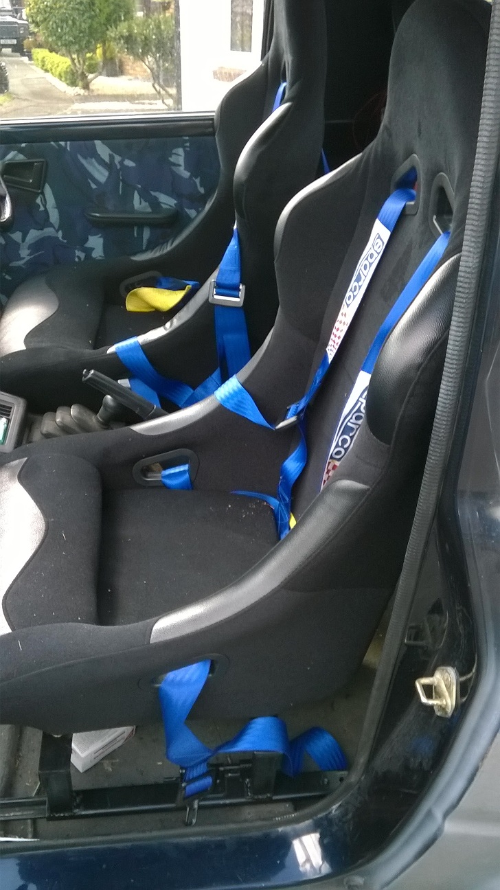

The new seats are finally in and attatched to the sliders too. And we gave up trying to fit the new arches..Stu came up with the tyre idea so I went to Merrits and they gave me some old Yokohamas, he cut them to size and welded some brackets in and they bolted straight on. Neat I think but they need a bit of trimming.

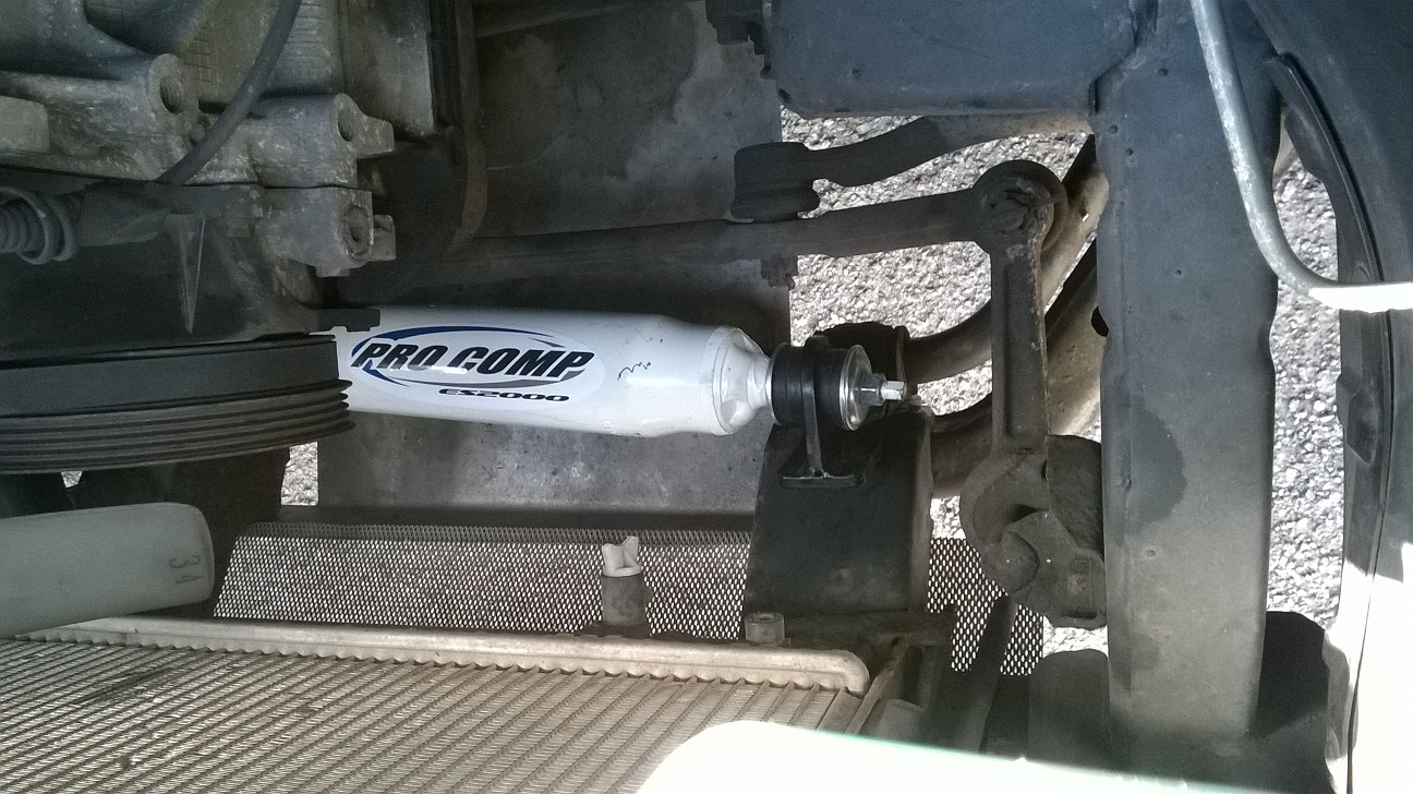

Post by donkeychomp » Sat May 09, 2015 9:36 pm

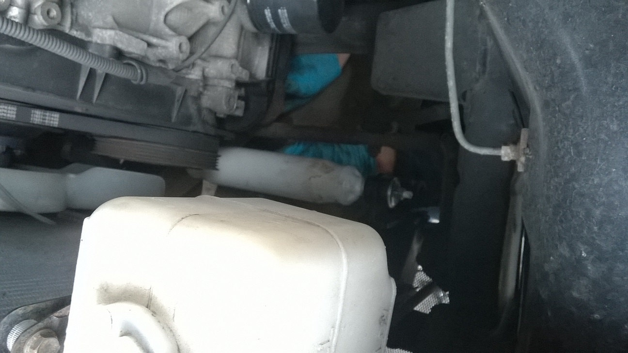

Much to my relief the steering damper is on. As with everything it didn't fit, I think it's more a 'universal' one than tailored for a Vitara. The U bolts didn't have enough thread on them so more was tapped on and some spacers needed making up. But what a difference it makes. OK so the steering is a little heavier but no wheel wobble at all.

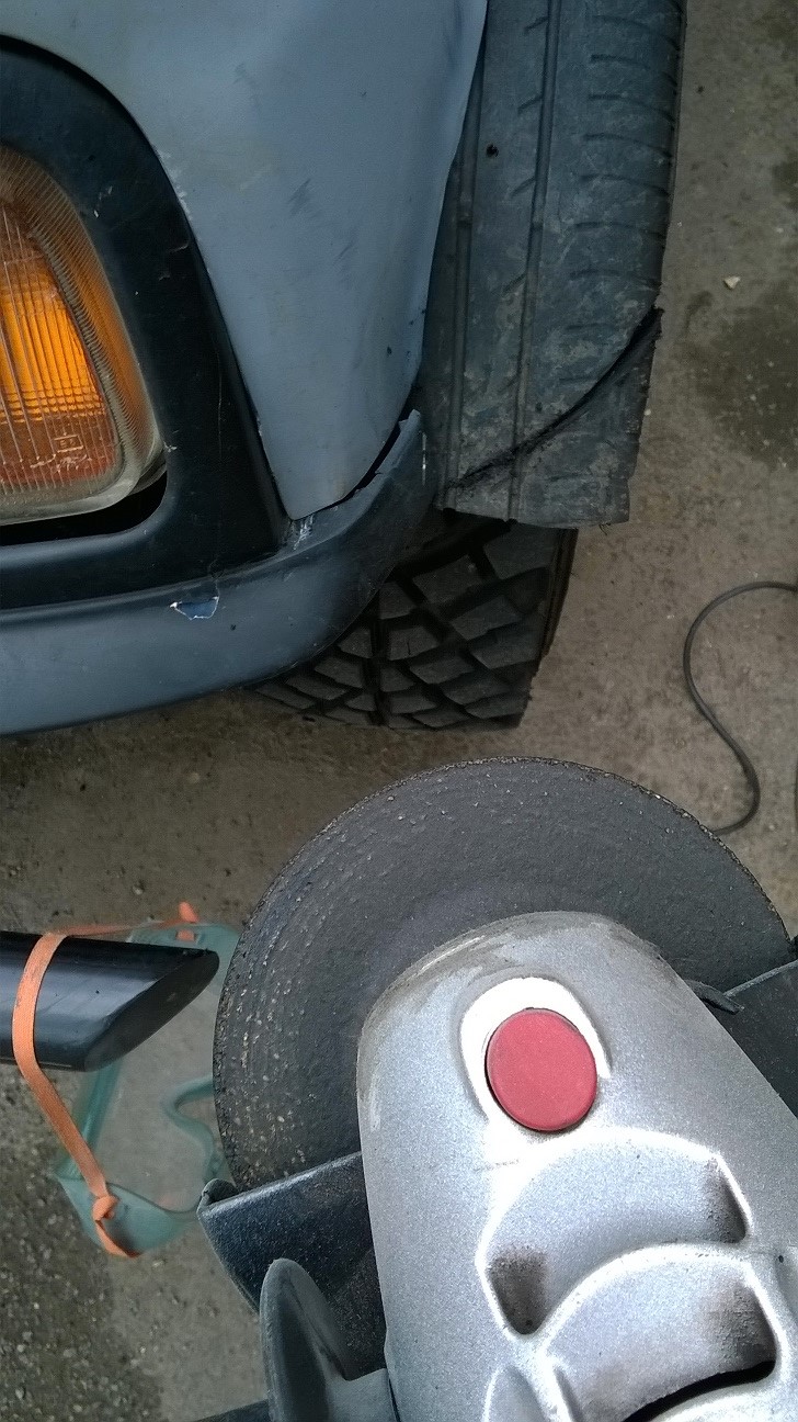

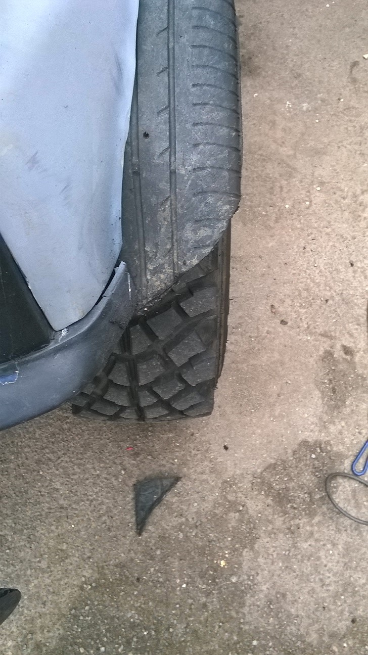

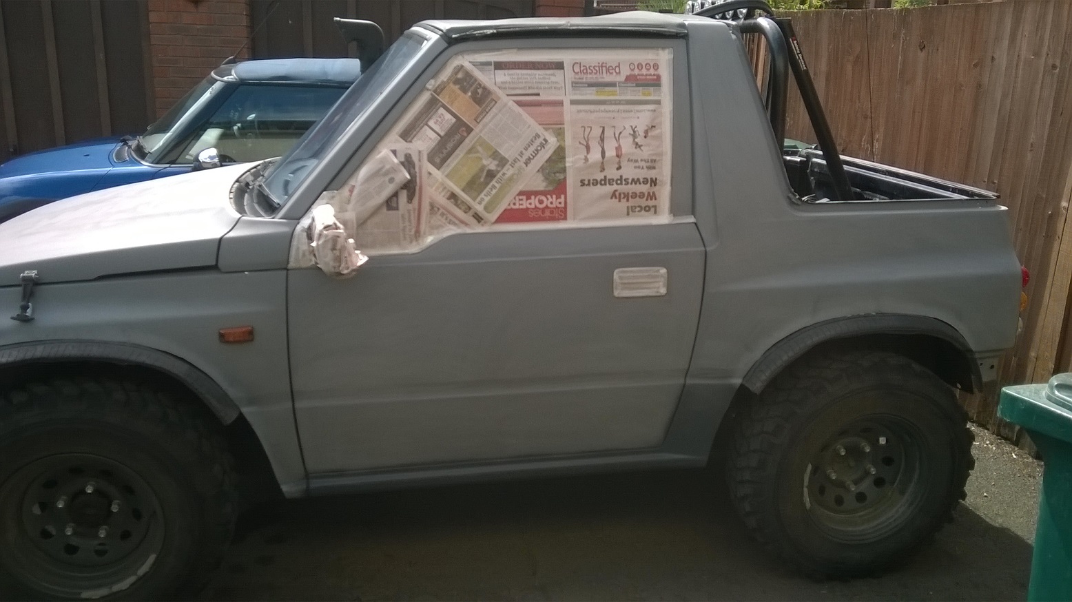

Post by donkeychomp » Sun Jul 26, 2015 12:24 am

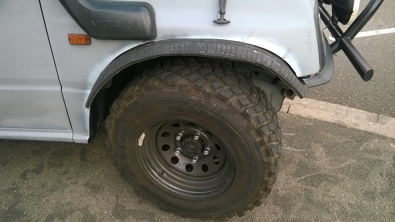

Finally got around to trimming the arches. Yokohama's are tough bastards but the angle grinder won.

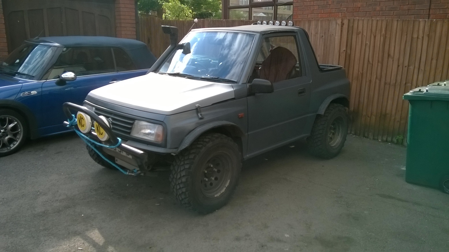

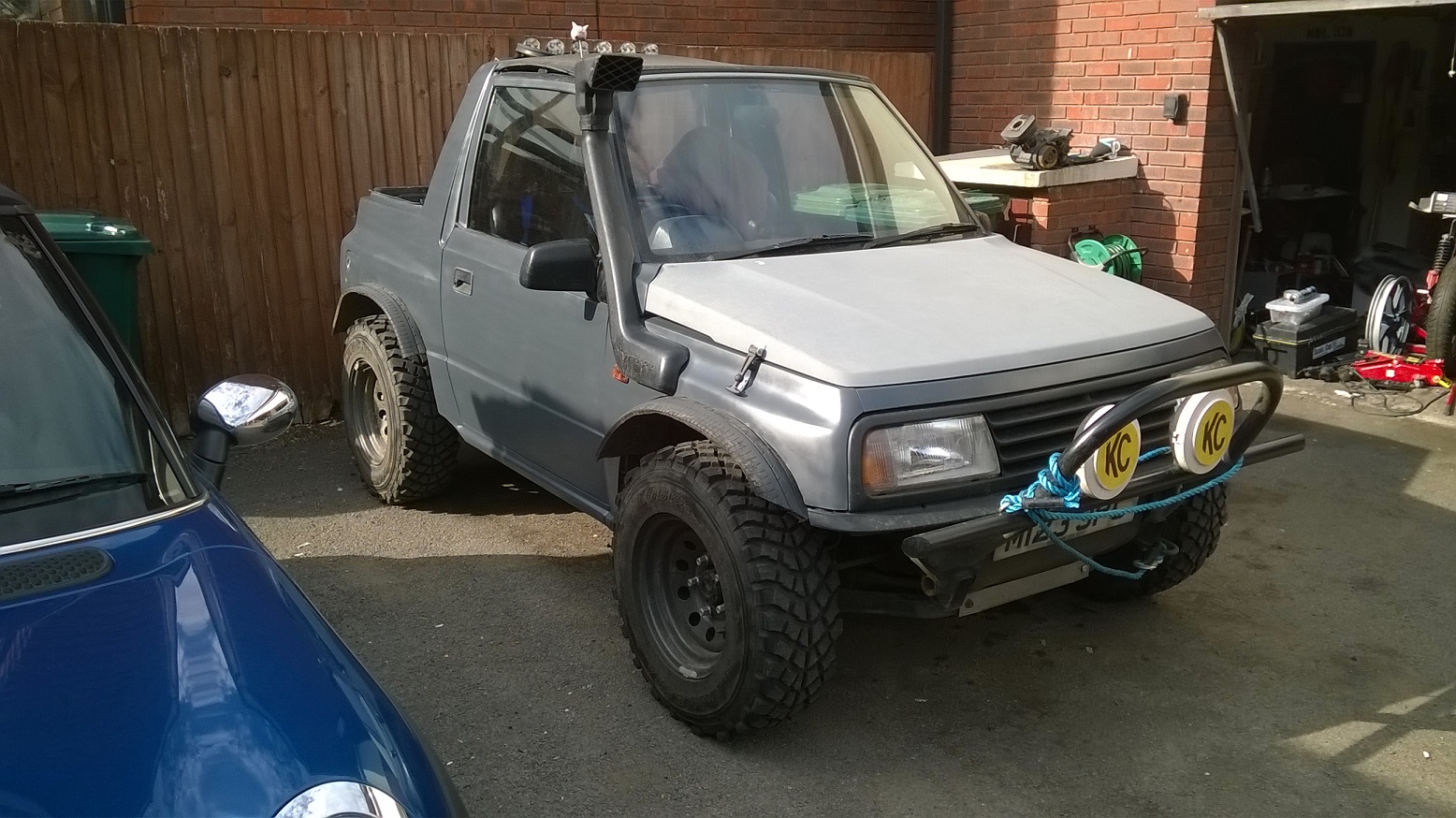

Post by donkeychomp » Sun Jul 26, 2015 9:29 pm

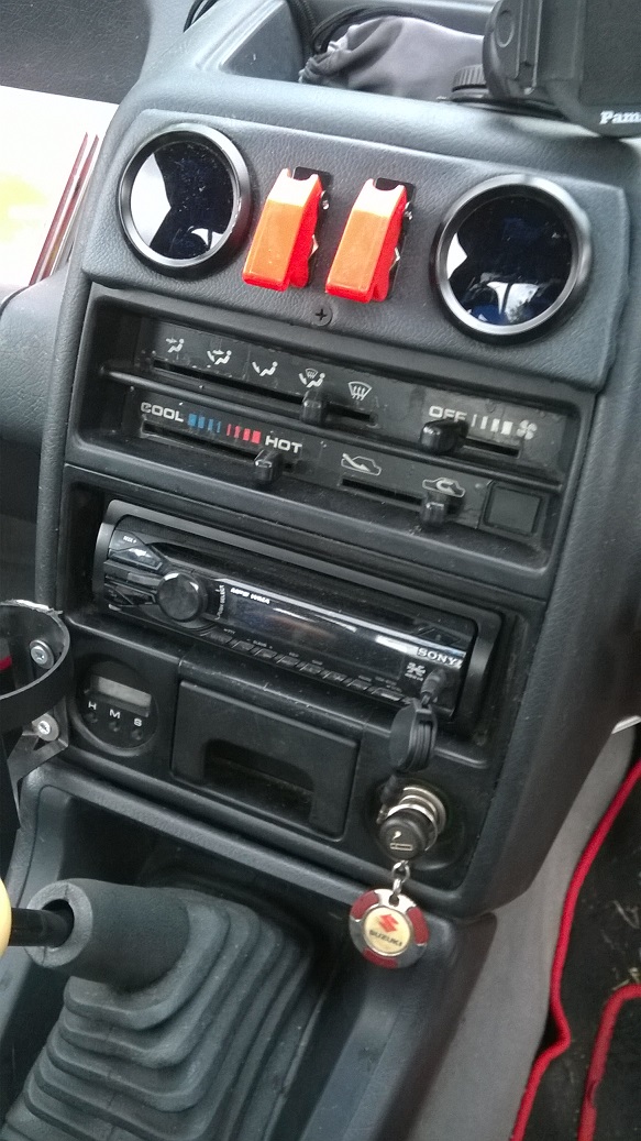

Cheers chaps. Nowhere near finished and I suppose it never will be, there's always something else to do or modify. New volt and oil pressure gauges are in with 2 switches for the extra lights. Next up another respray in battleship grey and another 2" lift. Wonder if 33" tyres are ok on a Vit?

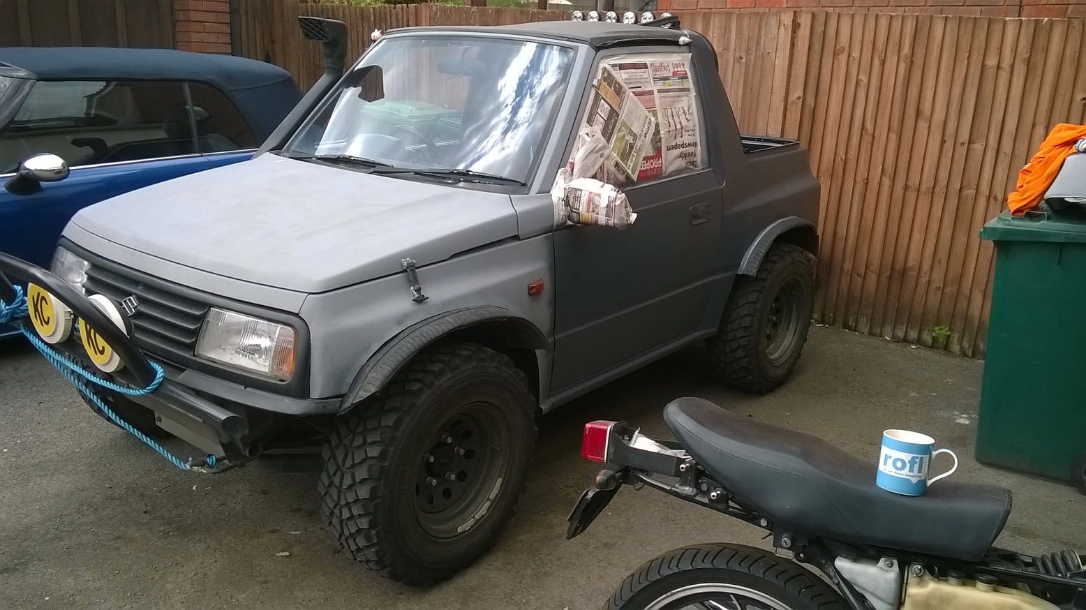

Post by donkeychomp » Tue Jul 28, 2015 9:26 pm

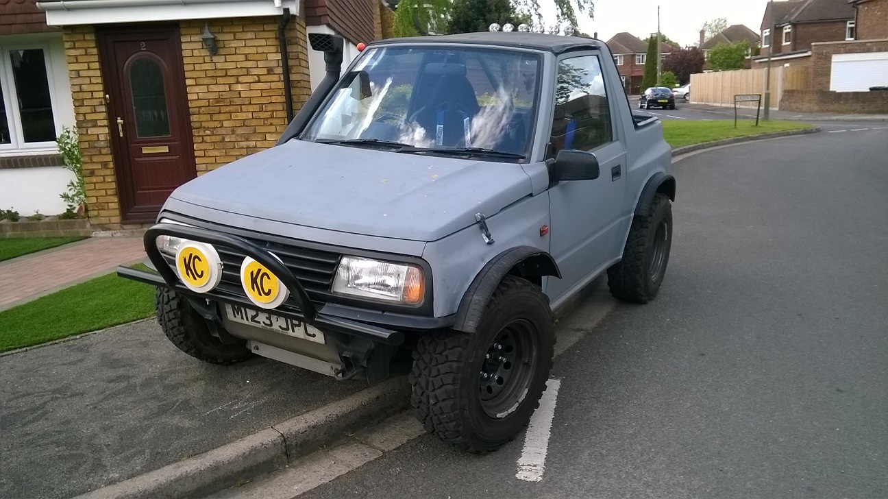

Painting today...the bonnet is going to be, err, different. The so called primer I have used is actually a satin colour. Handy as primer and a good colour I think.

Re: the no dosh Vitara revamp
Post by r-nottz » Wed Jul 29, 2015 6:01 pm
Looks good man!
Mines going that coulor funnily enough but I was going to roller mine, are you using aerosol cans?
